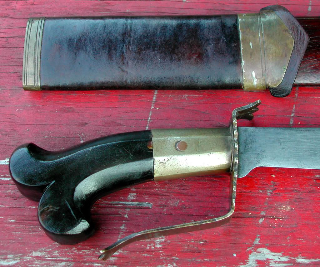

There are a lot of different Bolo handles, depending on which area of the Philippines it it made. Here are a few examples.
In the first pic, the two knobbed handles in the middle are from the Visayas. They are roughly octagonal in shape, with the bottom of the grip being narrower than the top. The horse hoof shaped handle on the bottom is probably from Luzon. I find both types very comfortable and secure in use.
If you're good at carving, you could do something like this Tenegre hilt. :)
This bifurcated hilt may be from Negros.
