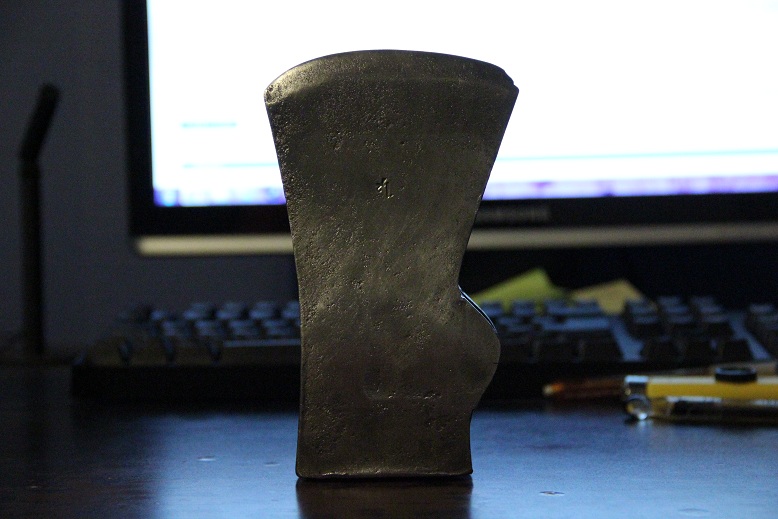

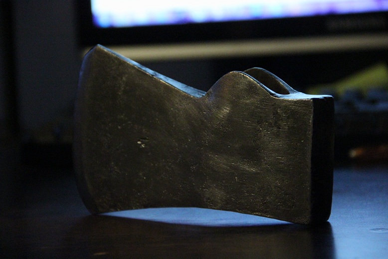

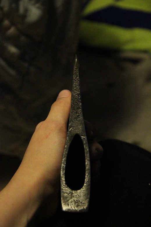

Thanks for all the help so far, I'm off to check on my axe head(it's been sizzling away in vinegar for the past hours.)
Current shape:
I'm hoping to hear back from my potential wood supplier sometime soon, getting hickory wood that isn't already a shaped shaft seems to be a tedious thing when living on the wrong continent.

If it was me with that axe head(which I like alot). I would just sharpen it up and go. I would also sharpen the broke part and as you use it and resharpen it will work out over time. Just resharpen with the proper geometry in mind.
You have been busy! Looks good. Make the front legs wider and you are good to go.
That is kind of my thought also, I want to get a-choppin'!
