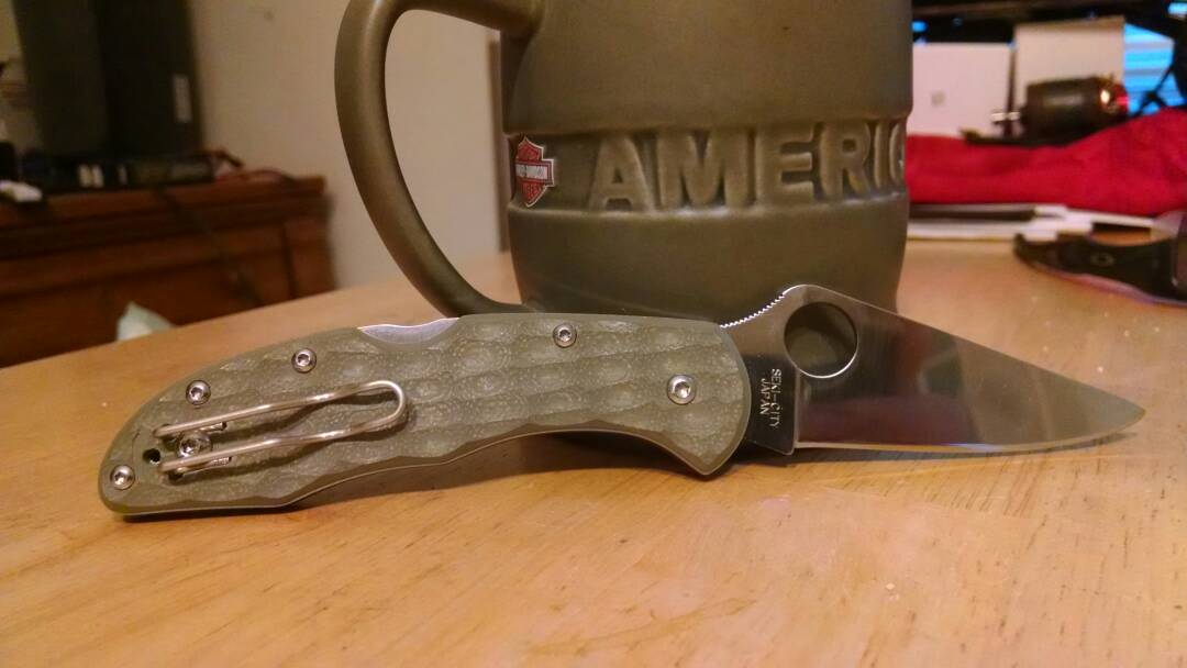

Keep in mind that, if you can't find your clip, you can order a new clip from Spyderco. I know it sucks to have to buy a new clip for you new knife but....
Yes, thanks. I'm not griping about the clip coming off, it's my fault for not checking the screws. Had it happen with another knife, therefore I know better.
Carried and used it every day since I got it.
Just a reminder for those that know, and heads up for those that don't.
To the other(s), I have no intention of getting anything for free. Whatever the cost, no biggie.
The wire clip was the only thing missing, screw still there, but was loose of course.

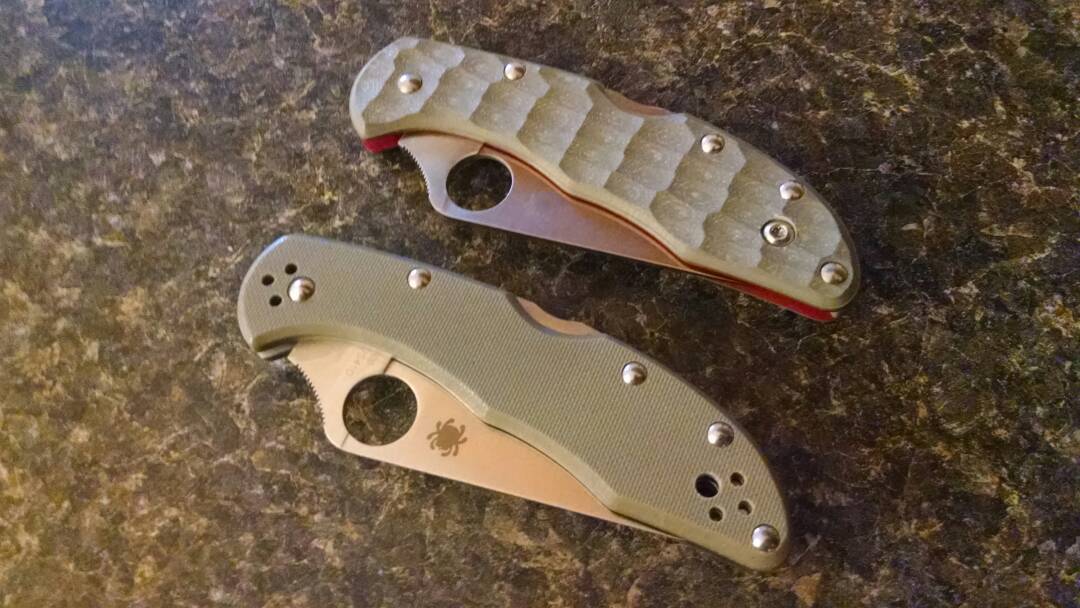

Blade swapped to a G10, wasn't satisfied, swapped back.
Without changing lock bars there was blade rock and lock bar sat below the liners in open/close positions. changing the lock bar produced solid lock up, but bar still below the liners. Both lock bars sat proud on the orange frn in open/close positions with vg10 blade installed.
I think the lock notch is cut deeper on the hap blade.
I could flush everything up with files and stones, maybe another time.
Also, the g10 spring is longer and stouter than the frn one.
jpm2.. I found the same thing with the Hap swap on the DF2.
But I'll deal with it.. It's only in, a hair.
I have other plans for the scales. Like a H1 serrated blade and a neck sheath, for fixed carry..
Anywho.. The Endura G10 sits closest to flush. Only stickying out enough that you can barely tell/see.
The G10 Delica sticks out a hair.
All 3 had to swap the lock bars with the blades.
