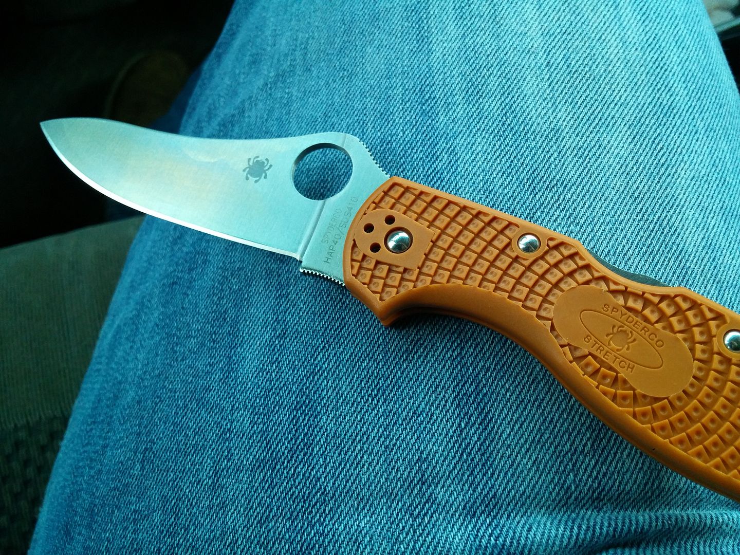

Lucked out at work and was able to head to the post office. Awesome...

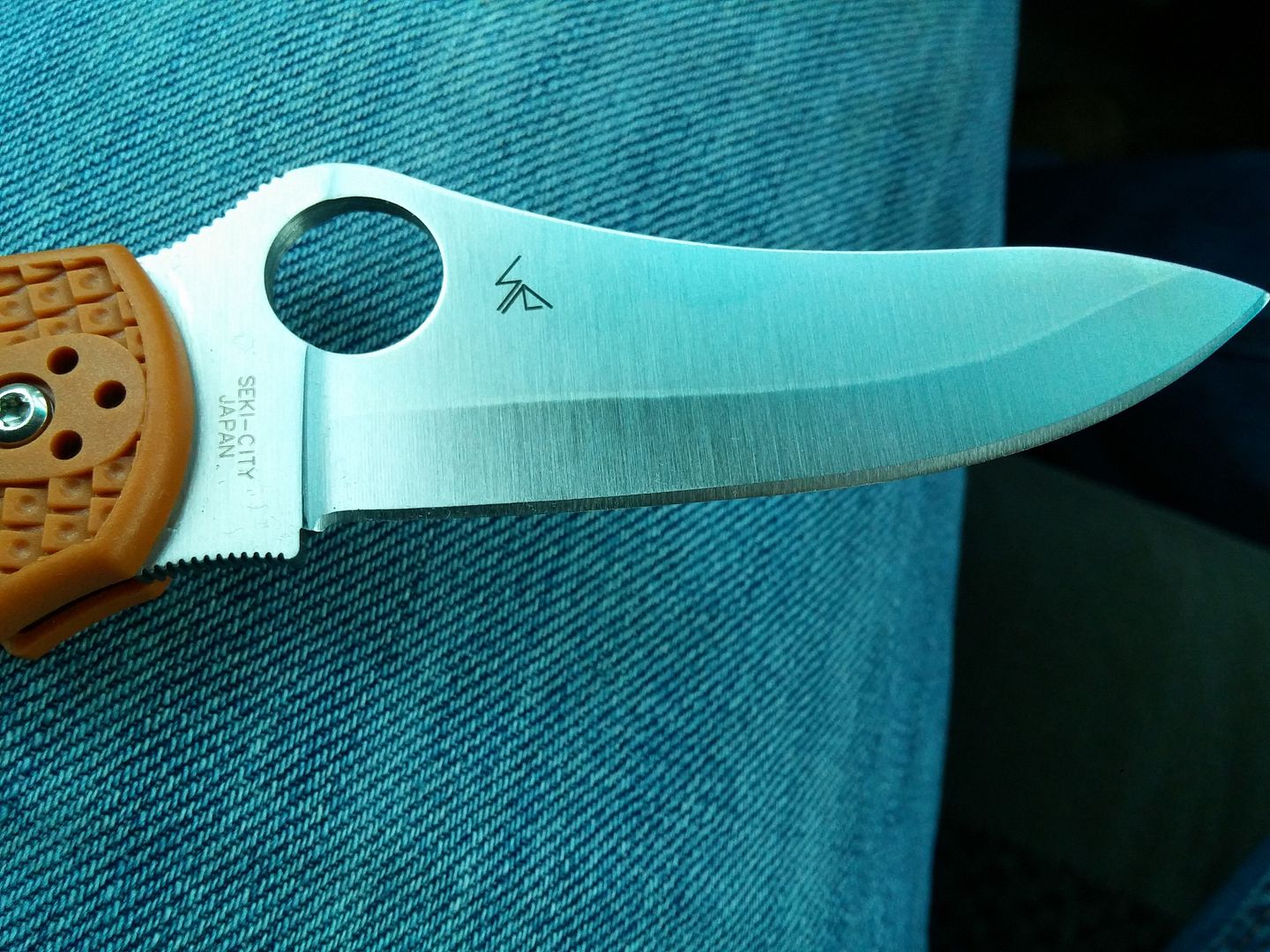

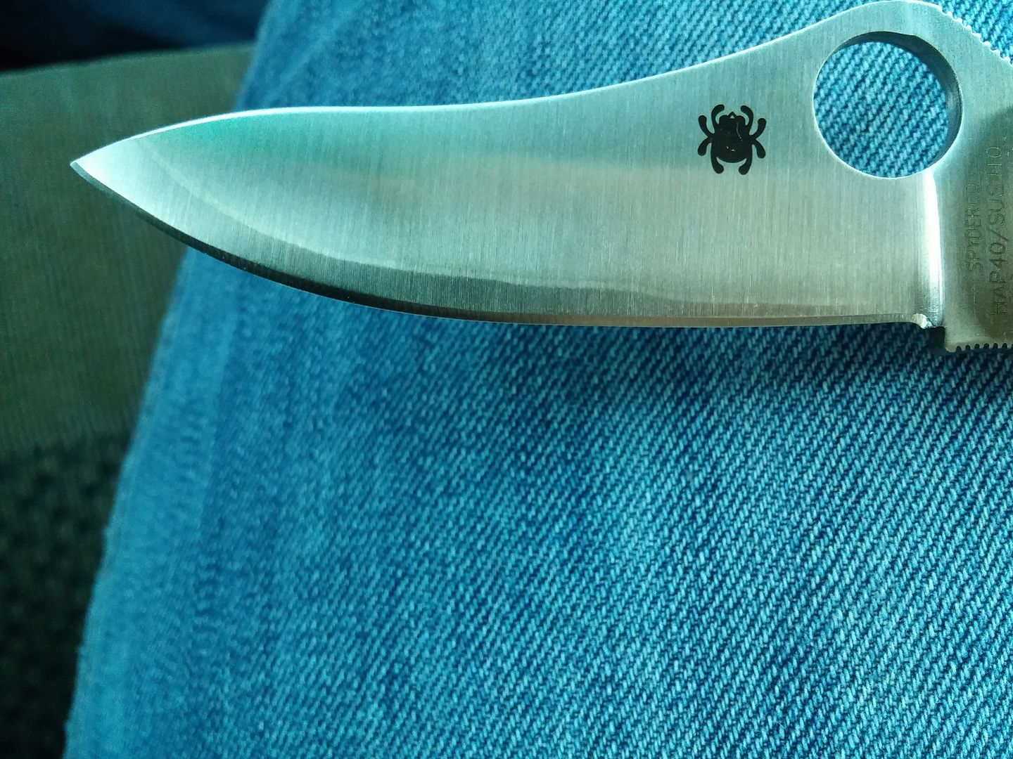

Superb laminate job on the rear side. I'm pretty ignorant to the cladding process, but looks like on the show side it's almost "running out" of HAP40 near the base. Would this mean after several sharpenings I'll be grinding into the SUS 410? Or one side of the edge will be HAP40 and the other side of the edge SUS 410? Would probably take awhile to get there though but just curious.

No. Remember the Hap40 is sandwiched between the 410. You could sharpen that knife all the way up to the spine and you would still be cutting with Hap40. Of course by then it would be so short it would be virtually unusable.

Oh ok thanks a lot for the info. I knew it was sandwiched, but had assumed incorrectly that the only usable HAP40 or Super Blue was that "below the line". What would be the reasoning then for not trying to take the laminate as close to the edge as possible? Or is it just part of the process and something that's hard to control?

To get the outer steel any closer to the edge, you would have to use a very thin piece of hap40. Then you would also risk the outer steel reaching all the way to the edge bevel which would mean always sharpening a mixture of hap40 and 410. It would work I suppose, but could create edge stability issues as the laminate is a much softer steel.
Disclaimer- These are just my speculations. ;)
I can't say for certain and I'm just speculating here. To give the blade any real strength they needed to have the Hap40 blade steel be a minimum thickness. Then the 410 is applied over that.
The wavering lines you are seeing could be due the variances between the Hap40 thickness, 410 thickness and the variances between how thick each blade is ground. Remember these are production knives so they aren't all going to be exactly the same. The differences are tiny.
They could also be made that way to make each one unique. Like snowflakes.
Great info, everyone. Always interested to learn more on these new processes. Really liking the ergos on the Stretch. I thought the Endura was too large, and the handle never really felt right to me, but the Stretch is just right. It also has a slightly heavier, quality feel to it.
I love the Delica big time, but this feels higher quality to me and like a real workhorse. Very smooth and probably the smoothest FRN Spyderco I've experienced. And Spyderco factory edges just put every other company's to shame. Great knife.
