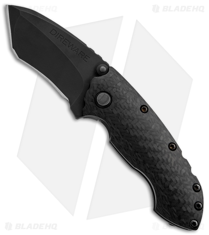

Let me clarify. Can the knife withstand hard use like occasional bushcrafting tasks or the like if needed. Could you baton if needed without worry? Could you chop if needed without worry? Could you pry softet material such as wood or flesh without worry?
What worry you ask? The worry that the pivot would break, the worry that the lock would fail, the worry that the bearings will spill all over the place.
Jesus guys these points arent indiscernible from the original statement/question. Im not sure why everyone simply skips everything and hones in on two words “direware” and “bushcraft”. Its quite frustrating how condescending some of you are.
Hello and welcome to bladeforums the knife could handle everything except batoning no folding knife is truly suited for using a baton. It applies force to the mating surfaces and can sheer the stop pin warp your lock bar etc.
But outside of that it can handle whatever you want. If you had to baton anything with a folder in a pinch make sure your lock is disengaged. Honestly though i would just carve a wooden wedge in that type of situation though.

Assuming that there is a fair level of craftsmanship in the specimen you purchase, chopping and batonning will cause some impingement of the lock interface. If "OCCASIONALLY" = once or twice, no real issue. If it equals, "when I think I want to when outdoors...", it will be an expensive journey. The Vox F3, at ~$100-150 is more financially suited, if the need is more than the once in a lifetime catastrophe.
The issue you're encountering is that any well-built machine can exceed "normal" standards on occasion. "Occasionally," may differ in your definition, from mine. Certainly, you can red line a Porsche 911, travelling from Oklahoma to California, a few times. If you travel to the local speedway, and do it 4-5 times per year, the wear and tear adds up. The question is one only you can answer: what is my definition of occasional and/or extreme? Hand in hand with that: is the cost of repair or replacement one I am willing to face without griping at the maker because my definition of hard-use is different than theirs?

Very good points here. By occasional it would be once or twice a year. And as another poster pointed out I would carve a wedge before batoning. Which is a perfect example of using the tool intelligently. But the fact stands youd have to carve the wedge after obtaining the suitable sized block of wood which could involve some prying or other tough tasks. Just making sure it could do it. Not that I will for sure without a doubt do it.
I think what everyone is trying to say is, don't buy the direware expecting it to perform meaningfully at bushcrafting. Of course it's your money, but the knife will suck at the tasks you want use it for.

No problem hang around and there really are some valuable info arpund here. I know when i first got into knives i wanted a folding knife that could do everything like pry open a manhole and still be able to slice through tomato so thin you could read the newspaper through it :-) i learned that what i wanted was a direct conflict of interest for each application.
Like if your doing really fine detail work in bushcrafting you would want a thinmer blade and if you wanted the strength to pry open a manhole /wood crate/ baton hardwood it needs to be thicker

Im interested in purchasing a Direware Solo. However, I do not want to spend the money on a piece of art only. I want my knife to be a tool first and a piece of art second. I have heard as we all have that these custom knives are “overbuilt”. Can these knives withstand hard use? I dont plan on abusing mine but I do plan on using it regularly with the occasional hard use outdoors buchcrafting and such. Can these knives withstand these tasks and are they any better than production knives from benchmade or ZT?
Do these knives actually merit the description of overbuilt or are they simply art pieces?
