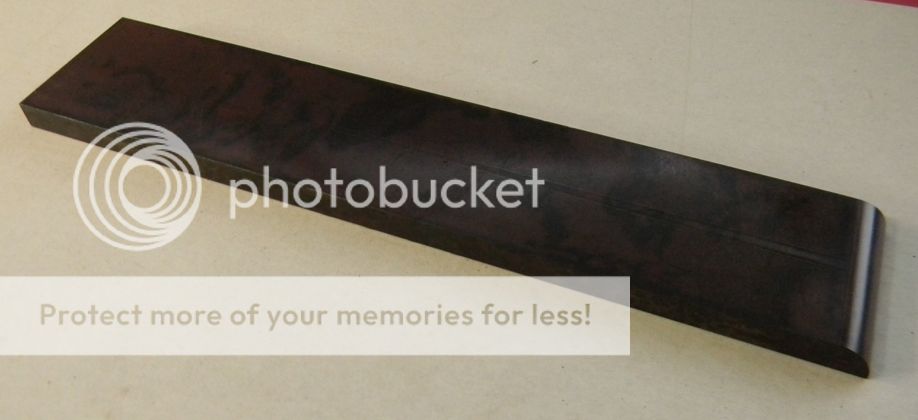

There are 4 extra long (10"), end radius, flat platens. These are 3/8" with a 3/8" radius on one end. The mounting holes are blind (CNC thread milled, full form to the bottom, square bottomed hole) to prevent a witness mark from showing in your work. These are $150 each SOLD OUT. This is an expensive consumable for a very specific grinding technique. If you're not sure you need one, you probably don't. Grinding with the top wheel removed can get hot, you will probably need a platen chiller. These will maintain their hardness up near 1,000F, but you can still burn your belt.

I think that grinding lengthwise along a platen is an under utilized technique.

I like finish grinding this way, I get smoother geometry with fewer flaws. If you sight down a blade ground the conventional way you can usually see flaws in the way light is reflected as you move the blade around. For me, ground lengthwise gets much closer to flawless and a more even scratch pattern.
You can call it good at that point or use it as a head start on hand sanding.

Grinding lengthwise generally involves removing the top roller from your platen attachment and draping the belt directly over the top of a shaped platen. I lean the platen back and run the grinder forward. Some people run it tip first and/or in reverse because there is less risk of slipping up and messing up your plunge but I learned to do it this way because I was concerned about catching the tip and getting hurt.
Running the belt directly over the platen generates a lot of heat. This increases your need to lift and dunk, and it gets hot enough to burn your belt. You need some way of cooling your platen. I suggest you make or buy a water cooled platen chiller.
The platen will wear. I only use it for finish grinding and I use it at low speed. There are some belts that build up sticky residue on the belt and platen that become loaded with grit and will eat up a platen. A damp belt can do this pretty bad. You should grind totally wet or totally dry to avoid problems and be on the look out for trouble.
Lengthwise grinding avoids the hot spots that bias the edges of a platen or wheel and allow a smoother more perfect geometry and the ability to have extremely clean plunges. In many cases it also eliminates the need to hand sand.
For the final finish pass I like to double up two belts so it has a bit of give. This will give you the smoothest most even finish. A clean 120 grit grind doesn't look rough and a clean 320 grit looks slick as hell.
