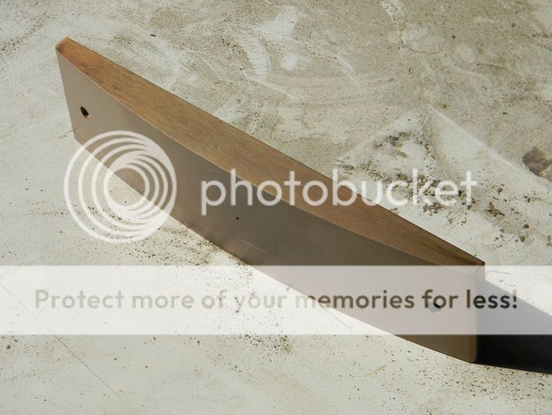

36", 48", 72" curved platens, flat platens and water cooled aluminum chillers. The end of the flat platens have an accurately machined radius that can be used for lengthwise grinding and finishing plunges. There are now two styles of the flat platen available. The original style with 1/8" radius on one end and 1/4" radius on the other, and a new large radius option with 3/8" and 1/2" end radius.
You don't have to use the end radius to make use of these flat platens. The original idea was just a hardened flat platen. While it was on the CNC I cut an end radius, it's no big deal. Some folks use this to grind lengthwise to clean up flat grinds prior to hand sanding and to refine their plunges.
These are all machined of A2 steel and hardened to HRC 61-64. It is 1/16" shy of 8" to fit between the rollers, 2" wide and has the KMG 1/4-20 6.75" center to center mounting pattern.
Radius is $110, flat is $90, the chillers are $60. Flat rate shipping in the USA is $5.

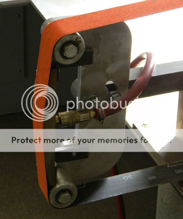

If you look closely, you'll see a tiny hole in the surface of all of the platens. On the opposite side of the hole I have cut a 1/4" NPT pipe thread (a regular taper pipe thread) which you can (if you want) use to pressurize your platen with air.
One of the problems of grinding on a radius platen is heat, and the addition of air between the belt and the platen both reduces friction and cools both of them. It is possible to grind with high belt tension and a large contact area at your highest speed for hours at a time without excessive heat buildup. This only works well with a stiff belt. Once you get into something like a j flex you will find the air cushion rounds the leading and trailing edge a bit. At this point you will want to move away from the air zone or reduce air pressure. I get best results with the air pressure between 5 and 50 PSI.
You don't have to use air to use these platens. I don't, I use a chiller. The air port is a feature I have added by request.

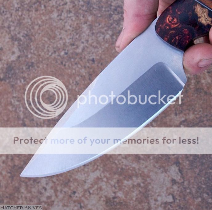

I think that grinding lengthwise along a platen is an under utilized technique.
81_zps4b566cf4.jpg~original
I like finish grinding this way, I get smoother geometry with fewer flaws. If you sight down a blade ground the conventional way you can usually see flaws in the way light is reflected as you move the blade around. For me, ground lengthwise gets much closer to flawless and a more even scratch pattern.
You can call it good at that point or use it as a head start on hand sanding.

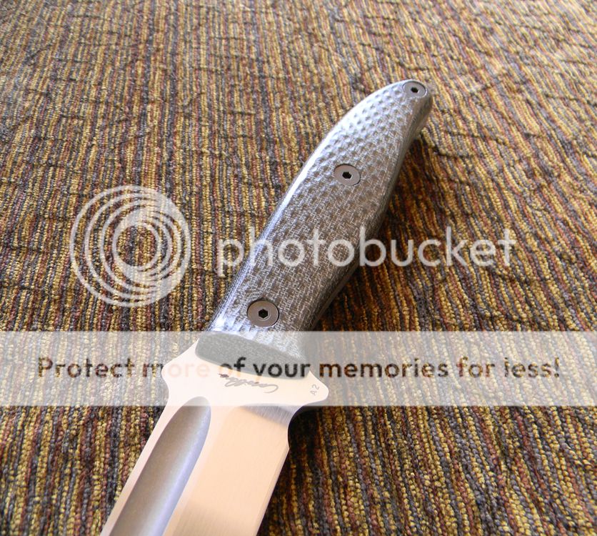

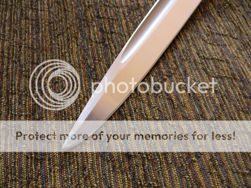

These are pictures I took for a recent knife sale (hence the knife porn shots) that illustrate a lengthwise grind.
This is just a "field grade" 120 grit finish folks, you can go way higher.

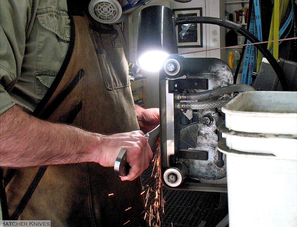

Grinding lengthwise generally involves removing the top roller from your platen attachment and draping the belt directly over the top of a shaped platen. I lean the platen back and run the grinder forward. Some people run it tip first and/or in reverse because there is less risk of slipping up and messing up your plunge but I learned to do it this way because I was concerned about catching the tip and getting hurt.
Running the belt directly over the platen generates a lot of heat. This increases your need to lift and dunk, and it gets hot enough to burn your belt. You need some way of cooling your platen. I suggest you make or buy a water cooled platen chiller.
The platen will wear. I only use it for finish grinding and I use it at low speed. There are some belts that build up sticky residue on the belt and platen that become loaded with grit and will eat up a platen. A damp belt can do this pretty bad. You should grind totally wet or totally dry to avoid problems and be on the look out for trouble.
Lengthwise grinding avoids the hot spots that bias the edges of a platen or wheel and allow a smoother more perfect geometry and the ability to have extremely clean plunges. In many cases it also eliminates the need to hand sand.
For the final finish pass I like to double up two belts so it has a bit of give. This will give you the smoothest most even finish. A clean 120 grit grind doesn't look rough and a clean 320 grit looks slick as hell.
I like the yellow Klingspor 312 J flex belts. Other belts I've tried tend to gouge and gall when a bit of grit pulls free. It goes without saying, use fresh belts.
In order to run two belts at the same time you're going to need to stretch a belt. Take a new belt and put it on the grinder under high tension and run it and get it soaking wet. Once it runs a little while it will stretch so you'll need to stop and pull your attachment out and run the tension up again. At this point it is stretched. You'll want to go ahead and rub the grit off the belt splice at this point to prevent splice bump from showing up in your finish. I use an old file. You can then take another belt like it that hasn't been stretched to run inside of it and they'll run together that way.
Like any new grinding technique there is a learning curve with lengthwise grinding, particularity if you're grinding like I do with the grinder running forward and tip down, standing to the side so you don't stand in line with a potential launch. You're probably going to slip and ruin a plunge before you get a feel for it.
You want to present the blade to the belt slightly edge first and out towards the belly. Roll it in, then roll it up. The mechanics are similar to regular grinding as you angle the blade out as you approach the tip. You'll want to stay away from the round over on the platen unless you're grinding your plunge. When you do grind your plunge you'll want a firm grip on things and press it in deliberately. Then roll the blade out towards the tip in one smooth deliberate motion hitting the entire length of the blade for an even finish.
