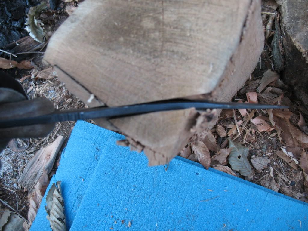

Some how the tip of my bk 9 got bent alittle doing some wood splitting battoning. Not sure what I did.
I was able to bend it back straight again
Looking at it, that swedge makes the very tip very thin. I wish it didnt have the swedge cut
Im going to have to be careful with the tip of this thing

Pictures are after I bent it back. About the size of a finger tip or thumb tip, was bent. It was Just bent a little, maybe 10 degree or so.
I bent it back immediately after it got bent, so no bent pics.

Was bent to the left (below), now its pretty straight again
You can see the paint at the tip kinda chipped off at the high point from working the bend out
I am certainly no expert but if the tip bent and you were able to bend it back, it almost sounds like it isn't tempered properly... The 9 is a stout blade, even at the tip despite the swedge, I would be hard pressed to get it to bend. I would think it would break before bending, which makes me wonder about the heat treat...

If properly heat treated, it should have gone back by itself, but, that being said, I have an Old Hickory Cleaver that i bent pretty badly chopping a stick. I was able to pound it back with no breakage & am still using it to this day------except only in the kitchen now.

Did that spring back its self when pulled out of the log, or did it stay bent and you had to physically bend it back?

Any basic carbon steel with a good heat treat will bend like that and come right back to true. If you bent the tip and it stayed that way, then surely it's a heat treat issue. You can run a file down the edge of your spine and see if it skates off of it...

Bent back as soon as it was out.

You guys making me think I have a dud. Maybe I should have left it bent, but in the shock of the moment I tried to bend it back right away. Didnt even think to take a picture or that it had a heat treat problem.

Considering how much wear your 9 has, I seriously doubt it has a bad heat treat considering how noticeable those usually are, and considering your comments about it holding an edge well I don't see any reason to assume it's heat-treat related. That being said, not sure what else would cause a bent tip, but since it looks like you got it back to true just make sure to never do whatever you did to cause it to bend again.
Like KingMC KingMC said above, considering the amount of use you have subjected that blade to, a bad heat treat would have manifested itself a lot earlier I would think. Still gives one cause to wonder though...
