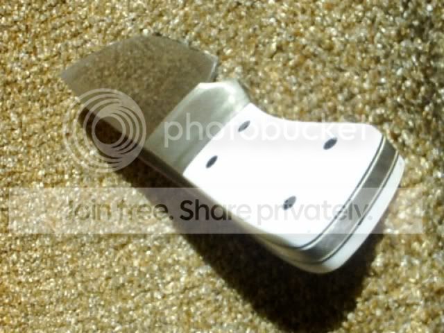

Has anyone ever used corion as a handle material?
Apr 1, 2007
10,080
I ran out of neoprene on my last knife and had made 2 more since. It was eating at me to get a handle on this one so I could see what it looks like with a handle. Yesterday I couldnt take it anymore so I cut out some corion and proceded to put it on. At first I wasnt sure that it was going to look good but once I polished it up I was suprised how good it actually looked. Last night I showed it to a friend who liked it just as well as the antler handle knives i make. Corion is a plastic countertop material that is pretty durable but it is also brittle. You can get it in all kinds of colors and patterns. It works fairly easy but clogs a belt so clean it often. I found out that a piece of scrap neoprene works pretty good for doing this. Here is a link to the picture of that knife. http://mysite.verizon.net/reswhz6f/id4.html.

Tonight I was out at a friends house and his wife was cutting up (sawing really, lol) chicken with some kind of serrated knife from pampered chef. I was showing both of them that knife and watching her at the same time. I couldnt watch her shred that poor chicken so i handed her the knife. she pushed the blade through the meat with no problem but when i washed the blade, it turned brown a little. While cleaning up the blade tonight one side of the handle fell off but I had my doubts about that side after putting it on. I agree on it being slippery and since that side fell off, I think rubber will be better for this knife.
I would always suggest some sort of mechanical bond along with epoxy to hold the handle on. I normally use pins, but some people use corby bolts, rivots, etc. I had to take a handle off a knife one time because it had a hairline crack that I didnt see originally. It took me about 20 minutes with a hammer and chisel to get the handle off and around the pins. Eventually all glue will fail and you will need the other bond.

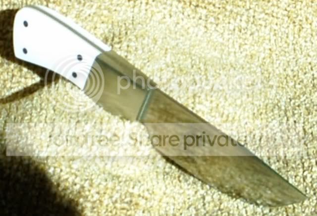

A kit knife that I finished:
