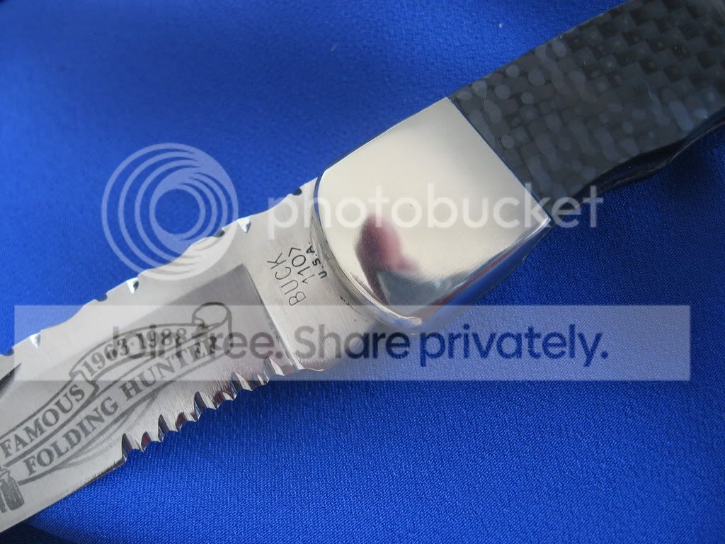

Use your dremel and a carbide burr.I make serrations that i think look as good for next to nothing and its fast.Practice on an old blade and youll be surprised what you can do.They will really rip too.I would throw up some pics,but i dumped a cup of ice water in my keyboard(laptop) the other day.I still have hope but its fading.Heres one buried deep in photobucket
