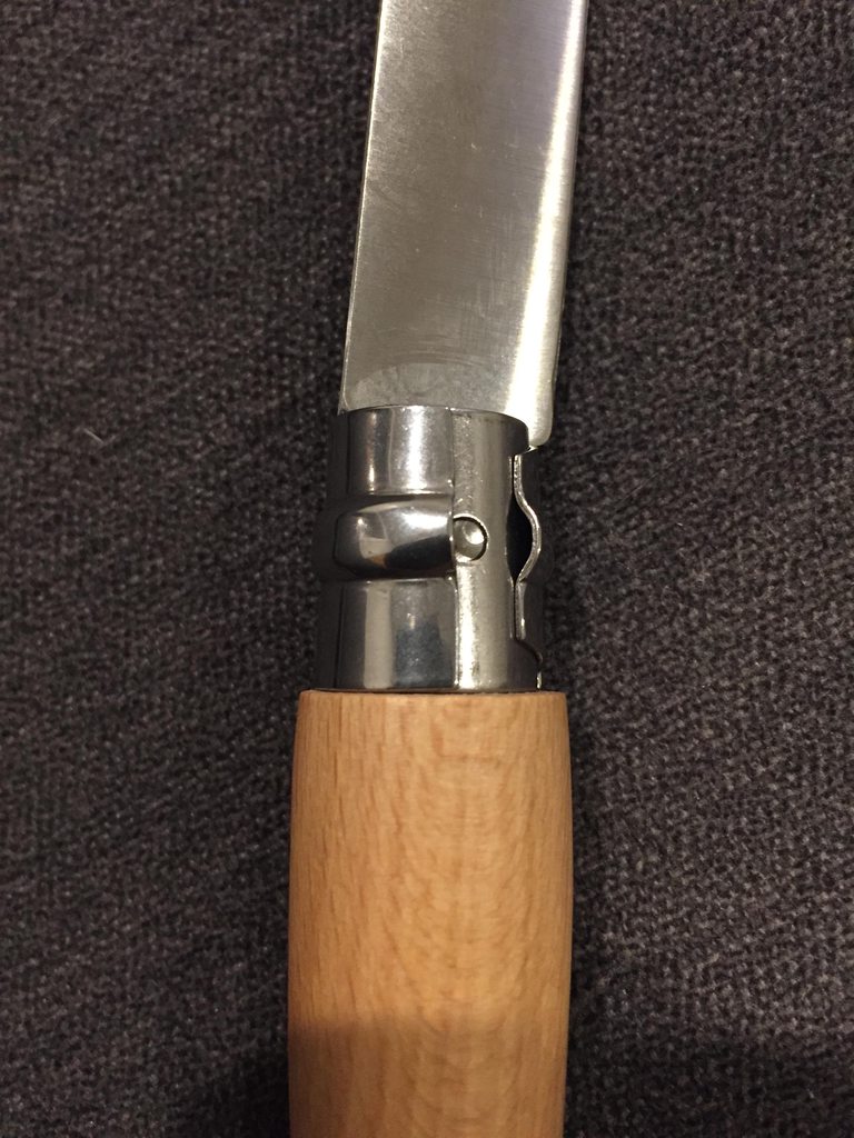

I have a relatively new No. 7 that I put away in a drawer when I received it and hasn't seen any use yet. I just checked it and, sure enough, it has the new feature. But, try as I might, I wasn't able to get it to close when locked.
Looking closely, I think the indentation may be a little smaller than the one shown in the video, allowing it to turn further. With the collar in the locked position, I can see nearly all of the pivot pin:
It's hard to say from the video, but it doesn't look like his is able to turn as far. I wonder if they have either changed the design slightly or have inconsistent manufacturing.

Yes, Opinel has messed this up. I have two. The first, a #7, I didn't know it had changed. The ring was rattling loose and did not lock in the closed or the open position. I filed it down a bit as usual but the nub limited the ring and it would not move to the new filed position either. When I filed the nub off the pin is not quite as long as normal and the ring was not stable. It is friction only now and I don't find that satisfactory for a laser cutter.
Then I got a slim #8 in olive, the most slicey blade ever, much more slicey than a regular #8. I use it for serious food prep only while backpacking (with a normal #8 for the tough stuff). Well it has that same new feature and again, that ring was loose and did not lock in the closed position or in the open either. I adjusted this one very carefully, tightened it to perfection and filed gently this time up top and carefully ramped the locked position over a bit. Now it locks up very tight and it locked closed securely too. But you have to be very careful or you run out of limits.
I really value this knife but I am baffled at why they turned out such a poor quality controlled version of the viroblock. Mine works like a swiss watch now but it was just horrible on receiving it.

For those who have the new version, what do you think we need to do to make it work properly? Should you file the nub off, make the slot longer?
By looking at it, I think I would file the nub off, and then also file the top of the ring on the opposite side, so I could lock it the other way also - like I usually do. But then swiftdream above suggests that the pivot pin in now shorter so it's not stable?

Hmmm, looking at that pivot pin has me thinking. That one is shorter with less peening than I'm used to. Seems the same on other pics of new design knives.
The peening on Opinel pivot pins riding in the groove formed in the locking collar is what stops the collar from riding up and down when locking open and closed. I wonder if this new feature is to stop the collar from riding up and down so that the peening does not have to be perfect. Maybe it's for ease of manufacture.

You are right on all of that. The pin you see in my top image is the best side too. The other side hardly protrudes at all. What happened when I filed off the nub is the collar now lifts when I lock the blade closed. It is not stable and secure like the older models. If I very carefully close it with just enough pressure to contact the tang and secure it, then it might work okay but too much pressure lifts that ring right up.
Now when locking it open, the collar is forced downward so it works okay but still not perfect.
I think we need to be very careful when filing down the collar so the nub/slot does not run out of range. That worked well on my slim #8 but I had to be aware and very careful, going slow until I got the desired result. Even so my guess is that collar is close to the limits so there is not much leeway. It is best to keep the nub with this design.
