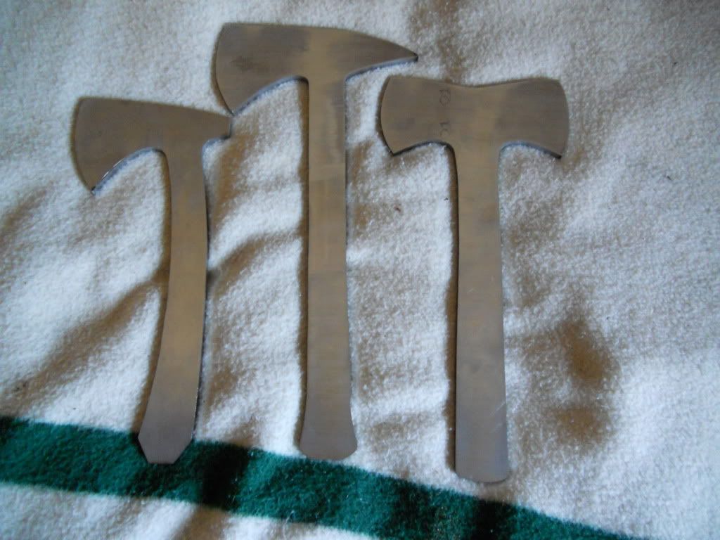

Profiled these this morning. From left to right, Urban Hawk, large Spike Hawk, and Nessmuk Hatchet.
Here are the specs:
Standard Spike Hawk: 14" overall, 3 1/4" edge, 6" head, 1/4" thick O1
Nessmuk Hatchet: 13" overall, 3 " edge, 6" head, 1/4" thick O1
Urban Hawk: 11 1/2" overall, 3 1/2" edge, 5" head, 1/4" thick O1

With a little luck it should be done mid next week. Tomorrow I`ll be grinding bevels, and drilling about a million holes in the handle area. Friday we have to go have some tests done, and Saturday I`ll be heat treating them.

In my mind it has squarish black micarta with stainless corby bolts....

I'm really looking forward to the urban hawk. Have you considered a spike on the back and a prybar at the bottom? I have an ontario rd pick hawk, and I like the pick far more than I thought i would for moving wood around. I'd be interested in your spike hawk, but I want something differently shaped than the Ontario. Or at least the prybar bottom if you're definitely keeping the chisel tip back?
