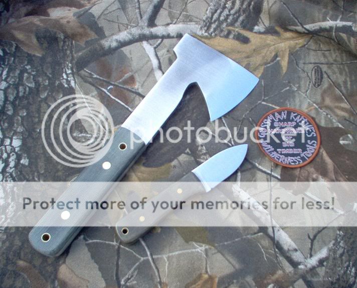

This is for the hatchet users out there. What are your feelings about full tang hatchets? I'm not really a hatchet kind of guy but since making and using one, it is really growing on me. I own some of the others, Wetterlings, Estwing and my old Boy Scout Plumb but always preferred a large blade over a hatchet. One thing I've found with the full tang is overall balance is better plus it can be batoned easier if that would become an option. It also seems to split better because of the thinner head. As far as being too heavy, this was a concern for me but it is actually only 5 or 6 oz. heavier then my Wetterlings.
I really like JK's version and I think G.L. Drew makes one also. This is my version, the Gosshawk. I'm not sure if these will become a sought after item, but they are fun to work on and use. It's 5/16" thick A2 steel.

That looks real nice :thumbup: Ever since I got an old style Buck hatchet years ago I`ve been a fan.

Real Nice Work on the Hatchet, Sure Is a Beauty ! The one GL Drew make's Is shorter and has an ULU Skinner type Head Short & compact made for Skinning & Cutting Meat & Bone, Thank's for sharing the picture,
Nice looking hatchet Scott, I love them full tang hatchets and use the one I made quite. For a light weight hatchet I think they are to cool LOL.

Thanks for the imput guys. I think there are advantages/disadvantages to both types. I guess these full tang hatchets are like most other equipment, some will like them others won't.

Out of curiosity I just went out and did a side by side comparison of vibration between this one and a wood handle hatchet. I didn't feel any noticable difference as far as vibration.

When I tested mine against my Wetterlings and Fiskar, I did not notice any vibration.

Bryan, your hatchet looks great too. I hope to put mine to use this fall as a skinner.
