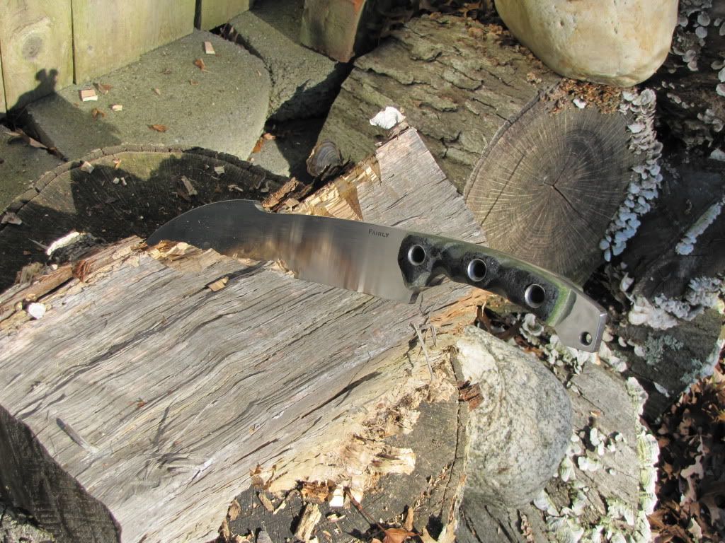

I wasn't able to get a video made, but I tried and just couldn't get the action and camera control right. I guess I need a tripod or something. I did however, split some more wood and the Havok did the job admirably. I came across a piece of oak that was so hard and dry that when cut cross-grain, the CS Magnum Khukri and wood-splitting axe that I had just bounced off it and couldn't even bite deep enough to notch it. The Havok chopped big chunks out of it, and it was there that I saw what a big difference the chisel-grind edge geometry made. It didn't bite and hold though, but clanked off the log and big wood chips were flying. The axe and khukri, nogo. I think I'll test edges with wood like this from now on.
A quick wipe and it still sliced paper effortlessly throughout the length of the edge. I was giggling inside :)
Didn't bother cleaning it up too much and took more pics since the sun was bright out.

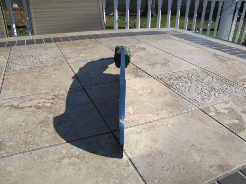

I like this pic that shows how thick the steel is, and the shadow hints at the blade shape.

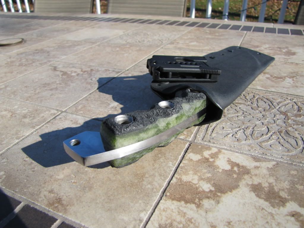

I also tweaked the sheath a bit with a heat gun. Draws in and out easier now after the pop.

The khukri also slices paper and is convexed. It's very good for machete-type duties like clearing brush and de-limbing thinner branches, but there isn't as much weight behind it and since it's so thin, doesn't baton as well. The axe is also pretty sharp and convexed but it's very thick. There's also a lot less control. The chopper definitely makes better cuts than either one.
A very well thought-out grind (chisel) backed by a super tough steel (S7). I wonder how a hollow ground would be?
Does it have a 2ndary bevel?
Also does the harpoon tip serve as a wound expander?
With the ginunting-esque profile and the weight, i'm afraid nothing left but cold air swivels around the edge upon swinging.
it's a convexed chisel grind, which is great for sharpening on paper wheels. I'll just run it through the stropping wheel when it loses that razor edge and it'll be good to go. When I was hacking at that dried oak, I noticed that the horse-stall mat really absorbs a lot of shock and very little gets transmitted through to my hand. The stall mat is softer than the khukri's handle material, but the krypto's hardness balances it all out by keeping the grip substantial.

Thanks for posting up the awesome photos and review, the signature photo is just killer! The pic with the shadow is just too cool, really nice stuff!
