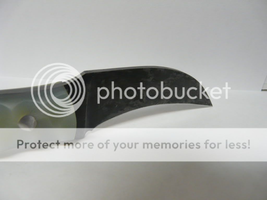

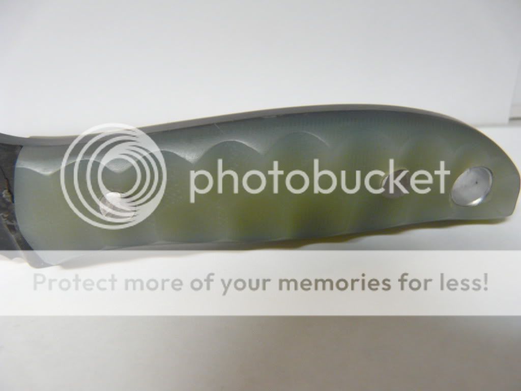

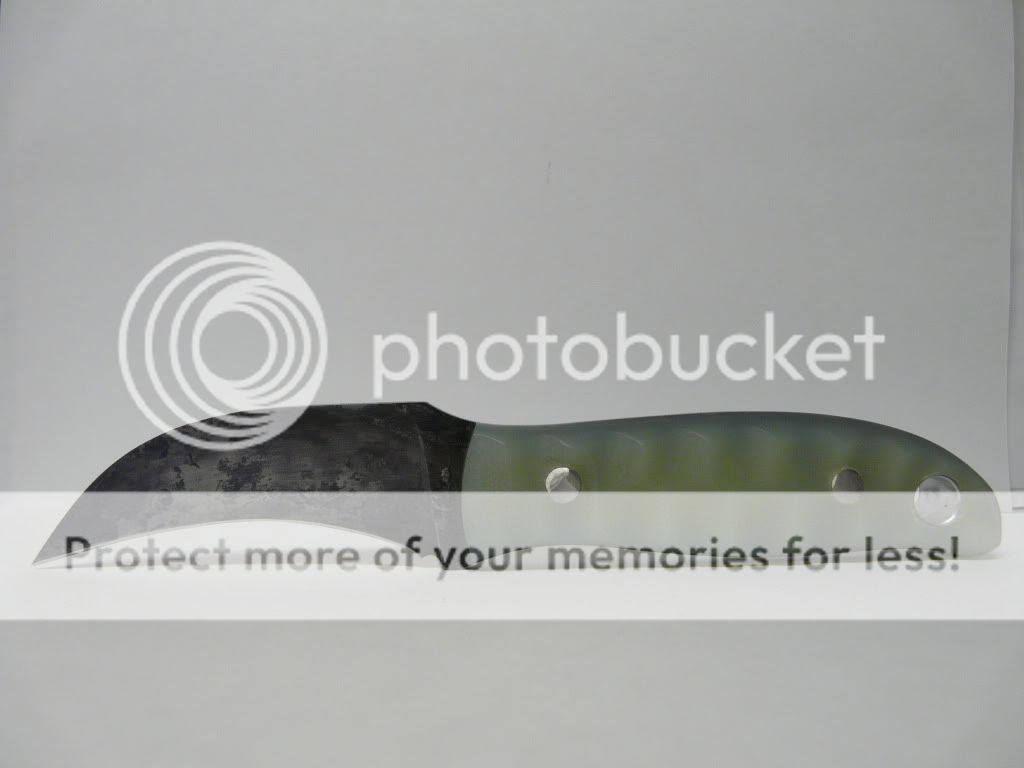

This knife would do well as a utility or defensive tool. Tip is needle sharp. The antique finish is cold blueing with bleach. It is hard to see the details in the photos. I think the finish is beautiful as well as durable.
$110 without sheath shipped to your door.
Full Tang
Handle- 4.05"
Blade- 3.17" measured from front of scale, edge 2.85" 1/8" stock
Hawkbill, Free Hand ground, full flat grind spine to edge.
Handle material- Random chisel textured jade green G10, chamfered edges , G-Flex epoxy with 1/4" Stainless pins and 3/8" aluminum lanyard tube.
blade Steel Aldos 1084 Carbon steel edge quenched
Blade Finish is belt finish then antiqued
Edge is V- grind on cardboard wheel system
Heat Treat in House, canola quench, 2 2HR temper cycles at 400F
