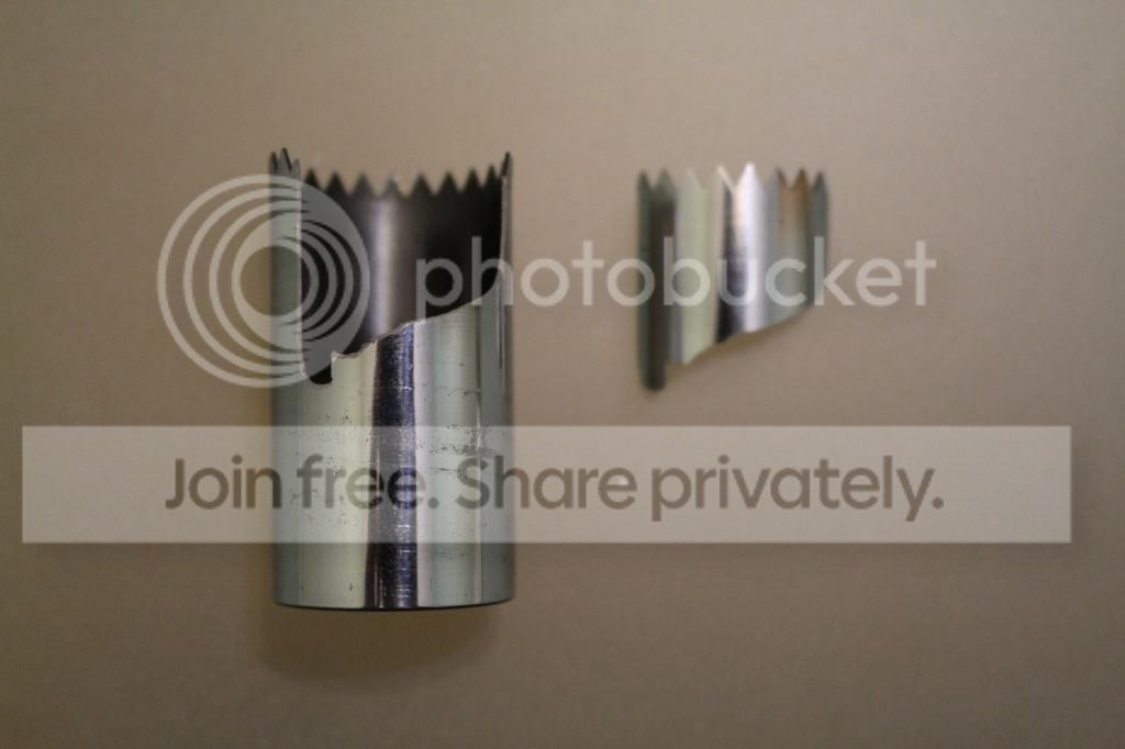

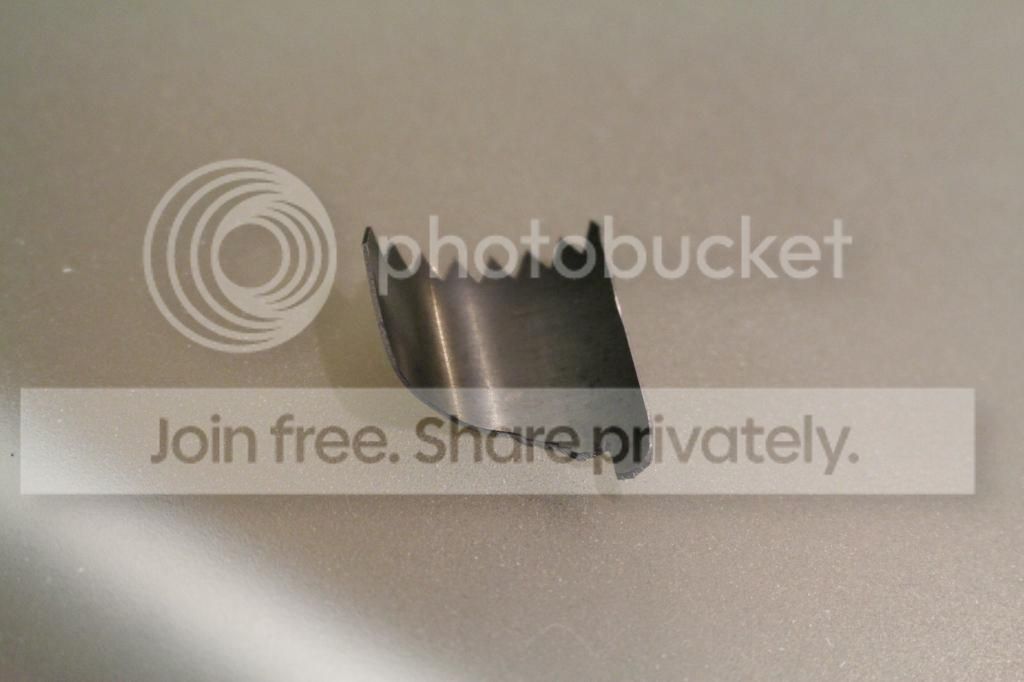

Hello, I know this isn't exactly knife related, but is very similar. I’m an industrial engineering undergrad who is making my own stainless 440C hole saws from 1 inch OD round bar. Using a lathe, I drilled, reamed, and finally used a boring bar to get the wall thickness to 0.021” (I know, it’s very thin). I then used a mill and a v-cutter to machine the teeth. Next, I heat treatment the hole saw to get a martensitic structure. I heat treated at 1038 degrees Celsius for 30 minutes, removed and air quenched, and finally temper for 1 hour at 230 degrees Celsius.
This hole saw was designed to be attached to a T-handle, to manually cut hardwood up to a ¼ inch thick. It cannot rust, and must have high hardness and toughness, which is why I chose 440C. This hole saw worked well for a year. I recently let a friend try it and it broke (see attached pictures). My friend used way more downward force than me when it broke. I feel that my hole saw has way too much hardness (no wear on teeth) but not enough toughness, almost like glass.
Can someone please advise on how to preventing my hole saws from shattering? Many of my engineering professors are baffled. Thank you, and Happy New Years.

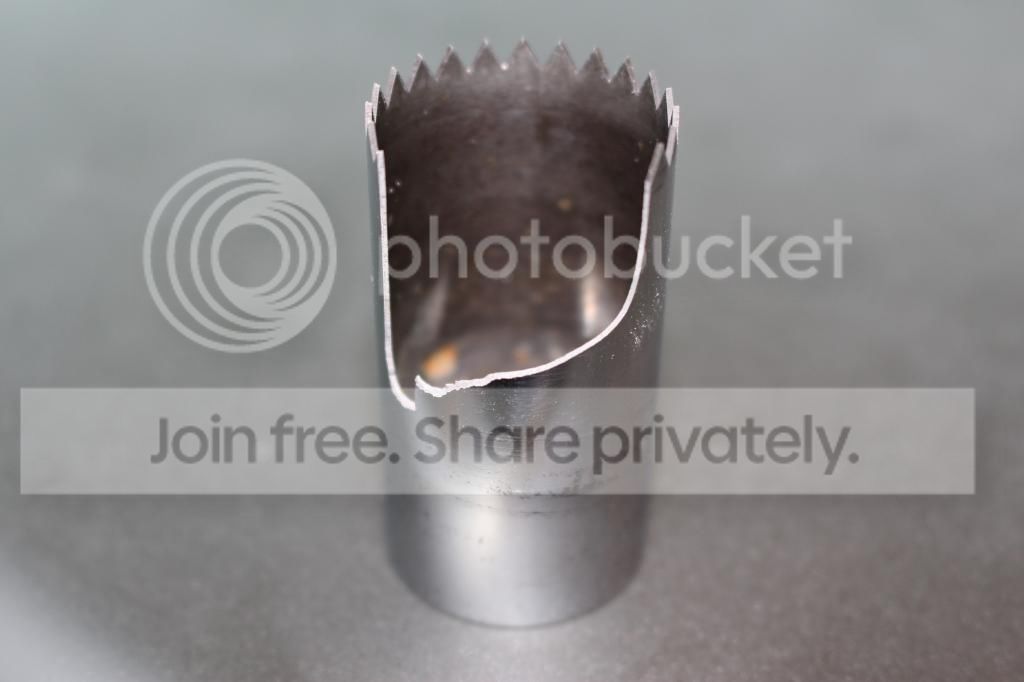

Final ID and OD dimensions ? All HT details ? What was the condition of the original bar ? decarb, surface defects .I'd like to have that here to check fracture surface. Was the tool in a drill press ? .021" is thin enough flex that cutter .

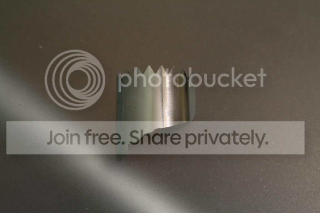

Very important is the bottom of the tooth where it broke .

I tried testing the Rockwell C hardness at my university, but hole saw acted like a spring, and gave a really high number which was defiantly inaccurate. I did not have a flat/solid piece to test with.
I was told to temper at 400 – 500 degrees C, to increase toughness. I’m not sure if this is an accurate temperature for such a thin wall.

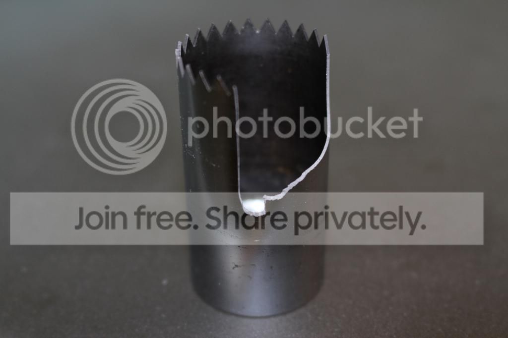

I also noticed the break starting at the V-notches. I did not intend to use the v-notches to avoid a stress riser. The 60 degree teeth profiles worked best for my application. I figured that using a V-cutter was the easiest way to machine the teeth. I couldn’t find a 60 degree cutter with a radius (to reduce stress). I may have to customize one.

I just remeasured with digital calipers. ID = 0.960 inches, OD = 1.000 inches.
These are the exact steps we took for the heat treatment:
1. Preheat oven to 1038 degrees Celsius.
2. Place hole saw in oven and allow temperature to increase to 1038 degrees Celsius again, then leave hole saw in oven for 30 minutes.
3. Remove hole saw from oven and air quench (We just placed it on a counter overnight).
4. Preheat oven to 230 degrees Celsius.
5. Place hole saw back into oven and temper for 1 hour.
6. Remove hole saw after 1 hour.
The original bar is cold rolled, which I bought here;
http://www.onlinemetals.com/merchant.cfm?pid=15233&step=4&showunits=inches&id=1026&top_cat=1
I bought a 1 foot bar, parted it into 6 pieces using an industrial band saw. For each piece I used a center tap on the lathe, used a huge carbide bit on the lathe while simultaneously using and air gun in the hole (it was a nightmare), used a 15/16 reamer, and finally had one of our most experienced machinist used a boring bar to get the 0.02 inch walls (the ID was REALLY smooth).

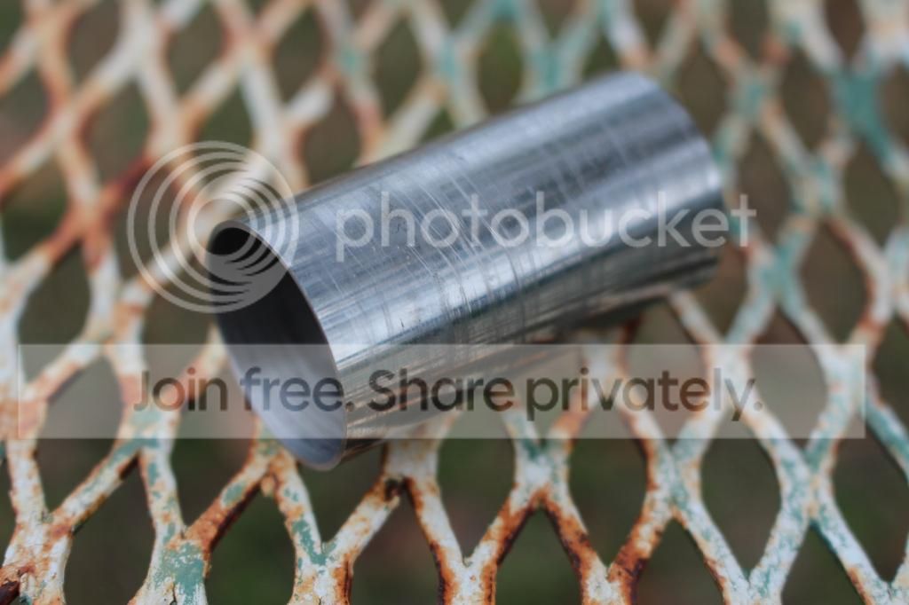

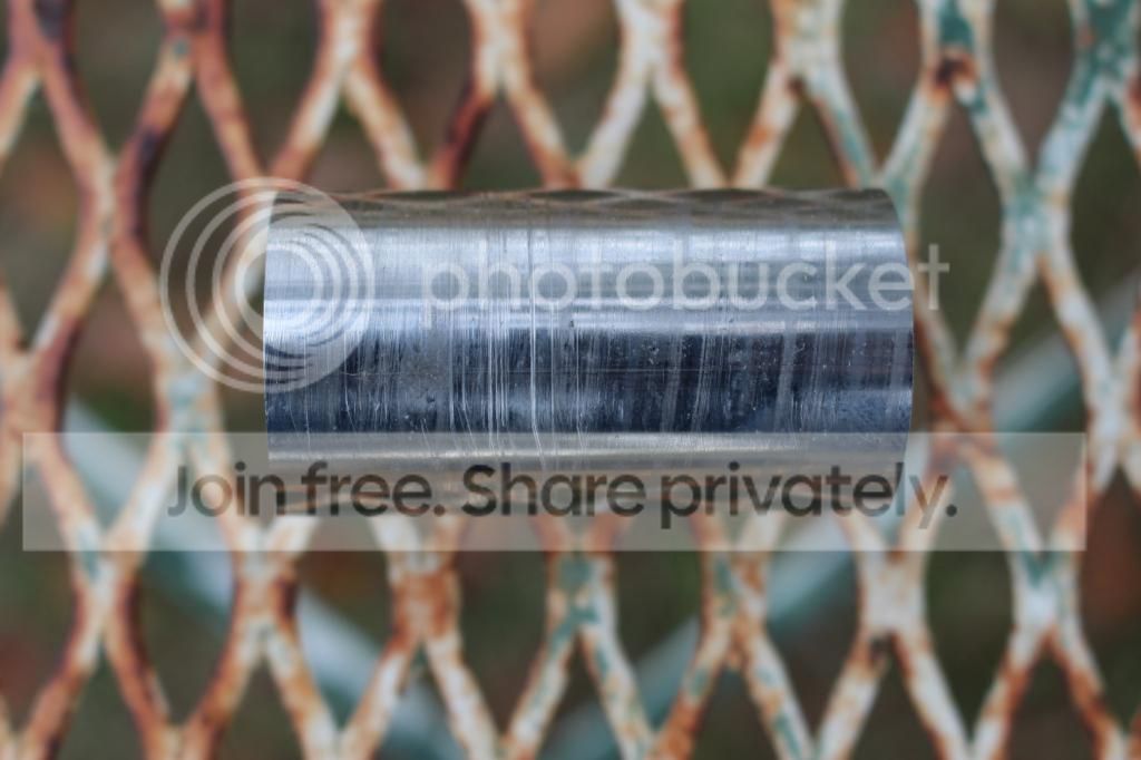

The attached image below is a picture of a part of the bar I used. On one side, there are some OD scratches that I think might have happened while I was boring it in the lathe (slipping in the chuck maybe).
After it oxidized during heat treatment, I wet sanded the hole saw at a low rpm in the lathe. I went from 220, 400, 600, 1000, 2000 wet/dry sandpaper. Lastly I used a buffing wheel with jewelers rouge polishing compound for a shiny finish.
The tool was never in a drill press. It was used with a T-handle which was only hand operated.

The valleys on the teeth should include a generous radius to reduce stresses and surface cracking due to repetitive stress/stain. Surface cracks are notorious for forming in sharp corners and will easily propagate.
Also, don't loan tools to girls. :D
The cutting edges of the teeth should be hard, the body probably should be softer to allow some strain without fracture.
