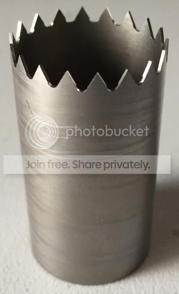

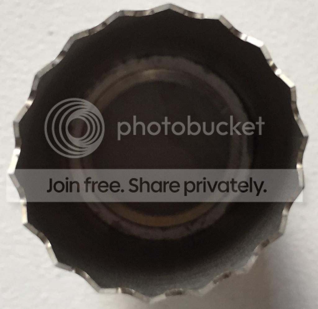

Below are images of a hole saw I created with a 1/16” TiAlN endmill. On the mill, I used an indexing head and rotated the vice 60 degrees clockwise, and then 60 degrees counterclockwise to machine the teeth. When it was quenched in oil, it warped, so I never really used it (I only air quench now).
I will go back to this machining procedure using a smaller diameter endmill allowing me to add more teeth. To make the cutting teeth hard, with a soft body, is induction heating on the hole saw a good solution?

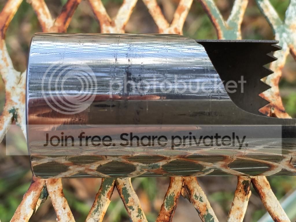

I really never did try to remove any of the surface defects until after I heat treated the hole saw (when I was polishing it). I did notice some pitting that occurred after the heat treatment (see image below). I couldn’t really polish it out unless I removed much of the material.
I cut a little over 100 times in hardwood, ranging from 1/8” to 1/4” thickness.
I will try a small set once I return to college this semester. If I can’t, I may try machining a bit off the body ID and OD, leaving a thicker teeth profile.

When using the endmill to machine the teeth, I can easily machine the teeth to cut perpendicular. This was not the case for the V-cutter.
