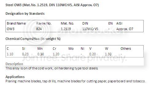

Funny - Din 1.2519 is AISI O7 is Hitachi Super Blue. It's a tool steel made for planer blades and paper cutting shears.
http://sij.metalravne.com/steelselector/steels/OW3.html

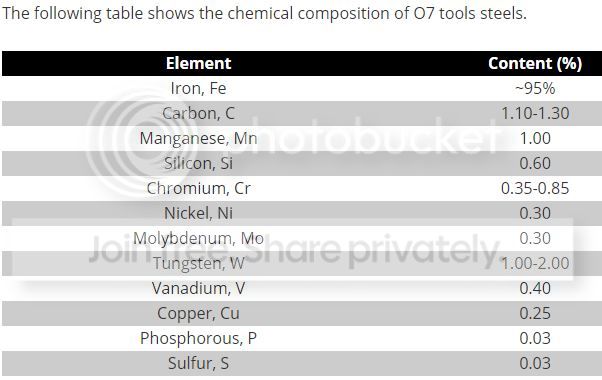

Yeah, they're pretty close, but not identical. Hitachi blue has less chromium (.2–.5%) and is shallower hardening, as far as I understand it. 1.2519 is also one of Roman Landes' favorite steels for thin edges, which should count for something in favor of Hitachi blue as well.
Varies from vendor to vendor. The AISI O7 spec specifies 1.1 - 1.3% carbon, .35 - .85 chromium, 1 - 2% tungsten (for red hardness). Super Blue is 1.3% carbon, .5% chromium, 2% tungsten.
The Germans have a family of DIN designations to micromanage the chromium, tungsten: I.2414 1.2419. 1.2442. l.2516, 1.2519. The important thing is that these are all dirt common tool steels used in industry for 70 years.
