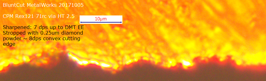

Testing a novelty/straight-razor edge on cpm rex121 at 71rc via ht 2.5.
Sharpened: 7dps up to dmt EE, then stropped on 0.25um diamond powder. est cutting edge (slightly convex) at 8 dps. ~ 0.004"/100um behind edge thick.
*note on perspective - at 15 dps bevel would be 8 times stronger than 7.5dps due to volume increases at cubic rate.
*the big chip cross-section-thick is about 0.007"/175um.
From my scientific/math view - curve fitting between points allow easy & fairly accurate interpolation. VS extrapolation/trend/projection error could easily be exponential when far enough from end points. I try to gather data points for rex121 (super high carbide volume, 71rc). I think, it did well - better than expected.

Above the edge shoulder(ES) could also be a factor - rex121 71rc 8dps large chip extended above ES to thickness 0.007", just not enough steel to resists bending into the primary (zero ground) bevel to a thin distal tapered spine. Whereas aebl 65.5rc 8dps has larger primary bevel angle - ok, just point out the geometry since aebl only had small edge ripples near apex and far from ES.
Thanks Luong! Interesting tests and corroborate carbide volume vs BET vs inclusive angle.
