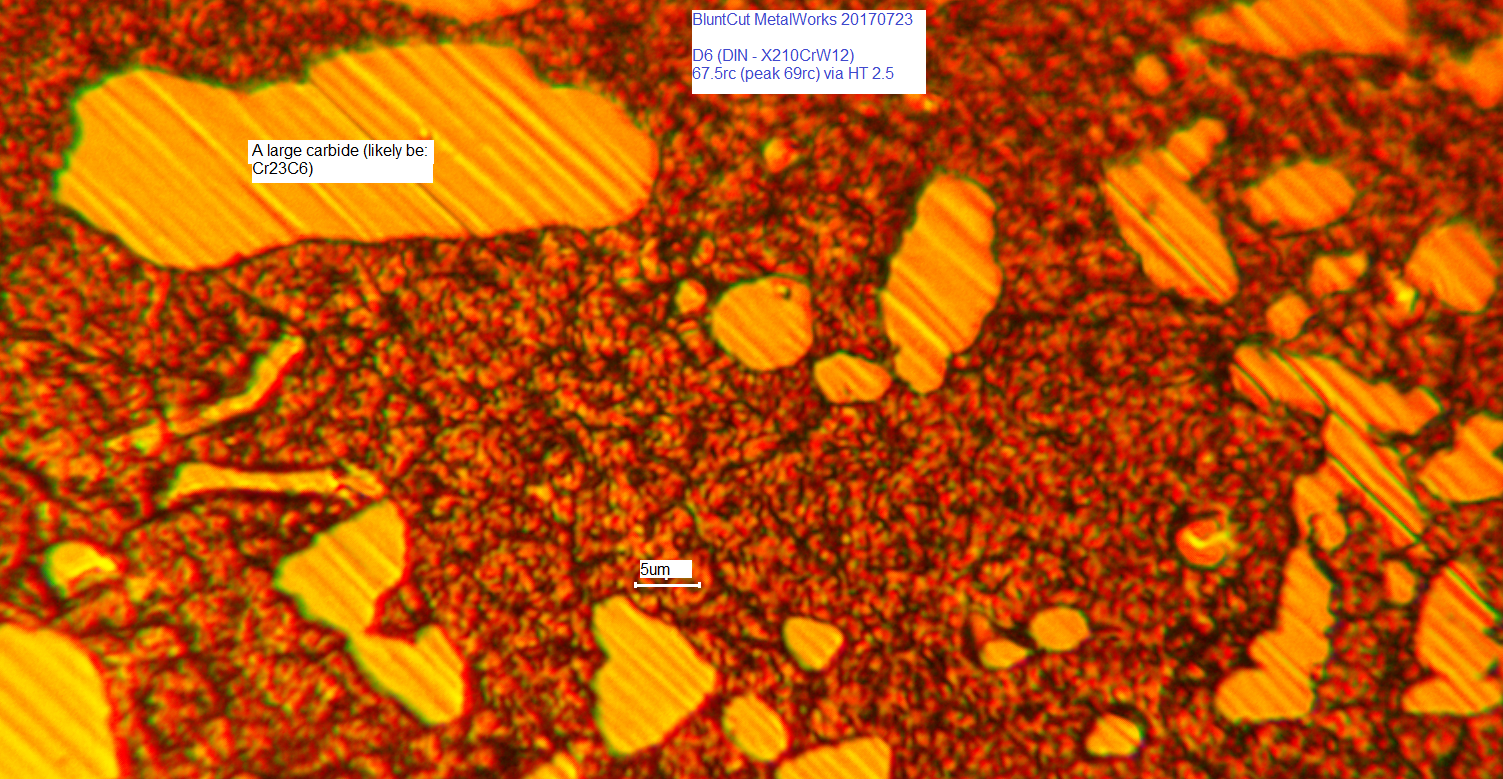

I re-hted 3 D6 blades with hardness peak at 69-69.25rc and tempered down to 67.5rc. Whittled hardwoods: passed. whittled bone: barely visible micro chips. Opened hole in a can: 2x magnitude compare to niolox above. Tested 8" chopping blade 16dps, 0.020" BET - passed on hardwoods, passed on bone using good chopping technique. Side slap-chop(accidental actually) on bone = loss a big chunk of edge (7/16" wide x 3/16" tall, 0.038" thick).
This is the first time I encounter a carbide this big. Grain diameter looks nifty good.
** updated pic
Whoa! Such a huge carbide!
I was thinking CWF process prevents such grow? More tweak needed?
From your previous calculation sheet, it seems Superblue is close. Is that why some people found it chip prone (I recall Jason B said so)
Those are primary carbides, it would take either close-to-melting heat or quite high temp + very long soak to dissolve them. You can see a lot of fine carbides, those are ht controls. I use D6 as easiest way to detect ht properties changes/improvement. D6 ht 2.5 result is good - even when cut a hole in the can. As mentioned - I've a 8" D6 blade (unfortunately partial tang) for impact/chop test, so far is 'too good' for D6. I think, best to leverage D2 & D6 large carbides as buzz-saw edge rather than trying to make uniform carbides (best just buy CPM D2 or use CTS-XHP). Right now, D2 is more balanced than D6.

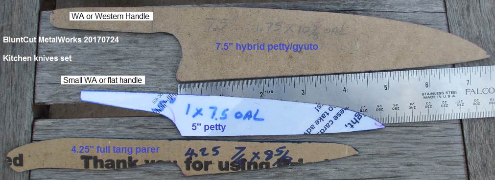

Just finished re-ht 2.5 3x niolox thin bushcraft - 66rc. Rough sharpening (120g belt + 240 SiC + 1K stone) 14dps, 0.005"BET EG(edge geometry) - cleaned & whittled frozen cooked beef rib bone: some micro ripples and chips (under 30x loupe). This ht 2.5 params for niolox are ready for a large batch of kitchen knives, 2/3 are pre-allocated.
Thanks very much for your trust - indeed a heck lot of it, since you didn't even see profile of these knives. I reserved a spot for you, please review knives profile and decide if it/they is/are good match for your need.
7.5" in 3.2 mm and 2.2 mm
4.25" in 2.2 mm
Edit: found extra 2.2mm blanks 8.5 full tang western handle gyuto, 5" full tang western handle petty, 4.25" full tang paring.
All will grind very thin FFG with distal taper. 7.5" edge might or might not has gradual convex for food-release above sharpening bevel. Stating this because I prefer laser and ok with some stiction.

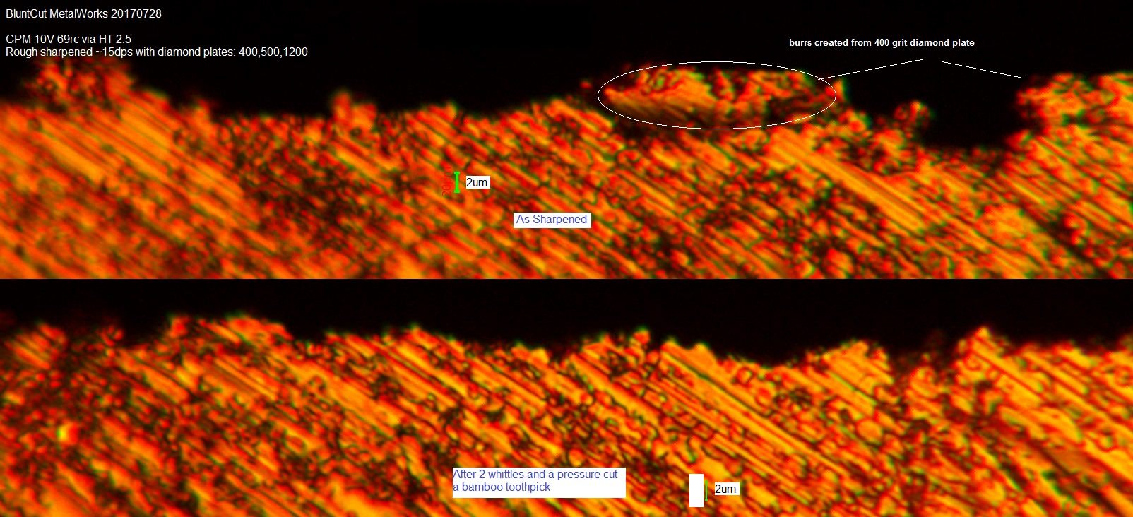

What is a stable/great/cool Edge? One's performance on indended tasks with less degradation than projected/anticipated.
Edge stability closedly ties to scope/size of yield at the edge. Yield Scope rough lists in increasing observable sizes:
Crystal blocks, single carbide interface/boundary, cluster carbides interfaces, individual inter-grain, single grain, grain cluster,..., global.
*crystal & interface yield can be either plastic and or fracture.
Rather than writing a thesis, I only discuss one particular instance pic-below. Further discussions/deductions/.. if/when interested.
Resulted edge (smoothly slice and somewhat push-cut phonebook paper) - estimated apex width is about ~3 to 15 microns (crest to trough). Yields occurred at single & cluster carbides and possibily single grain. So 10V 69rc with 15dps for tasks involve moderate lateral and hard compressive cuttings, I think a 15dps 10-15um wide apex would be an excellent stable working edge.
A good stable working edge (given appropriate strength & bevel angle) has radius relative to carbide diameter:
For steels with very hard carbides - 2 to 5x
For steels with moderate (e.g. CrC) carbides - 1 to 3x
For steels with no or easy to shape carbides - 0 to 2x

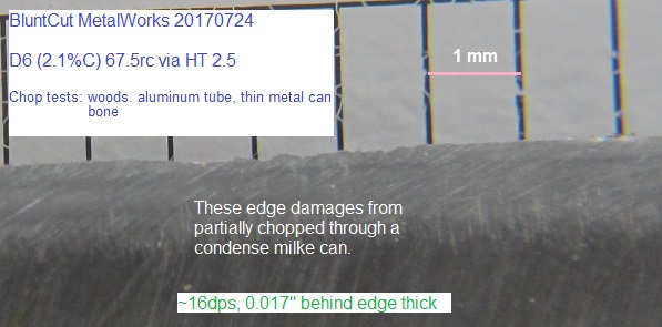

D6 chop is crazy! There might be damage, but the 0.5mm carbide is not the culprit. The HT somehow manage to contain it :thumbsup:
The small WA / flat handle (from post#586)looks interesting .. It'll be quite similar to a Victorinox paring (hint hint, 3" blade, 3-3.5" flat handle) ;)
Maybe there weren't many 50+um carbides near edge impact areas - idk, nevertheless D6 edge performed very well compare to any steels with similar edge geometry. Its hrc got lowered to 67.5 just as a fast way to go past-peak-hardness ease on matrix stress/dislocation. Where optimal hrc is just a notch below peak hardness - at this point, the matrix is barely into tempered-martensite with minimal precipitation.

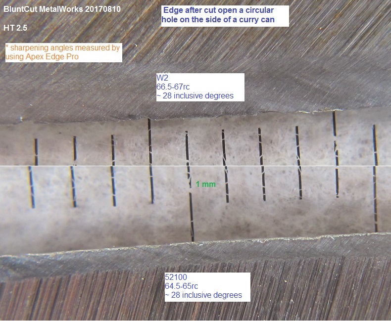

I took 2 days break from making niolox knives, to test HT 2.5 for W2, 52100 & Cfv. With current ht params, 52100 and cfv max hrc around 65.5. I will micrograph these test blades later...
Cut a hole on the side of a 14oz curry can:
W2 66.5rc = rolled, ripples and micro chips.
52100 64.5rc = rolled and 1 micro chip. This edge chopped dried beef rib bone fine (no visible or by touch damage).
Compare this result with steels with high alloy (this and last page), it would be apparent - low alloy steels have higher edge plasticity/toughness in 64.5-67rc hardness range.

I did a few more cuts with w2/52100/cfv. Looking straight down on apex afterward - 52100's apex width is over 3 times wider than w2 & cfv. otoh, 52100 micro chip cross section is about 75% and 60% thick relative to w2 and cfv.
