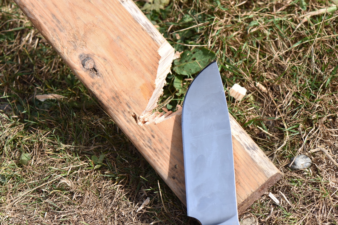

O1 HT 4.0 vs Control/baseline ht - A8Mod and 8670 - chopping test. Edge: Edgepro, 18dps, 600 diamond grit
Dried Eucalyptus: All passed (edges didn't reflected sun light)
African Blackwood:
A8M=dulled and area of minor rolled.
8670=dulled (apex reflects thin band of light and smooth to touch).
O1 = minor ripple (light reflected against edge bevel shows curvature instead of flat)
Dried cow femur bone:
A8M=dulled and minor roll+ripple
8670=dulled and micro roll+ripple
O1=micro roll+ripple
Chop 16D nail:
A8M=crushed and chipped * Surprised to see a very large chip at 60rc :confused: *
8670=crushed/rolled
O1=crushed/rolled
I've HT 4.0 52100 and 80CrV2 with same profile but not ready for testing yet.

My initial thought response was - small chips are precursor to large chips and eventually lead to blade fracture.
Tested A8Mod blade this morning, I made about 6 chops at 16D nail using diff part of edge (avoiding compound damages). First 5 chops were resulted with rolls/dents, so I thought - aha chip from round 1 was an abnormal/exception. Then came chop #6 - well I should be more confidence with my initial thought :)
This std ht A8mod 60rc blade exhibits combination of ductile and brittle behaviors, which reflected edge lacked of strength against hard material and would fracture impact load is large. With this observation, I think, this blade has poor overall toughness.
Both O1 65rc and 8670 63rc also tested with 6 chops at 16D nail = both edges were resulted with dent/crushed, no sign of chipping/fracturing.

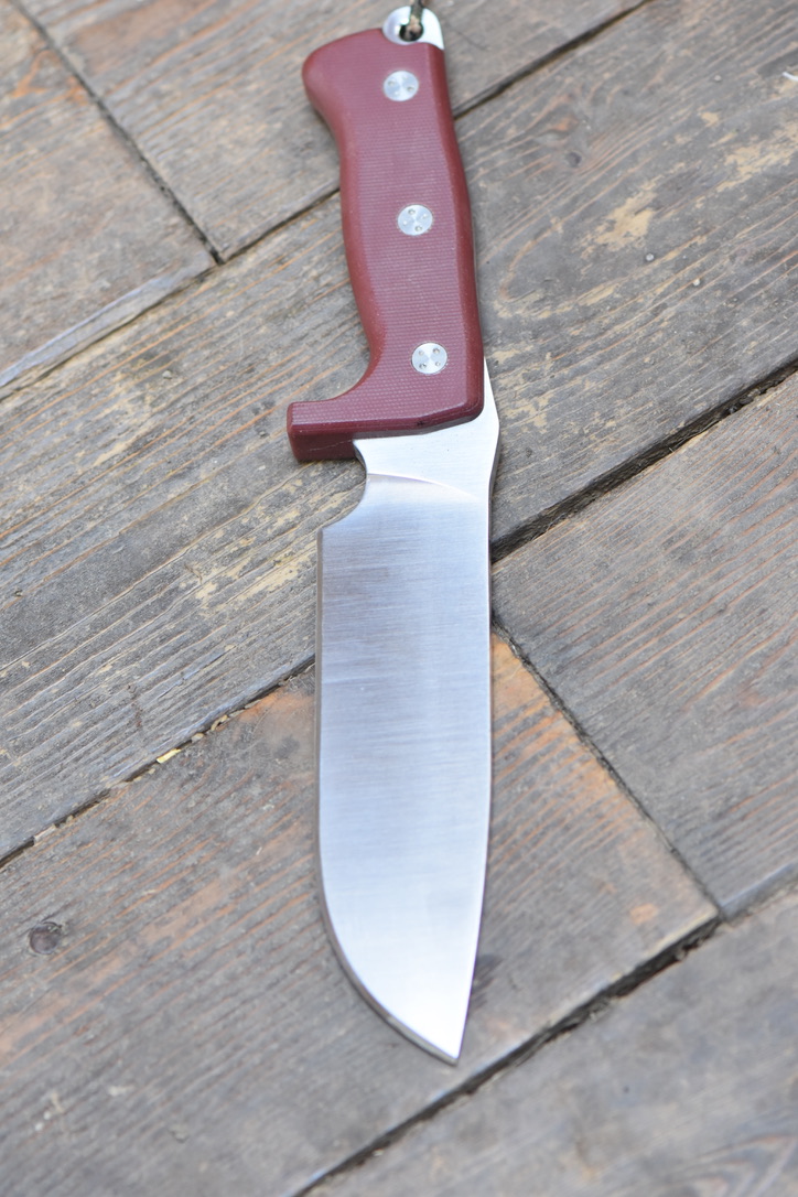

The knife weighs 18 oz. The blade is 7.2 inches. The blade thickness at the rear spine is 0.27 inches. The edge is 24 degrees per side. The edge shoulders are 0.055 inches. So, yes, it's a beast.
Because of the short blade, it's not a good chopper, but it whacked through a sun-hardened Doug fir 2X4 without much effort. After that chopping, the edge would still cleanly slice light notebook paper.
I don't want to test this knife to destruction, but I can usually tell if the steel is not up to snuff (which is why I have destroyed so many knives that just didn't feel right.) This steel feels good.

Refining jungle knife profile.
The .120" thick x 2.6" wide profile has very nice balance, especially for pinch-grip at sharpened edge heel.
