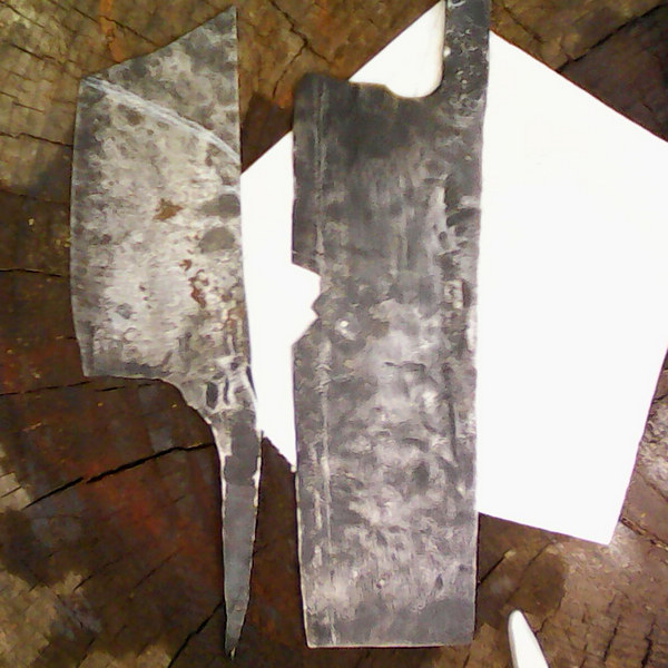

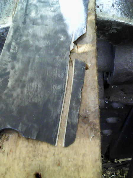

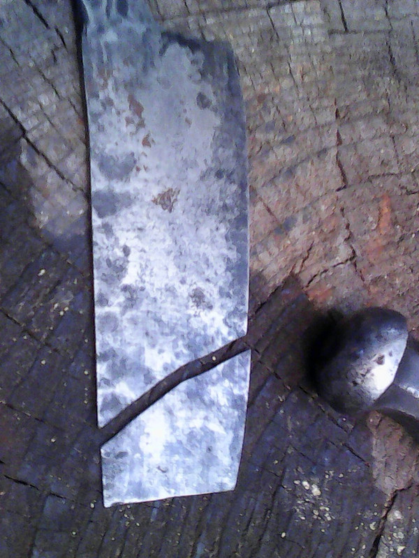

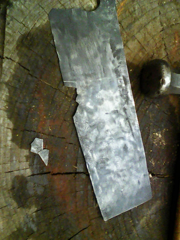

lost two knives trying to straighten by hammering (a few days) after initial quench. they where ground a bit too thin and austenitized in a forge, hence the distortion. the first knife, spring steel, was indeed very easy to bend at the spine but chipped badly at the edge (although not immediately). second knife, ball bearing race, wasn't anywhere malleable. took a few strikes, broke in half near tip. no change in sound/feel before breaking. apart from the microstructure obviously being harder than annealed or normalized, I suspect some of the contained RA simply transformed to martensite. which I guess would mean that if straightening is necessary, cryo should follow immediately after.

lost two knives trying to straighten by hammering (a few days) after initial quench?. they where ground a bit too thin and austenitized in a forge, hence the distortion. the first knife, spring steel, was indeed very easy to bend at the spine but chipped badly at the edge (although not immediately). second knife, ball bearing race, wasn't anywhere malleable. took a few strikes, broke in half near tip. no change in sound/feel before breaking. apart from the microstructure obviously being harder than annealed or normalized, I suspect some of the contained RA simply transformed to martensite. which I guess would mean that if straightening is necessary, cryo should follow immediately after.

my HT is, on the austenitizing side, too imprecise to discuss - austenitize to 800/850°C (bb/spring) in coke forge, less than 5 min holding time, check by eye and salt melting temp (800C), no thermocouple. I have one for checking oil temp of course and for general reference but it's not permanently installed like in an electric oven.
quench in 240°C hot oil, cooling rate below 1F/min thanks to 3-4 inches of wood ash isolation. after cooldown I cleaned the blades waited a few days (no particular reason, just had other things to do), then tried to straighten w planisher's hammer and a large soft wood block. for the spring steel knive it worked suprisingly well as long as I worked the spine only, the ball bearing knife by comparison didn't budge. maybe should have tried bending instead or a softer hammer.
come to think of it, during quench I left the blades hanging parallel to the sides of the container, where the oil could have cooled down faster compared to center. may have added to distortion a bit. next time I'll align them to center, edges facing inward.
thank you for offering to analyze the pieces, but I repurposed the knives. yesterday I considered the knives lost was intending to do some destructive testing & write them off; today I tried to salvage them i.e shortened or removed broken parts & finished the HT (20h freezer cryo + 20 min 130-140°C in toaster oven). the bb knife ended up ugly, serbian santoku like, not my favorite style but better than wasting hours of work, the larger spring steel knife has lower profile now, retained a nasty crack too close to the tang - will see how long it lasts before breaking. will post pics.

O outlandish710 - those are decent looking nakiri, unfortunately didn't ht test blades first, since your ht steps were problematic. 52100 shouldn't hardened much when quenched into 240c oil, where it actually hardened - which most likely this blade was quite over-heated/aust. For these 2 steels - ht 1.0 should be approx below
1. aust 800 until looks fairly evenly red (2-5 minutes soak)
2. quench into 50c canola (or some faster) oil for 2-3 seconds. Pull out and quickly...
3. into 200c oil to start CWF, slow cool until near room temp.
4. into freezer for 30minutes, air warm to room.
5. into 140c oil for 30minutes, air cool to near room then redo step 4. and 5. a second time.
*If/when need straighten, please heat up blade to at least 140c or higher at temper temp.
