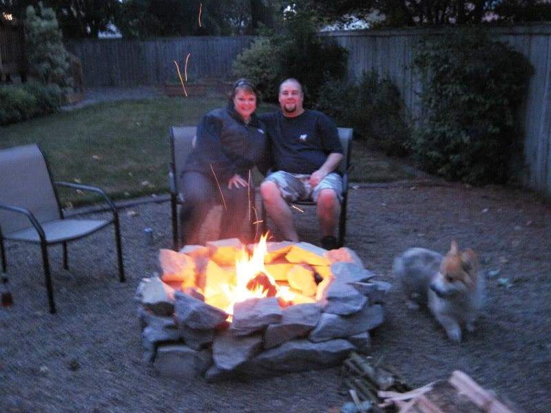

I built one out of stone in my yard over the summer. We spent a good bit of time enjoying a nice fire and some festive beverages!!
if making a stone pit,make sure you throw all the rocks you are going to use in a fire for awhile to test them, unstable rocks can blow up when heated. I used a semi-truck rim, and torched out the bolting plate to make a pit for my parents.
