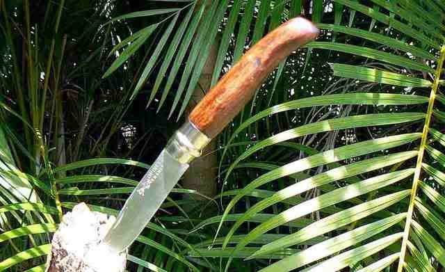

Heavy Opinel Use
Nice to see you use that knife and liking it :)
Carbon steel Opinels are great. Always keep one in my bag.
This (fine) review says something about Opinels ...... but it also says something about thin blades and folding pocketknives in general. Good job, Vivi.
It's just an undeveloped section of woods at the end of my neighborhood, bordering a golf course, another neighborhood and a real busy road. It's a pretty good sized place for where it is. There are even some whitetails back there.
Hope they leave it be...
Thanks for the pics and the test! Well done.
Thank you for the positive feedback :)
I don't see them developing it much further in the next few years. By the time they tear it down for more houses or a bigger golf course, I'll have graduated to the real wilderness methinks.
Anyways, Opinels aren't the only knives you can baton with. Saks can do it too :)
with the opinel did you have the blade fully out out partially out like in the pic?
It was fully out, then would move to close as I batoned it keeping some pressure on the handle. Then I'd straighten the handle and push down on it to straighten the blade back out, repeating the process. I'll try to make a video if this at some point so the technique is easier to understand.

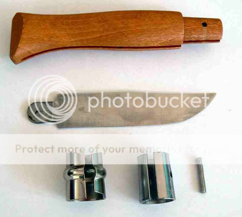

Opinels are pretty easy to disassemble.
The only thing holding the locking ring in place is the head of the pivot pin, inside the ring. If you hold the knife pivot-up/butt-end-down, looking at the slot where the blade goes, it's on the right-hand end of the pin. Take a pair of narrow pliers (a Leatherman or similar work well) and grab the locking ring under the raised slot on the right side, pull away from the handle, and up towards the pivot, the ring will pop right off.
Next, drive out the pivot pin. I use a narrow nail set, then a sawed-off nail; an old broken drill bit makes a good tool, too. The pivot pin is slightly flared on one end, but is soft enough that it's easy to drive it through the inner collar. It'll hang up badly at the blade tang though; a couple more firm whacks will get it through the blade, and after that, the other side of the inner collar if you want.
A few things I've found interesting:
  • The blades are stamped out of sheet, so one side of the tang is convex, with a bit of raised metal around the edge. Sanding the tang smooth makes the blade swing more smoothly. If yours is rusty, sanding away the rust will help a lot!
  • The inner collar is what controls the tension on the blade tang. If your blade is really stiff to open, don't sand the slot bigger, just open up the collar a bit. It's a lot easier to reverse if you go to far! The inner collar is not very springy, unlike the locking collar, you can just wedge it open a bit with the jaws of the pliers you used to remove the locking collar. Reassemble the inner collar and blade, without the pivot pin, to check the fit. If you go too far, just remove the inner ring again and clamp it tighter using a vice or large pliers; check the fit again, repeat as necessary.
  • Once you've driven out the pivot pin once, it's a lot easer to do subsequently. So feel free to play around with it! For instance, with all the metal removed, it's a lot easier to refinish the handle. Speaking of which...
  • I've refinished several Opinels; I like boiled linseed oil for a finish, since it repels water well but doens't leave a slick surface like polyurethane. I just sand off the old finish (and tweak the shape to my liking!), remove all the metal parts, and soak the stripped handle in a small bag with the linseed oil. After a few days in the bag, take out the handle, wipe off the excess linseed oil, hand-buff with a clean cloth, and reassemble. Couldn't be easier.
Thanks Gryffin! Very detailed instructions and I like your suggestion about the boiled linseed. I've tended to use paraffin oil (or mineral oil) and that works well for my other knives as it is ok for consumption.
I know this is a big ask but you wouldn't by any chance have any pictures would you? -- especially of the pivot joint. I can think of quite a number of people (including myself !!) who would be interested.
Thanks again.
I took a few pictures last weekend of my customized Opinels, but not in a disassembled state. I've got some time on my hands this week, I'll take some more detailed ones and get them posted.
Heres a pic of an 'exploded' Opinel - hope it helps.
