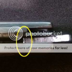

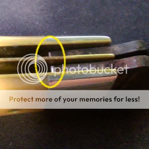

I don't disagree with you that it's not an ideal situation to get a knife that's just about unusable from the factory. It seems like GEC puts out a run here and there that are just super stiff. There are some of their patterns that are notorious for being bear traps. The report of super stiff pulls on the 77 HJs has kept me clear of them. It's weird because these were run at the same time as the last run of 77 barlows, and the pull on those is great.
I took a file and rounded off the front corners of the tangs on my 23 and that helped quite a bit. I didn't round them completely, just took the sharp corner off. I had a 78 that got a similar treatment and was pretty pleasant to use after that. Other than that working it is the only thing I've done that's had a lasting effect.
