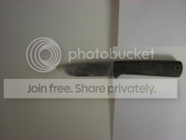

My ultimate hiking/backpacking/camping knife would be something like this but with a full tang, carbon steel, and natural handles.

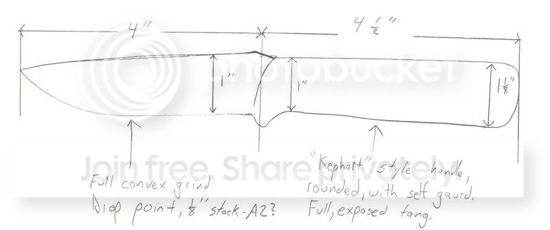

This thing is a little old so needs a little tweek here and there, but something along these lines would be perfec'. 1/8" thickness, 8.5" OAL, 4~" blade made out of a good HC steel.
One of the mods would be to make the butt a little less pointy. I might make some more up-to-date drawings... :p
Looks very much like my Fallkniven F1 with a slightly modified grip:thumbup: looks good
That's a good thing! The F1 blade shape with a Micarta handle would be perfection. Nice design.
The bottom knife in wabajack's post is my favorite so far. If you read the original post, the handle was to be a Kephart style. This is nice but I'd love to see a different handle on this blade. 4" blade, 4.25" handle, 5/32" thick by 1" wide or 1.25" wide. Nice design so far.
Kev, that design you sent me really looks to be a good choice. I still like SgtMike's idea, sodbuster/Kephart. I may just have to make one to see what it would be like. :D

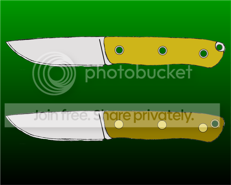

Kev, I posted these "over there" also.
Basically a Fox River with a Kephert handle. I added a small thumbramp on the drawing, similiar to the one on the Bravos. I thought about raising it some and adding a wider chord, like Mr. Ritter's griptillians.
