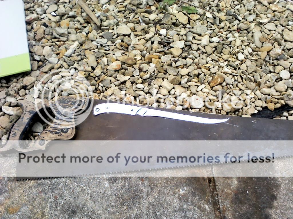

This is what I came up with. I've been sourcing some good but worn old saws to make kitchen knives.
I wanted a fillet knife after making a nice chefs knife from an old saw. I think my design not only looks good but will be practical in use too. I don't think the handle needs to be too long as I don't recall gripping the handle all that hard and only really using my first three fingers and thumb.
A good long blade for those big catches and a nice bit of belly at the tip for easier control on the finishing inches on single sweeps.
As I use saw blades not only will it be cheap but the steel is already thin and flexible! I killed my belt sander so I need to invest in proper one before I tackle any file knives or thicker steel!
Im looking forward to your finished design!
