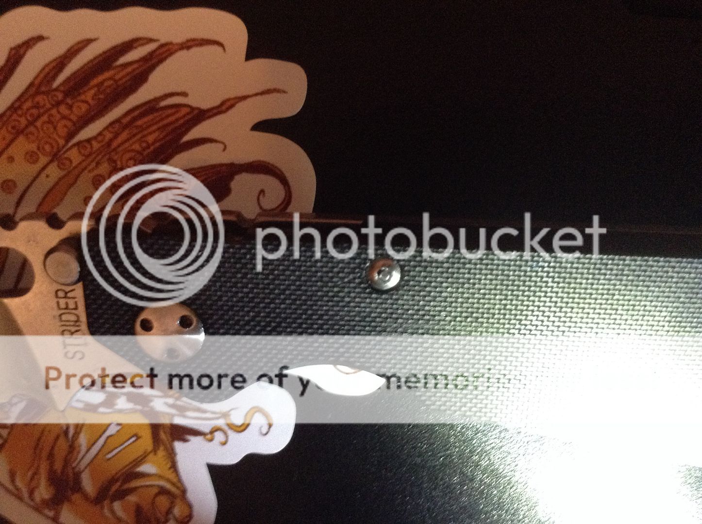

So tonight I decided I needed to take my strider pt apart to clean and lube it. I took it apart no problem but when I started to reassemble it I sheared the end off my Wiha ball end hex driver.
Now it's stuck in on of the body screws and iv been completely u successful at removing it.
Can anyone offer any advice on how to remove it?

No luck as of yet if tried pliers aswell as using a razor to try and catch the tiny bit sticking up.
It's almost flush with the top of the screw.
Tomorrow I might try compressed air or maybe even the shop vac, but after that I have no idea what to try.
I don't think I over tightened it I think it's just such a tiny size that it didn't take much and I probably shouldn't have bought ball end for this application.

Ok Anthony here we go. I'm wondering if the remaining portion of the hex ball has any of its six sides in an accessible position? My thoughts are that you can make a punch (maybe out of your broken tool) with a small flat nose so you can tap the flats in a crisscross pattern. Either it will eventually dislodge or it will start to back out the screw. Obviously it needs to be done in a counter clockwise rotation. Don't try to save the screw it probably needs to be replaced already. You can get it from the knifes maker. Make the knife secure so it won't move and tap easily, precisely. Freeze it first.

Can you take some pictures for us? I would like to get a visual..
None of the flats are exposed because it's a ball end the shank of the tool thins out right before the tip so you can accsess the fasteners from different angles.
I know the picture sucks if I get the chance I'll take a picture in the daylight tomorrow but it's supposed to be rainy all day.

The screw is larger than I thought which is good. New plan, are you able to make a punch with a sharp point. If you can put it on the side of the ball where it's touching the side of the screw and tap it to see if you can move the ball over to the center or to the other side we need to get some movement in it. If so then we can try to wiggle it out or punch tap it counter clock wise.
The way I see it you have 2 options if everything else has failed that others have mentioned above...
option 1: take all of the rest of the screws out of the frame, remove the blade etc. (basically disassemble it as far as possible other than the one stuck screw) and then you can turn the entire g10 half of the knife while using pressure to try and back it out that way.
option 2: use a dremmel and cut a slot in the screw head so you can get it out w/ a flat head screwdriver

Agree 100% after seeing the screw. I'd probably just cut a line across it and use a flathead.
