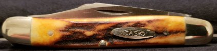

Case makes a lot of different stockmen, and having tried most of 'em, I'd say the humpback stockman (really a cattle pattern) is their most distinctive. It's the 046 pattern, and this one is in their 6.5 bone stag covers. It also comes with a clip main. With both the spear main and sheepfoot blades the same low height when closed, no matter which blade you are using it feels the same. The round bolsters and sunk joints are a big plus in the pocket. A very nice medium sized 3-blade.

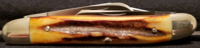

like @Planterz said, I would consider an older model 6332 (3 5/8")
I found this one from the USA era ('65 - 69) on ebay for $60.. great walk and talk, all springs sit flush at open and half stop, and no wobble.
sheepsfoot sits at same height as clip
(pics get bigger if you click on them)
tip sits way down into the well
