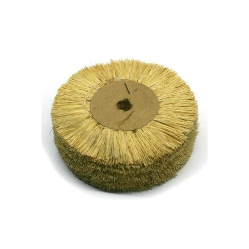

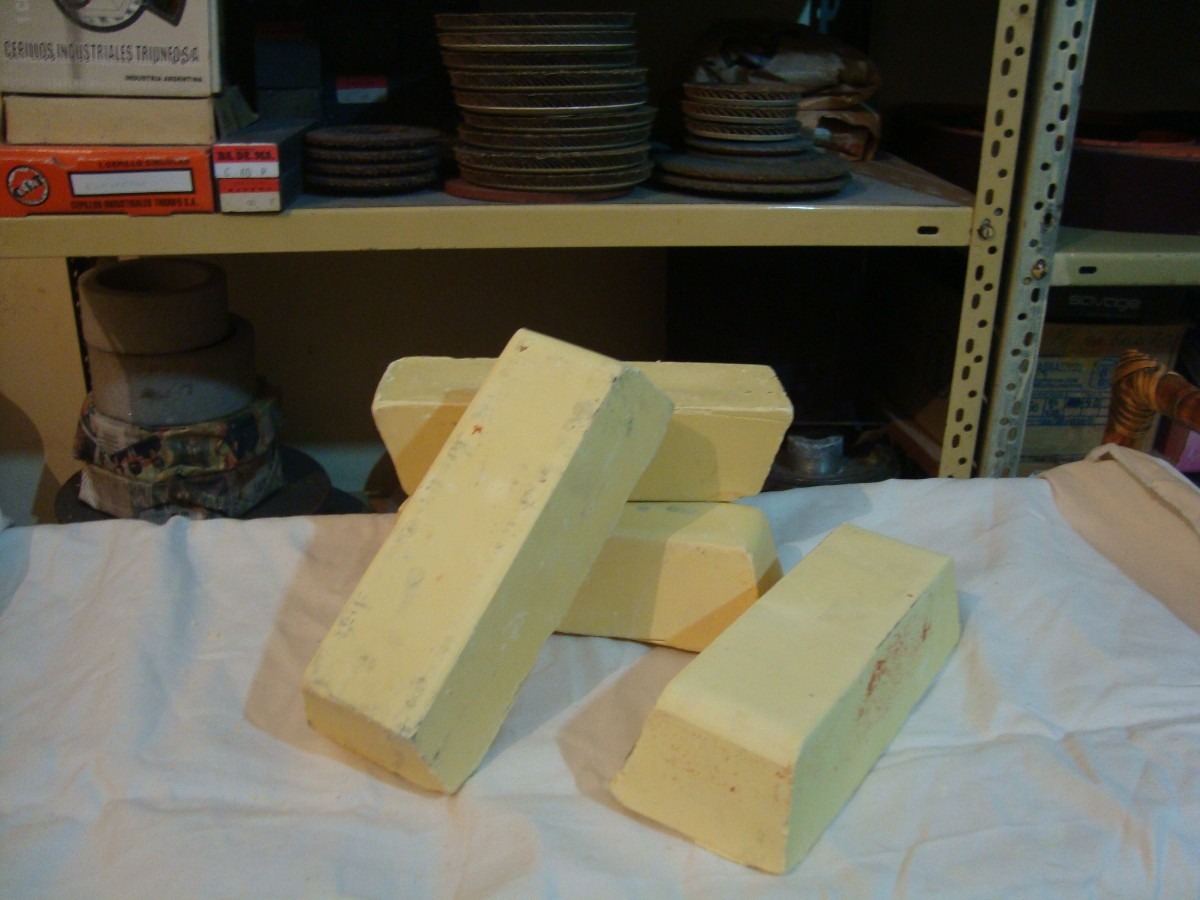

I don't know the english name for this wheel:
It helps a lot when you are around 150/180 grit to fast forward to a nice finish, not satin, but nice nevertheless, ideal for users not shelf queens. I use it with yellow paste, a very fine polishing compound for stainless. If you use lenghtwise the only drawback is that you cannot polish very near to the ricaso
Also when I use sandpaper I have an aluminum stick with firm leather attached to one side, sometimes using this side down helps with rebel lines :)
To remove lines near the ricaso I use different tools, a chisel shaped piece of acrilyc, also use 280 grit SIA pads and other times a scrap piece of wet thick soft leather.
