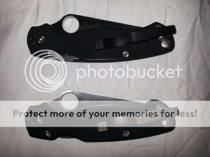

Help me out! My knives are too visible!
Do you know if it holds up well to wear?
I found a camo spray on their site, seems handy for maybe more than just my knife :D

I wouldn't use paint, it'll just chip off and look crappy. RIT dye the Tasman, then for the PM2, get some "PCB etchant." You can find it at RadioShack. They use it for etching circuit boards (that's why it's there), but it works great on pocket clips. Just take off the clip, dunk it in some PCB etchant for 20 minutes or so (it gets a bit darker the longer you leave it, but at some point it stops getting darker), pull it out and rinse it off well with soap and cold water. Just be careful, you don't want that stuff all over you and it makes quite a little stink. And use a glass or plastic container, or a metal one you don't care about, I guess. After all, it ETCHES metal. It makes for a good semi-dark matte gray, kind of looks like titanium. I end up doing this with all of my spyderco pocket clips. I don't have a great picture handy, but I'm sure you could do a little looking and find some. You can cotton swab some etchant over the hardware while it's assembled too if you like, i wouldn't recommend dunking screws whole for too long, as it will etch the threads down a bit if you leave it long enough
Take the clip off and slide it in a piece of electrical shrink wrap and hit it with a little heat to tighten it up and conform it to the clip. Poke some holes where the screws go and put it back on. You now have a black clip that can be returned to original when done and cost about 25 cents.

For the Para 2, just order a replacement black clip with black screws. I ordered 2 of them for my Paras and they work great.

You could buy a deep carry Ti clip from USAknifemaker and just modify the holes like I did and then paint them. Cheap and easy solution.
Just tried the shrink tubing suggested earlier and it works surprisingly well. NICE!
Tape parts of PM2 that you don't want painted, use fine sandpaper and sand down the SS clip, this both makes it more matte and helps the paint adhere better. paint clip and screws with mattte black or matte Od krylon like has been suggested earlier. Degrease it well first with alcohol. Scratches just look like camo. It is easy to touch up. Works great on field rifles.
Spyderco sells replacement delica clips which are black and substitute perfectly on PM2s. RIT dye works to get rid of yellow.
I think I'm going with the Black RIT dye for the Tasman and a black replacement clip for the PM2. Thanks for all the suggestions guys!

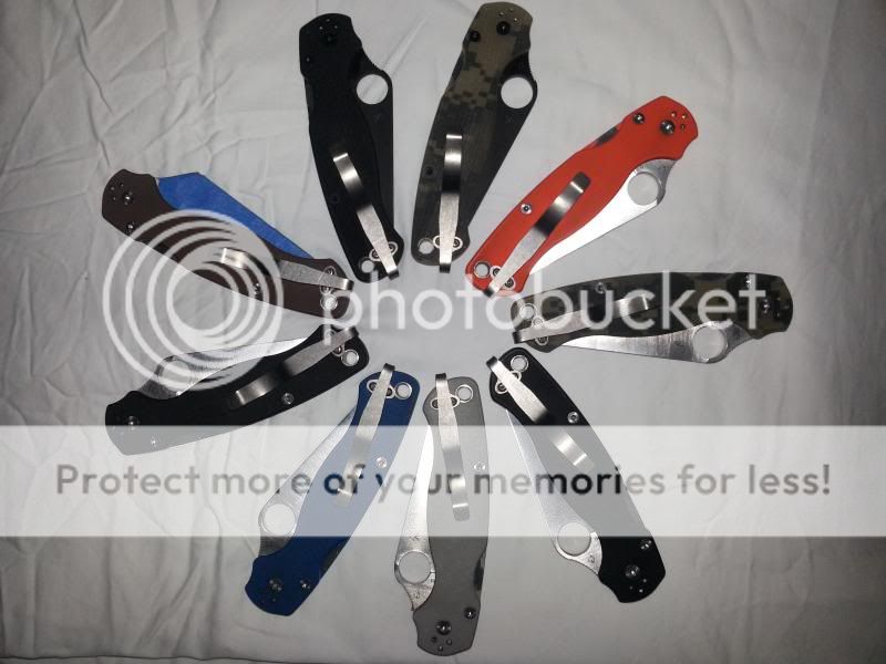

I've heat treated a few of my shiny clip...I Hate shiny clip. I use the middle of the burner on a gas stove. Let part of the clip get directly in the
flame. I do about .5" at a time until the clip is as dark as I want it. I do the HT when I'm cooking or boiling water for tea.
I've HT at least 5 or 6 clips including 3 Millies and a Manix XL. The XL is dark like it should be, like the orginal, not bright and Shiny.
The Milllie clips came out muliti colored...very sweet.
HT on a gas burner is easy IMO.

The heat works and makes the metal darker but it will still be shiny and reflective. I have done a bunch of clips and they all ended up darker with multiple colors. I use a propane torch and get the metal red hot. When it cools you can see what colors you have. I think the temperature dictates the colors. It lasts a while but it also wears off over time. The Ti on the Salt knife will get even better colors. But if you want it to not be seen I would go with something that covers the metal and makes it non reflective. The shrink wrap works perfect for me if I want a black clip and is pretty durable stuff. You can also put grip tape on if you want to cover the metal and give it some traction that makes grabbing with gloves a lot easier.
