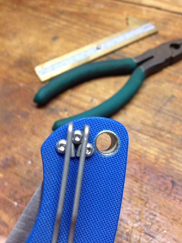

Little late. Dunno if you're still wondering, but heres a para2 with a standard clip I etched (see previous post). You can go a bit darker if you want. Kind of a crappy picture but it's really low glare, looks like a titanium CRK clip (that color). I rubbed over the Spyderco symbol with a sharpie then quickly wiped it off, leaving only the recessed logo inked at the end.
