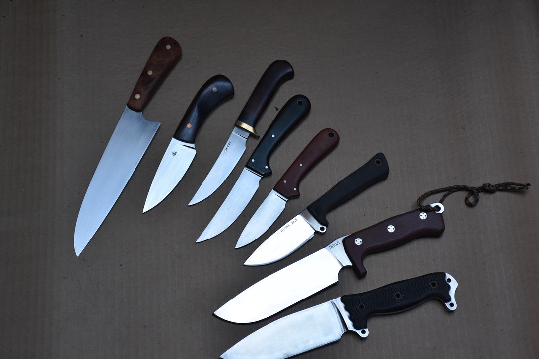

Here's a short video of people pounding a Nexus Centurione into a boulder without damage. The custom heat treat was elaborate.
The steel was A8(mod) at 59 Rc, with multiple thermal treatments. Part of the process was designed to prevent the participation of chromium carbides and transform residual austenite into martensites -- but I don't know specifics.
My Nexus is in this photo, just above a Busse Fat Ash, which porks out at a third of an inch thick at the spine.
