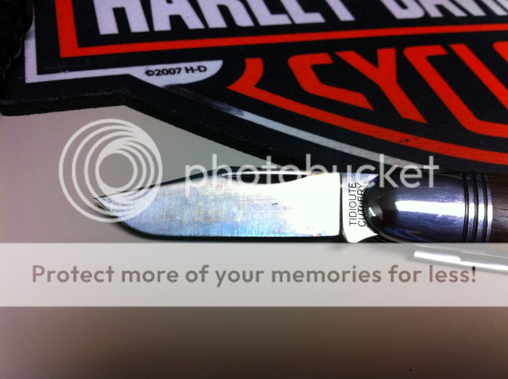

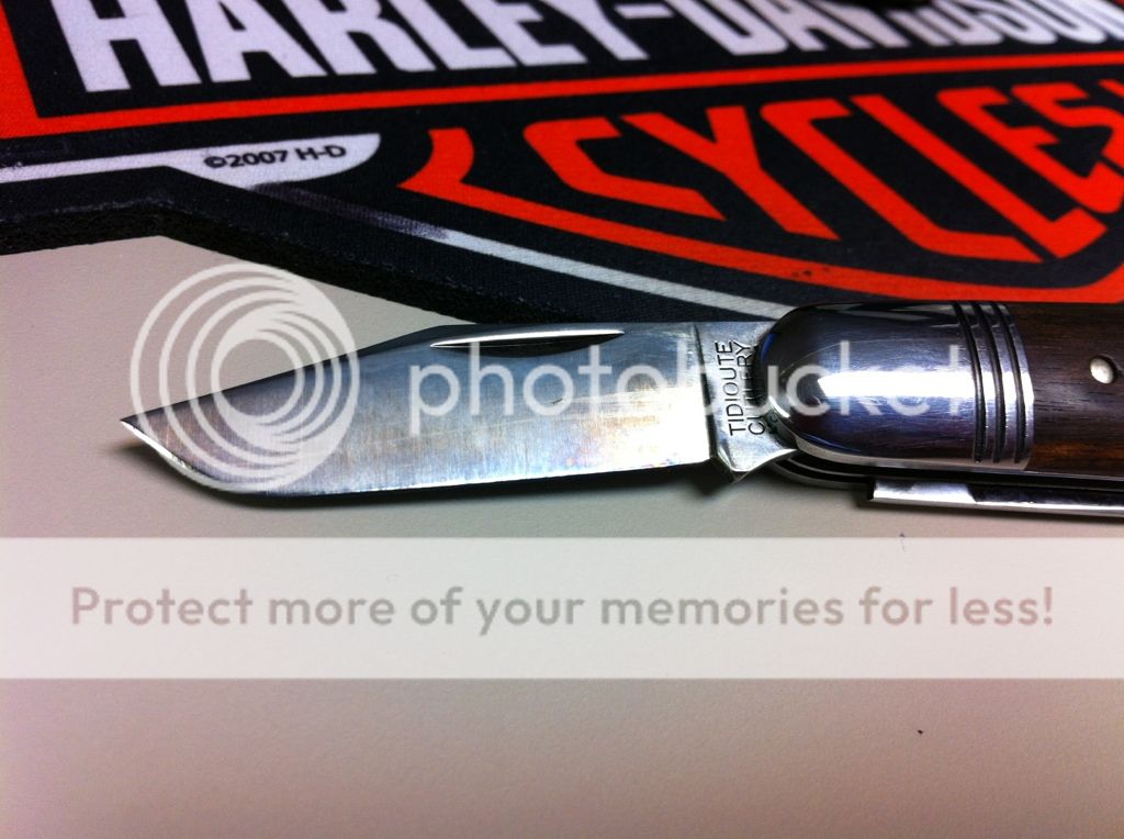

A couple pics. Not so great but you can see the difference between the SS #08 and the carbon steel #06 and #10.
Also compare the Opinels to a non-patinated Case CV Trapper. The Trapper is now a safe queen. Very lightly used and carried a few times (a dozen or so?) when new. Now it sits in its box. If I lived in a high humidity location like the south eastern US it would probably be rusting away by now.
