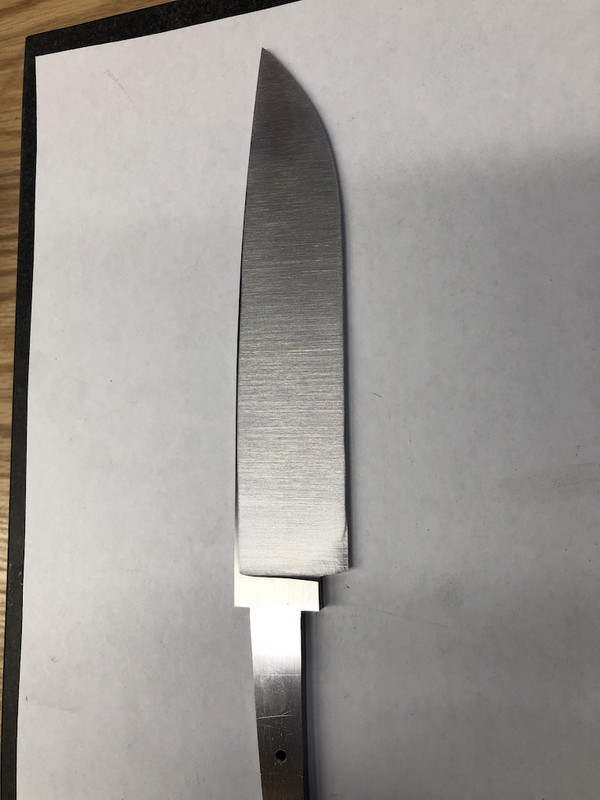

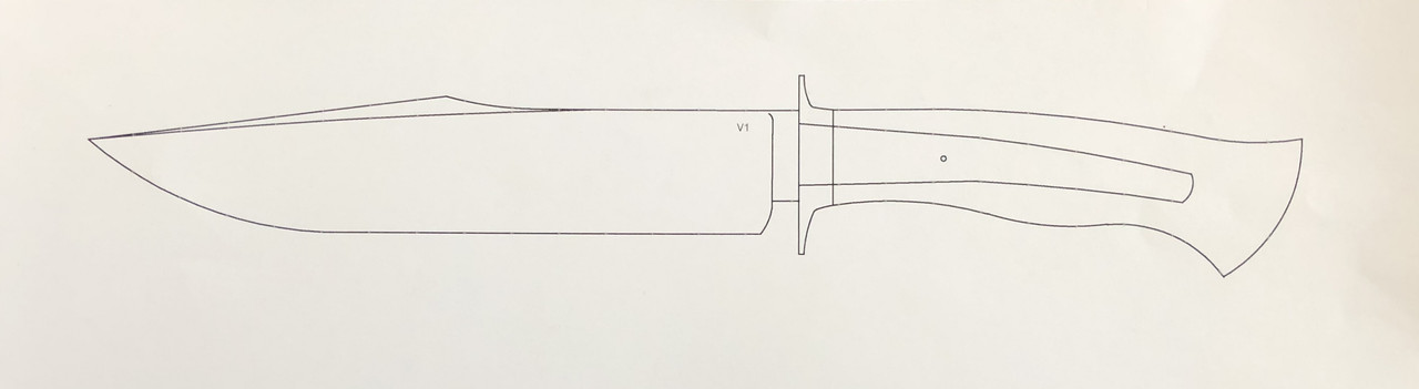

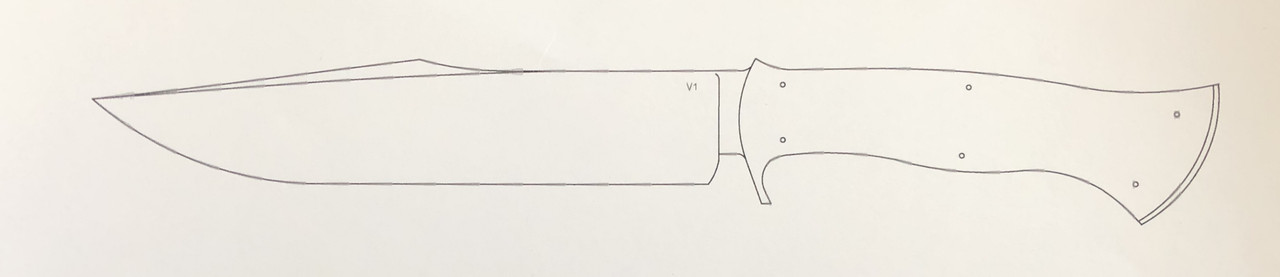

I went with choice "a", post #39 above. I want to finish the blade, so I can get more experience with all the phases.

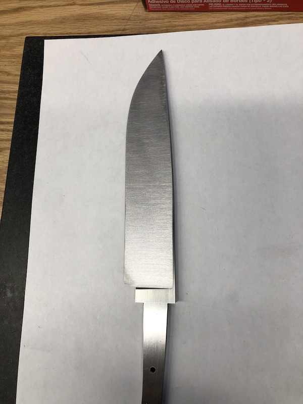

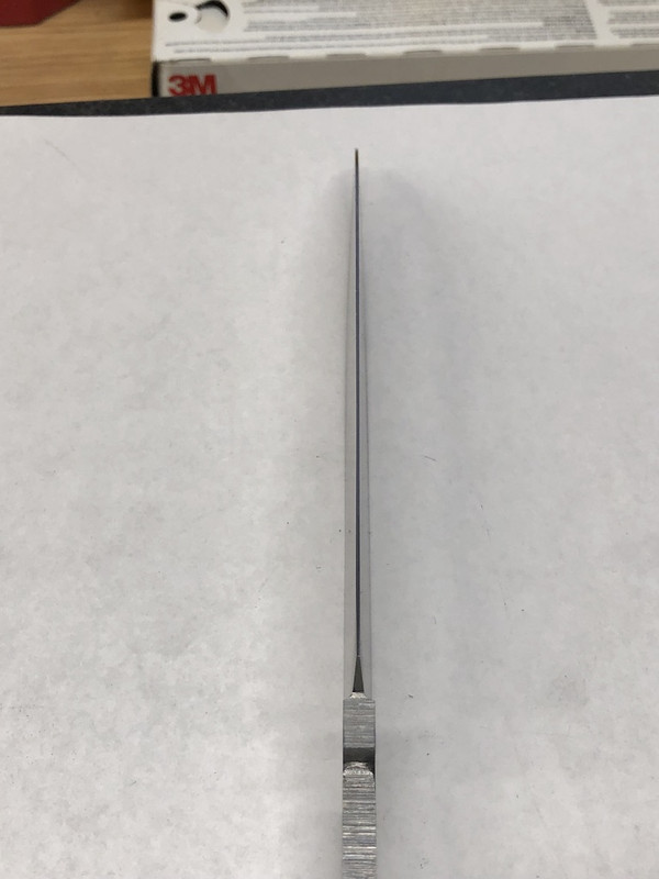

Here are some pics with the blade before HT. I will clean up some more on the belt grinder after the HT and follow up by hand afterwards.
Any comments welcomed.
I’ll post more pics after HT and clean-up on the belt grinder. In the past I’ve never went back to the belt grinder to clean-up after HT, only did it by hand, so I’m looking foward to the experience. I just got a 9” disk grinder, that I may use as well, will see.
Thanks,
Constantin
You are going to be losing some thickness from decarb. If you are worried about losing thickness I would wait till after heat treatment to remove more material. 3/16" is plenty thick. I use 1/4" for knives around 10" to 12" usually because I want the weight. 3/16" will still work out there.

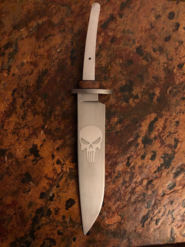

This is where I'm at with the build.
HT completed plus some etching and ready for making the guard and handle.

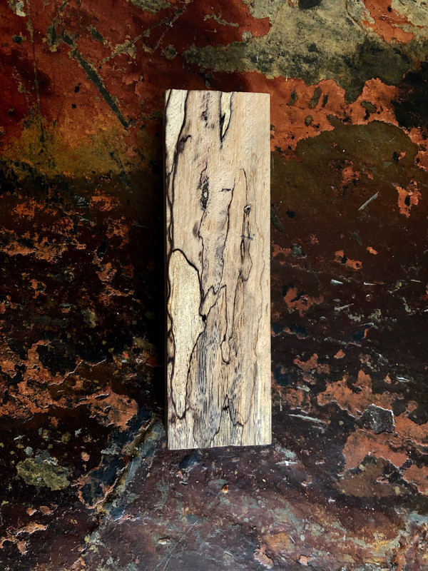

And here is the block I plan to make the handle from. Giving a hopefully nice contrast with the throat. The throat is a left over piece of amboina with G10 black spacers, and the handle block is spalted "some wood", the name is escaping me right now.

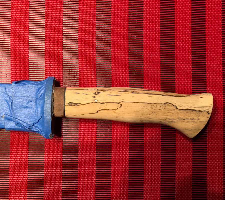

And here another update. Still need to do some more hand sanding but the overall shape of the handle is what you see.
I will follow up with the final results.

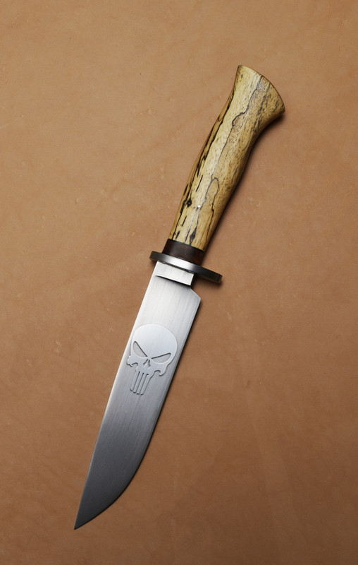

Here is the completed project.
It was a good learning experience going through all the phases, even so I new it wasn't "perfect". This is my third knife overall and first in this design. It turned out “ok” but nothing to write home about.
Having said that the next one will be “great” and if not, well the one after, and so on…
I plan to display (for myself in my shop of course) my first 5 knives to see the progression.
I do have a question about making/shaping the handle in relation to the throat, but I think I will open a new thread on that.
Many thanks again, for all the feedback and rest assure I couldn’t have done it without you.
Any comments welcomed. Please critisize what you don't like, it's all good with me :-).

Looks better than merely "ok" to me! Doesn't look like the typical third knife ever... Very nice work!
Very impressive for a third knife. I think you should be very proud of that effort. How long is the handle?

The handle is 5” long. That’s the feedback I received during the design phase, at the begining of this thread.

I came to the sub forum this morning specifically to see if this knife ever made it through to completion (I last checked in several posts back on page 2). Fantastic looking result! It is very clear you had a plan, worked out the details as you went, and the end result is as good as it is because of the up front work you did. This is really nice.
The punisher skull and wood seem a little at odds with each other (hard core tactical versus classic materials, just one man's opinion). Even then, to do an etch like this is really a nice touch. It's a personal element you added, but the planning and execution are great!

Thank you very much, your feedback will help me in the next build.
I agree, the handle material doesn’t really go with the punisher skull. The original choice was cocobolo or african black wood, but I opted to save these woods for future builds, once my skills get better. Perhaps a synthetic material would have been even better.
I will keep in mind to pay attention to the synergy between elements.
