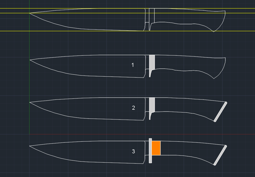

Hi again,
Thanks again for all the feedback received, it has been great.
I believe I made my mind on the knife for this build. It will be the "kitchen knife blade” style with a Bowie influence, for a lack of better description.
This for me, will be the largest blade to date. It will provide me with a good challenge and a chance to get better through more practice.
I incorporated the feedback I received to date and please let me know if I’ve missed anything.
I’m now trying to decide between these variations. Regardless of the the pick, they will all be great learning experiences for me.
I kept the tang hidden in the drawings for now, until a decision is made.
Please let me know what you think about the below options and help me get started.
Please note, some of the curves in the pic below look jagged, this is because of the low res of the .bmp file, but once printed on paper they're smooth. So any kinks, will be smooth in the real world version.
Thanks again,
Constantin
Looks good. Just keep in mind that there isn't a lot of belly towards the tip. So the height of the blade there is on the shallow side. To make sure you have adequate strength at the tip try to leave some thickness in the cross section.
Such a great point again, thank you!
Constantin
i4Marc i4Marc , i’m working with 3/16” stock and planing to gring the distal taper before the bevels.
When gridding the distal taper, should I account at this point about the cross section thickness near the tip and leave enough meat, or does it apply more when grinding the bevels?
I’m also going with a full flat grind. When keeping more crossection at the tip, does this mean that the flat grind becomes a bit more convex near the tip?
Trying to get my mind around what happens.

I decided to go with a bolster handle combination. This should look nice I think and a great experience.
I have received great tips over here, https://www.bladeforums.com/threads...process-please-explain.1643336/#post-18791899 regarding this type of handle construction, really cool if you didn't know about it, as in my case.
As for the guard, I'm not sure at this point, either like in #1 or #3 above, will see, still a while to go to get there.

I’m second guessing myself if it would make sense to include a guard, since the blade is so much kitchen knife shaped.
What do you think, could I just go with a spacer and handle, without a guard? Would that go well with a blade that has a ricasso? Or maybe some sort of a tiny guard?
If you have any examples that would be great too.

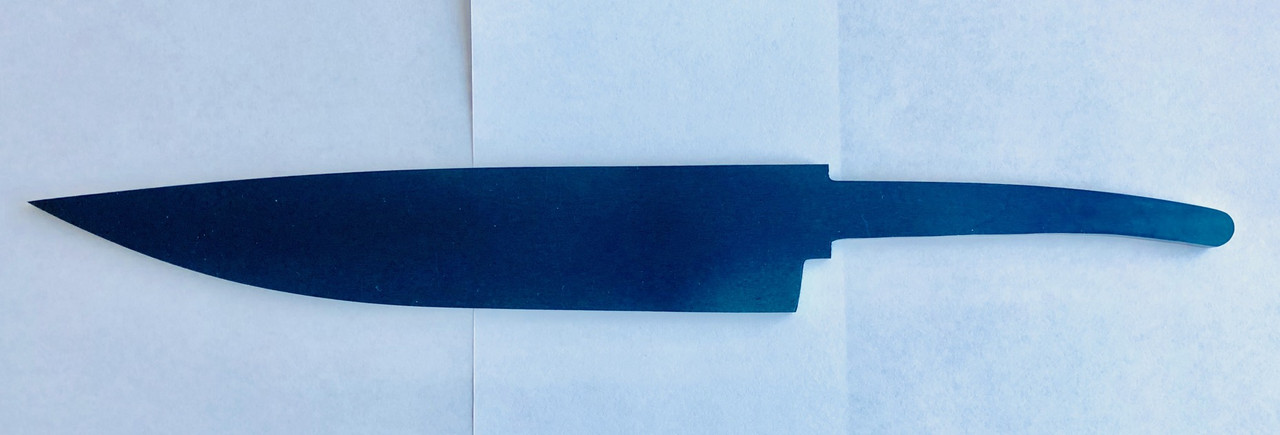

I’ll post a pic of the blade before HT, not there yet.

You want a guard on any large fighting knife ... just ask Jim Bowie's dad.
Try drawing the guard tip with a little rearward curve. I'll try and post an image later.
