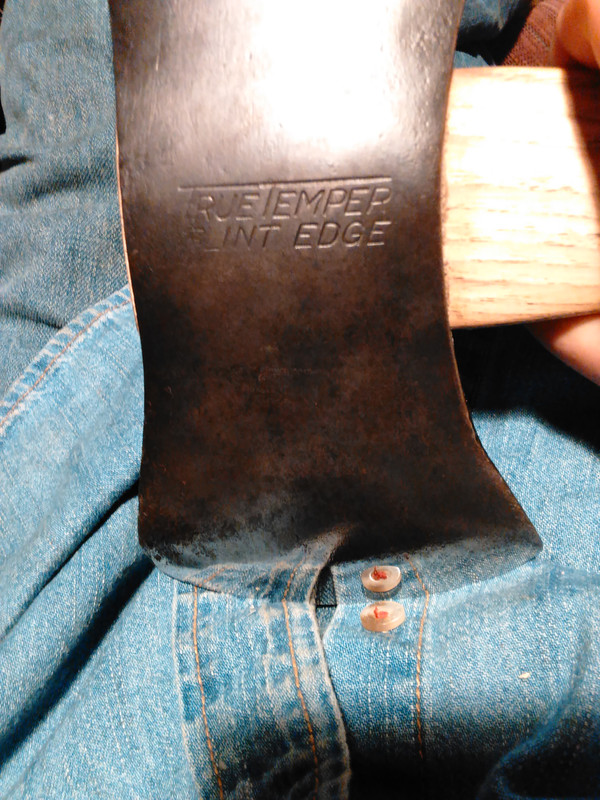

About 30 minutes for both bits profiling with 2 Simonds files, a double cut, and a nucut, then removing the scratches with sandpaper. I just went to 360 grit, then buffed. A scalpel ain't this sharp. It scares me!
