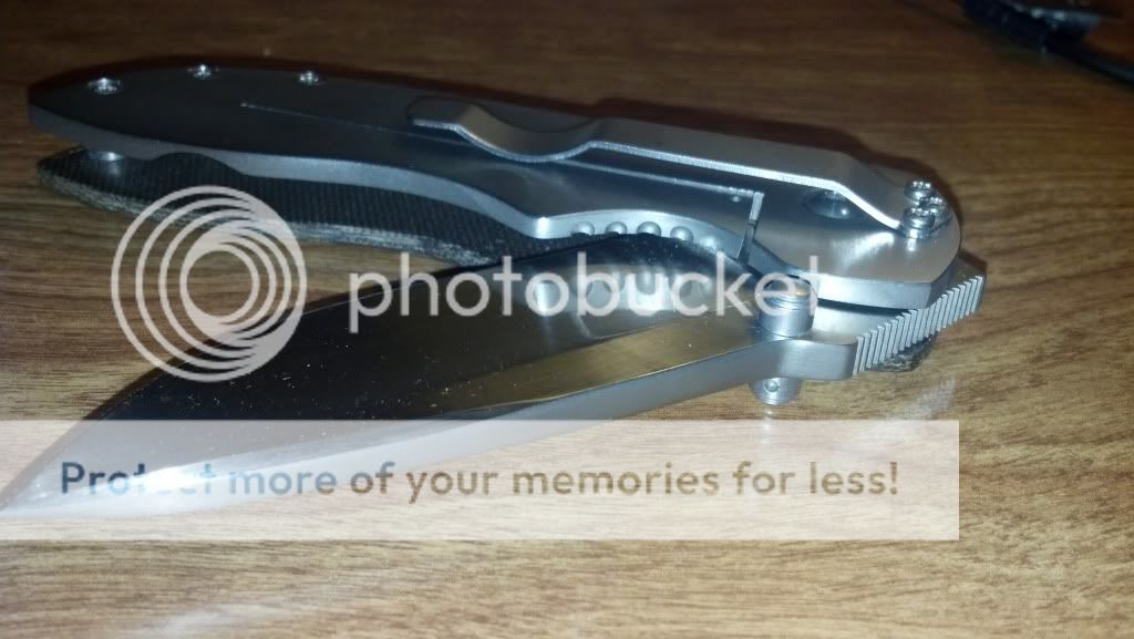

This is one of the best cutters I have. Ron Flaherty model 1 .200 thick A2 deep hollow grind. I was supprised at its cutting ability. The geometry is perfect.
