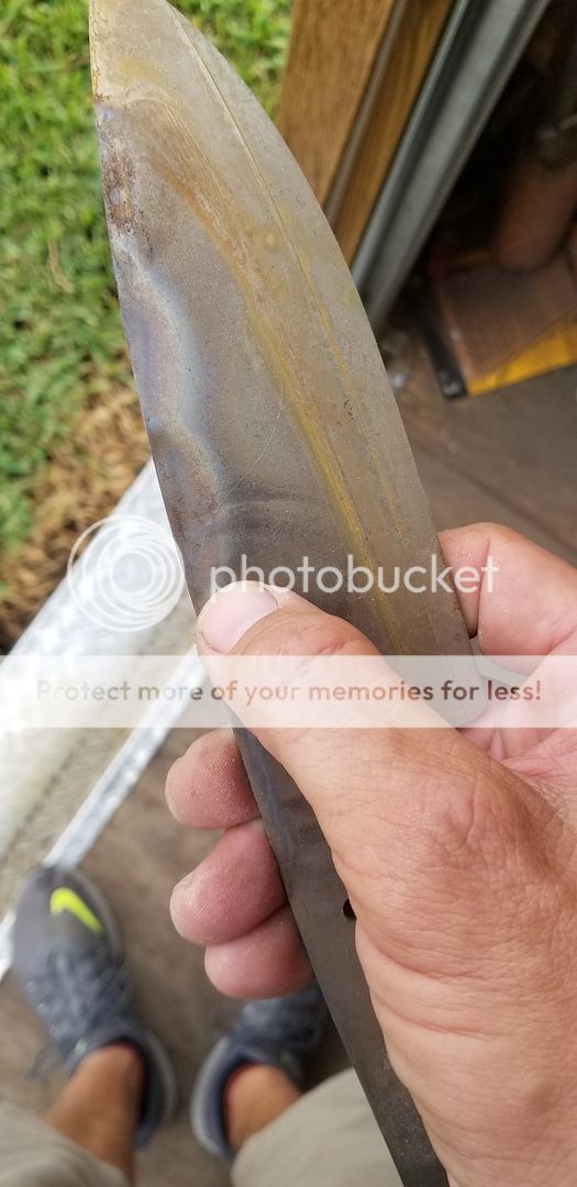

Do you know if these blades were cut in the longitudinal or the transverse direction? (In line with the rolling direction or against?)Thanks for any help.
It was a 2 by 24 in bar, I cut with the grain. I could see the spot where it got heated up. A 3/8 in round spot. Sure enough, like the other one, I could see the hairline crack while hand sanding. I'm going to email them today. It's a little frustratingDo you know if these blades were cut in the longitudinal or the transverse direction? (In line with the rolling direction or against?)

Do you remember the name of the person at Peters that you talked to?Talked to Peter's, said they rarely have problems with breaking, but when they do its almost always AEB-L, They said call Chuck from Alpha. Nice dude, very friendly and helpful, but thought the round spots on the blades after heat treating were from bad steel, not the straightening process.
Thanks dude. I don't know much about the chemistry involded, but I've sent blades to other places, never had an issue, you're the only place I've bought steel from. My unprofessional opinion is it was the heat treatDo you remember the name of the person at Peters that you talked to?

It is from the torch. You have a soft spot bordered by much harder steel and then it it bent.
The stress in that blade should not be there at all. The stainless blade should be homogeneous throughout not hard and soft spots.
I talked with Jeff Mutz from Trugrit about this before and he has done thousands of AEBL blades and never a one cracking

This is a normal size batch for me, 53 to do. All are AEB-L, all steel is from Chuck and all ht by Peter's. I've never have had one crack like you have. And thats with thousands of knives. Many of my customers are the most user and abusers there are, working cowboys. I've never had an AEB-L blade returned because it broke. Handle repairs now and then (there's two on the left side of the bench in that first pic) but never an AEB-L blade. Again there are thousands out there getting used hard. I'm kinda perplexed on your deal. Well since that pic this morning, I got all the bolster material cut. Gotta go drill some holes and peen some mosaic pins.
