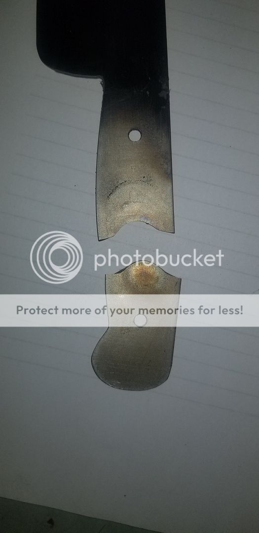

Help with broken blade
The cracks on his blades are occurring where they hit it with a torch and we know what that does to a stainless blade.
If you have one that is cracked heat treated by Jeff, you can be assured it is not due to him taking a torch to it.
Granted buddy, I think I screwed up the grinding on that one. My bad, still happens once in a while. Also I should mention there is one A2 blade on that table that was heat treated by Jeff, realized when I was drilling holes in its bolsters. Anyhoo, what I was trying to get across is, I understand the concern regarding the torching. However, day in, day out, knife after knife, same steel and supplier as OP and same ht as OP and I've never seen that happen. Not once. Not when I'm working on em and not after they've been bought and used hard. Not once. So why are his cracking and not mine? Lots of mine have been torched too. Still perplexed, quien sabe?

nevermind, I was trying to use one of the other hosting sites, didn't work. This picture shows the torch marks

It seems this is occurring on longer blades and they probably had a large warp in them. On your blades the warp was probably not as significant on a shorter blade or non existent.
Not all warpage is going to be very large, but on a large warp it would take more heat and more bending .
We know there is going to be stress in that stainless blade and a blade with hard and soft spots which is bent straight there is going to be a war in that metal and sometimes something gives.
I know from observation that AEB-L can actually still move for days after heat treatment and that would play hell on a blade already under stress.

This place man. I completely hand sanded this one, both sides, take it off the jig I have to hand sand on and it's in 2 pieces.
So a question is what is the target HRC your knives are supposed to be and what is the target HRC for OPs? I don't know if Peter's only does AEB-L in a certain target range or allows the requester to specify/request a range but it would from my understanding be a very different process to hit 60-62 vs 59-61 which could explain the differences in results.
