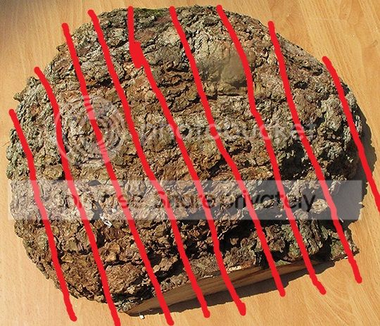

Hey Everyone.. I got myself a nice piece of Manitoba Maple Burl on the weekend.. I am not sure as to where to start to cut it up and such.. I want to use it for my knife handles...
What is the best way to start with it?? Which way to cut it up? How long and thick (I want to make bookmatch sets), stabilizing? Etc..

These are the 2 pics of it.. It's a nice size... Around 18" in dia..
I have access to a cnc bandsaw so I should be able to clamp it and cut it up... It is wet still as I only cut it off on Saturday.. I brought it home and into the house where we have central air so it's not outside in the humid weather.. What would be best to seal it with while it dries???

Just a note: it could take two years for that to dry out. You may want to cut it up into blocks that are a bit over-sized for the handles you'll be making. Leave some allowance in the size for any warping that might occur as it dries. The more surface area, the faster it will dry. Seal them as recommended.
There's a wood seal called anchorseal that I use. Just about anything water based will work though; I've used latex house paint in a pinch.
A good rule of thumb is 1 year per inch of thickness to dry. If it's outside or higher humidity, it will take much longer.
If you seal wet "maple", the sugars in the wood harbor bacterial which will discolor it before it dries. A dunk in denatured alcohol for an hour or so, then air dry to touch before sealing will prevent this.
The wood you have we call Box Elder in the states. It's very soft and should be stabilized before using it on a knife. Also, if you expose it to sunlight (UV light), the red streak will turn dull brown.
Just cut it about 20-30% oversize, seal it and forget about it for a couple years.
anchorseal is the stuff to get, it is a clear wax sealer, cleans up easier than latex.

You don't want any good wood, and especially a burl, to dry FAST. It is slow that will get the quality needed for a select handle block..... the slower the better.
No desiccants, heat, microwaves, kilns, etc.
Coat all cut surfaces with Anchorseal or latex house paint and put in a reasonably even temp place for several years ( garage or basement works well). Cut it up then and let dry for a year or two more.
1 year per inch thickness isn't unusual for dense wood.
I am not sure if you have cut this yet or not.
First, maple is one of the easiest hardwoods to dry.
If you haven't cut it up, I would just paint the cut surface and put it somewhere dark and dry for a couple years.
If you really want to cut it now I would cut like the red lines in the photo.
Cut the strips 1&1/4 to 1&1/2 inches wide. This allows the wood to move a bit while drying and when you flatten the dry pieces they should still be thick enough.
The lines are following the length of the burl the way it grew on the tree.
Then stack the strips in a cool dark place with spacers in between each piece.
They will probably be dry enough this time next year. Maybe a few months longer.
If you leave it in strips instead of cutting into blocks you will be able to cut blocks from areas that did not crack while drying.
From the photo it looks like a bunion instead of a pin burl.
The figure will probably be kind of a crushed velvet look instead of eyes.
