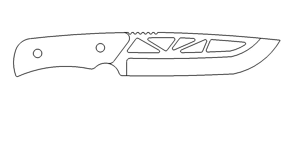

Ok this is Rev. 1.3.
Changed the handle shortened the jimping and moved it back a little.
for utility use
i would drop the pockets , or leave theme in but full flat grind the blade,
egde angle will be to thick to be to thick for lots off uses, to have a small degree cutting angle
by flat grinding you also make the point a little thinner,
for crow bar use.. best leave as is , but do a chisel grind or accept the bevel will not have the same angle over the length
You talk about the pockets making it lighter, this is true but what is the blades intended use for you. When it comes to balance there is in my opinion three variants. Handle heavy makes the knif fast in hand liked by knife fighters, center balance makes for a great thrower and blade heavy is perfect for bushcrafty stuff, chopping batonning and what not. Unless its just for looks and collection then by all means plate it gold and throw in a expresso maker you know :D

I'm personally not a fan of jimping but that isn't really important, what is is that it is nice and comfortable. I like to make sure they are very smooth and well finished before heat treat. Jimping is a trade off, you are less likely to slip up on the knife, it aids in some control... on the other hand it won't be as comfortable over long term use.
The grind could be great, saber grinds are well proven and a great choice for a camp knife.
The handle looks fine to me, keep that drop to it for sure.
aesthetics of the triangles... I tried some in earlier designs and looking back I don't like them, to each their own. I see where you are coming from though.
One thing to consider is that with a saber grind you probably want some weight behind it for light chopping or at least nothing to catch when splitting or plowing through material.

Well obviously the triangle pockets are very unpopular as they serve no purpose except looks and could possibly hinder the usefulness of the knife overall.
However, I like them (at least I think I will) and they are staying.
This is one knife in a future of hopefully many and I'm just stuck on this idea. I really do appreciate all of the advice but the pockets I guess I'll have to learn the hard way.

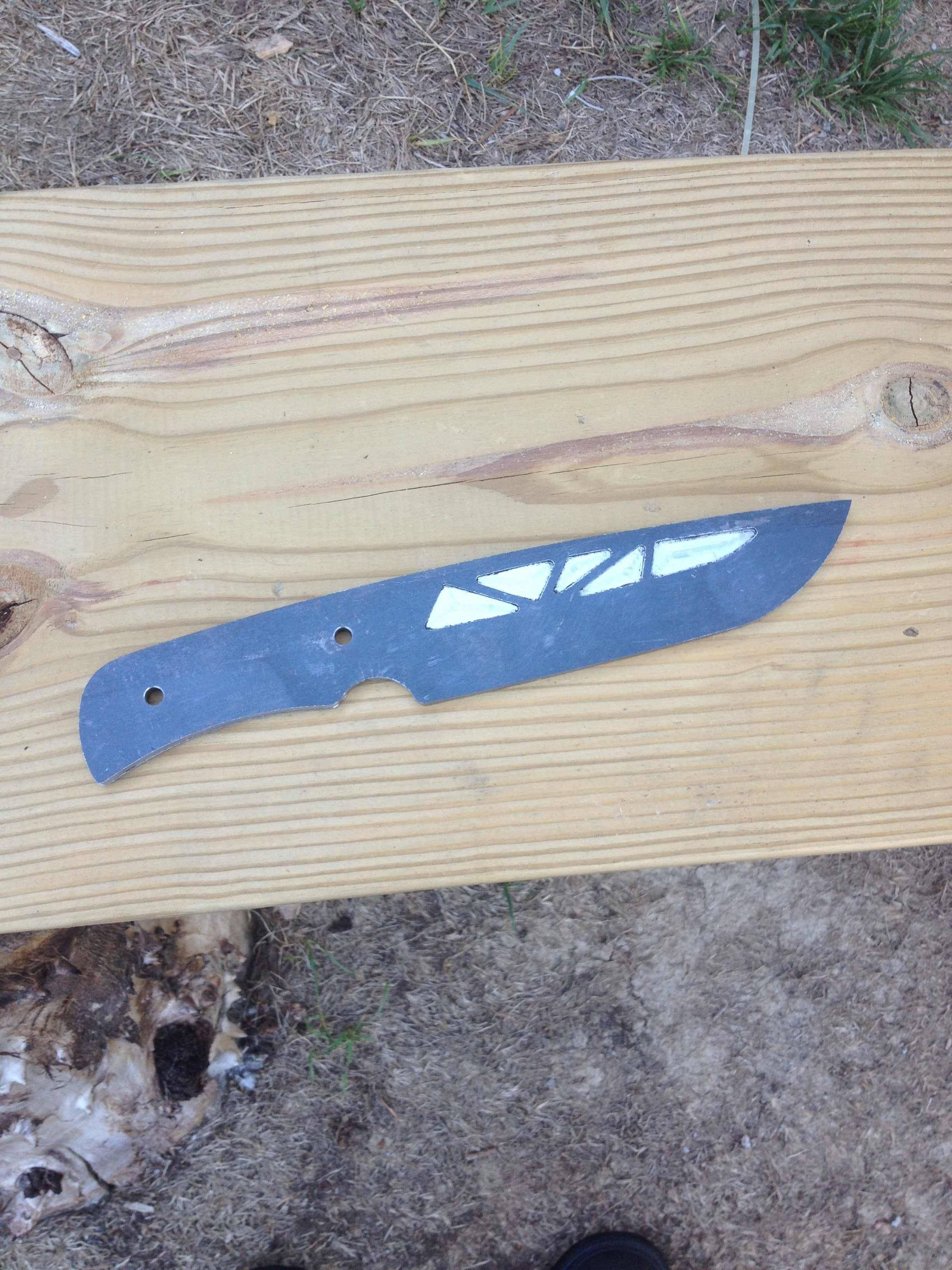

Ok I found a piece of A36 in the scrap pile at work today and decided to do a test run.

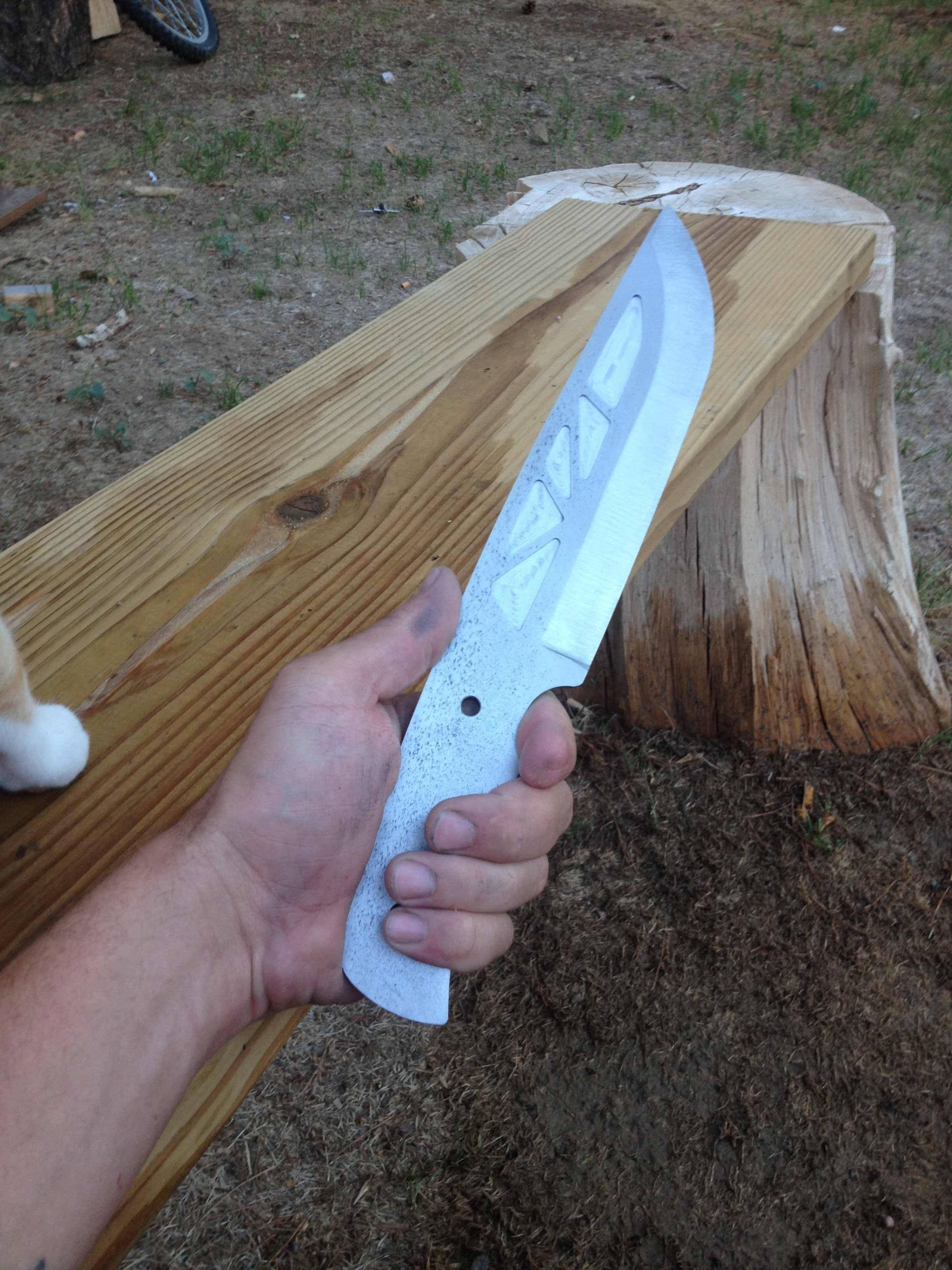

I'm glad I did because I want to change the handle a little bit. It's too wide

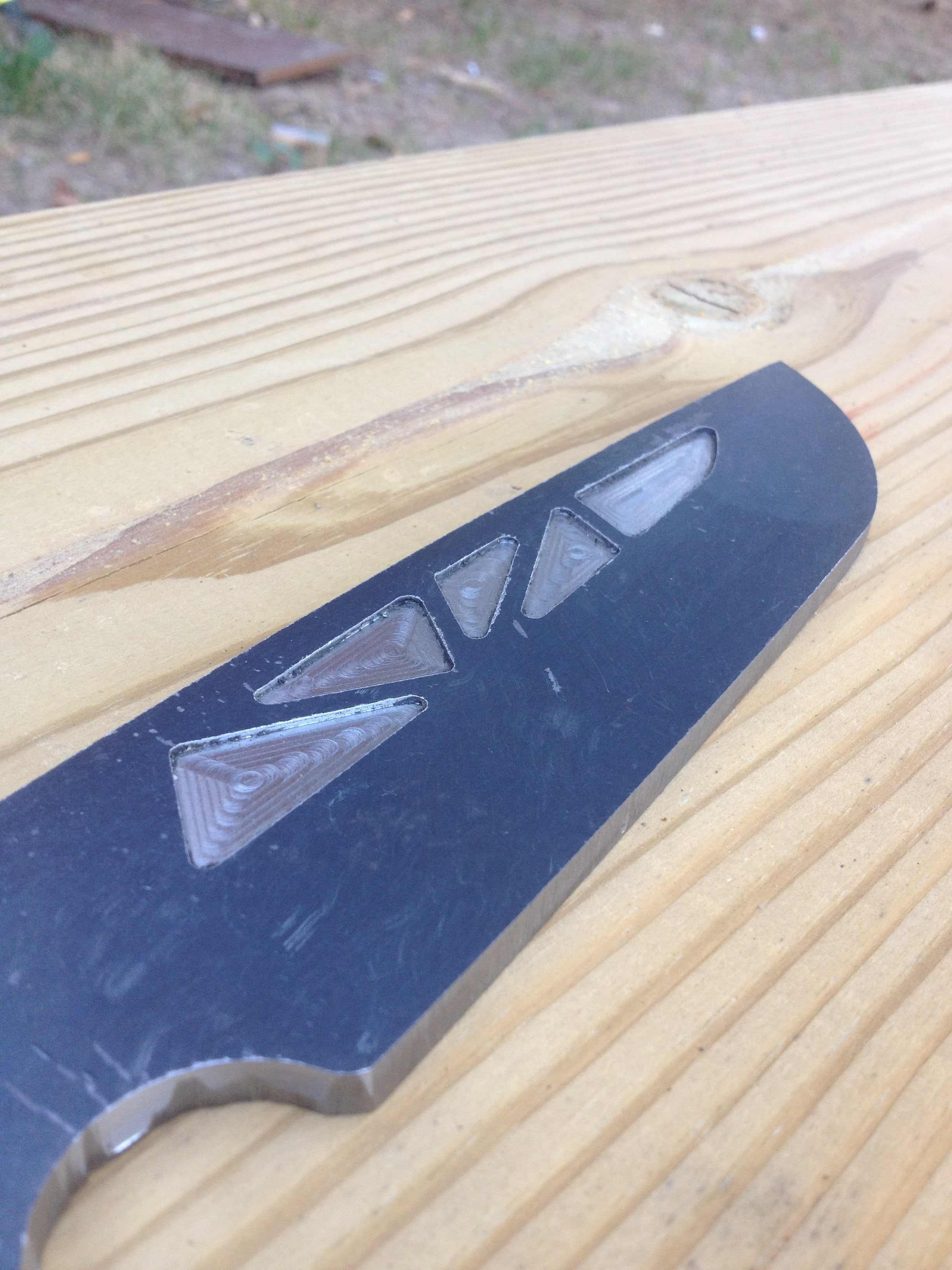

Here it is profiled and pocketed....

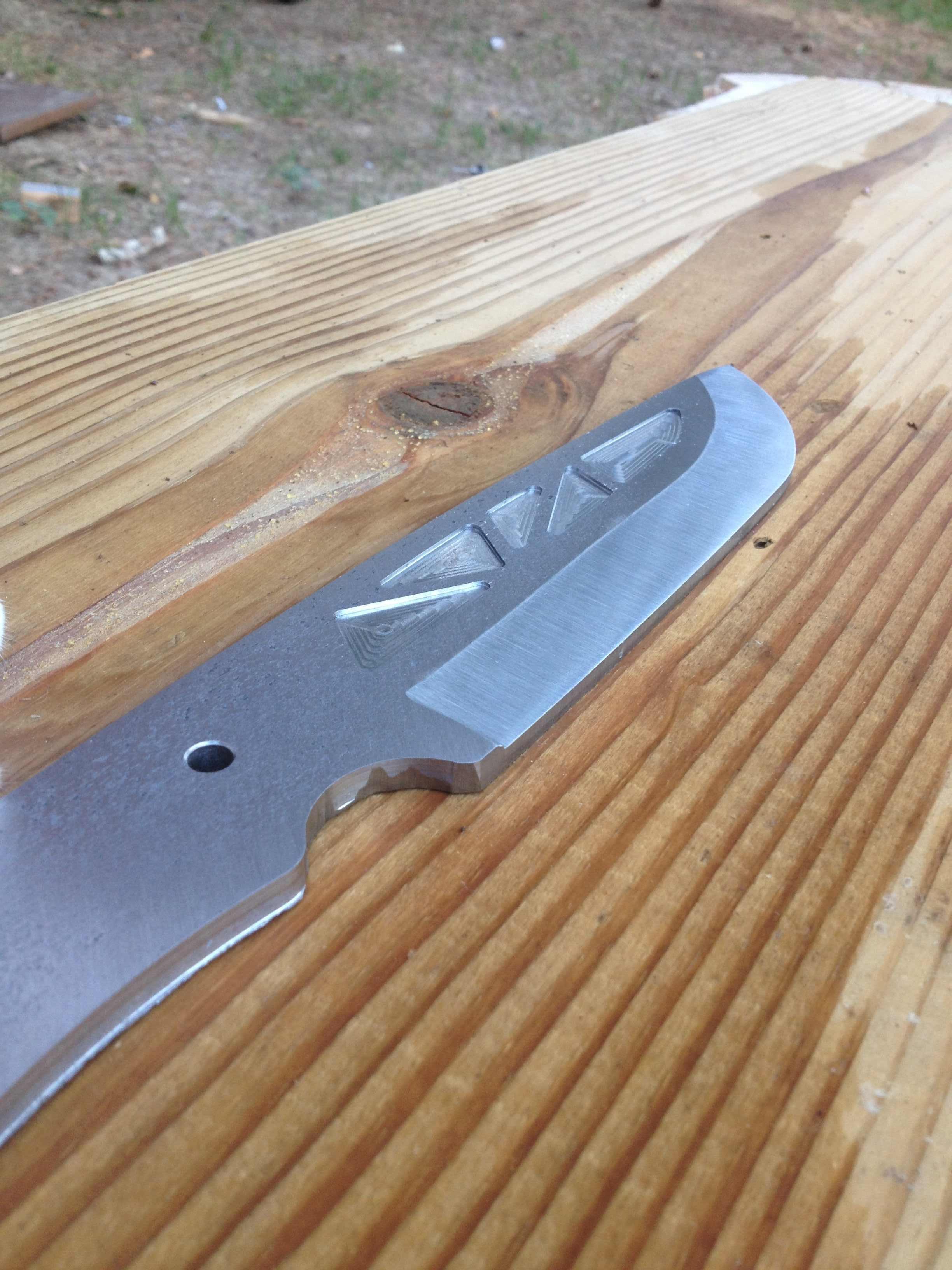

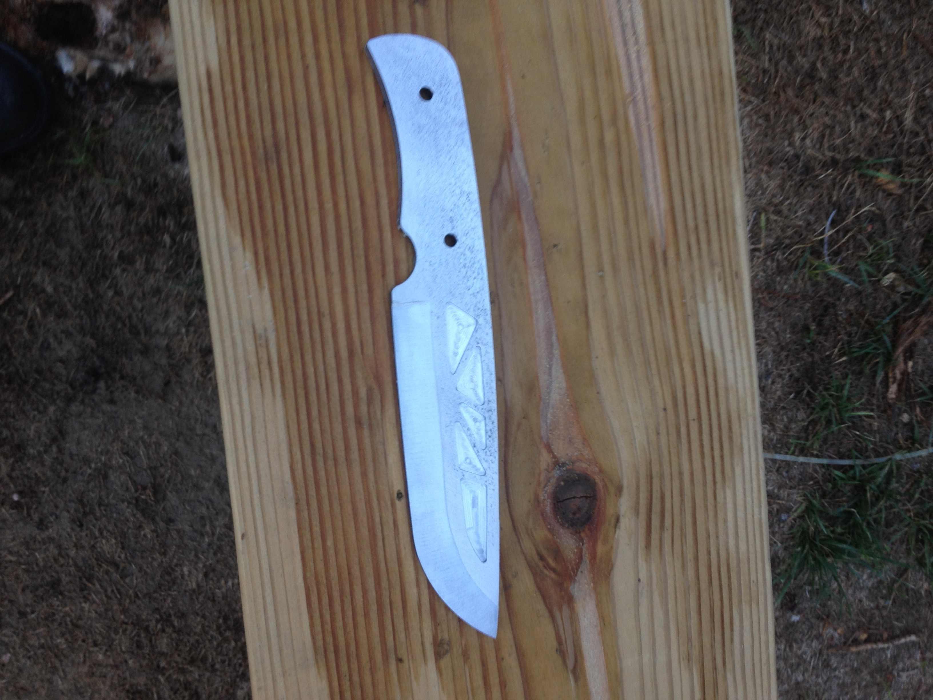

I started to grind on it and clean up the mill scale a little.
Again I'm glad to have a practice piece it's hard to transition smoothly from the flat part to the curved part.
Another close up.
It's pretty huge and yes I still like the pockets if anyone was curious. The only thing that sucks is that this piece is 1/4 thick so not a very good representation of what the finished knife will be. Also I only worked on one side of it.

Get rid of the triangles brother....
If you are doing it for design.... dont
If you doing it to lighten the knife then get some 1/8" stock
But you are on the right track
I'd lose the triangles too.
No point, hard to clean, hard to finish the insides of them, looks like the stuff Frost or United Cutlery sells.
I'd also use thinner stock and do a full flat grind, that will give you lots of weight reduction.

Mockup the full handle thickness's
It looks as if the handle is a good fit to your hands now, but once you have their full thickness, the handle may be too large.
