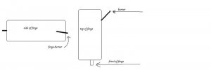

Here is what I have made up to make my heat treating forge. Please excuse my microsoft paint drawings, its the best I could do. Do you guys think it will work? I have the burner placed at one end and the entry at the other end, Or should I put the burner directly under the entry? Im trying to go a good even heat. I thought about dfoggs forge but I need one that will allow me to heat treat bigger blades, Thanks you guys,Charlie

Charlie,
If you need to heat treat longer blades, just get a larger diameter pipe for the Fogg-style furnace.
You have seen my set-up, and although it may not be good for 15-20 inch blades, it sure works fine for what I do.
The key to an upright forge for heat-treat is to have the burner at the bottom coming in at an angle so that the blade is never in direct contact with the burner flame.
Think "LARGE" diameter on the upright forges. Inswool and Satanite is fairly cheap, so it only cost a dime more to go first class.
Robert

Charlie,
That setup won't work very well.
The burner needs to enter the forge from the side. It should enter at the tangent of the liner. It should be abut 4" from the back, and angled about 15-20 degrees forward. The thermocouple is a little more accurate if it is going down the center , but the setup you have will work if the probe is in a thermocouple well ( the tip should;d be at the center of the chamber if possible).

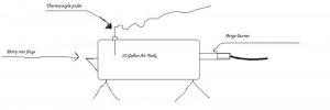

Ok so how would this look, heres another picture off of micro soft paint. I have the forge burner tilted going into the forge, I would also make sure the burner was where the flame would rool into the chamber, Thank you very much Stacy, Man you help me out alot on here and I appreciate it alot,Charlie
You need to do it more like this. you want the burner entering just below the insulation on the top and you want it to go in straight, not tilted up or down. then you want it pointing towards the frount just a bit but not very much. here is a picture. or drawing to say. i will se if i can dig up a picture of my forge.

Charlie I just went back and looked at the pic of your forge. One problem I see is your burner shoots straight into the forge.
Here is a pic of my forge. Ed Caffrey seen a pic of it and helped to redesign the angle of the burner. It is angled up in such and angle that the flame will shoot around the pipe to creat a vortex effect within the forge and help to eliminate hot spots.
Click the pic and it will open to a larger view, but think of it like this. The flame must enter the circle in such a way the it tends to make its own circular motion,(like a marble rolling around and around in a Jar) instead of having to stike a surface and bounce off of it, the 90*angle too the pipe is what creates hot spots! The vortex will help to eliminate the hot spots.
Excuse the crude drawing but this illustrates what I am trying to say. The top pic is how the burner should be aimed to help avoid hot spots not like the one on the bottom.
