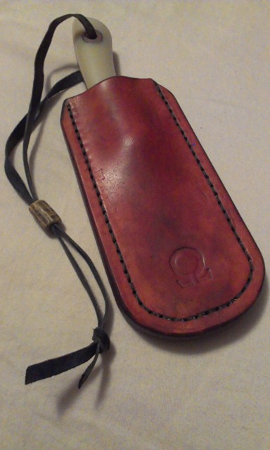

Edges are my final step. After everything else is done I use the big belt sander to get a very smooth and even welt edge. Followed by edge beveling, I apply a bit of gum trag and let dry. Burnish with a nylon bone folder. I don't always dye the edges either. Sometimes it just looks right to me to have the edge natural. Don't over-do the contact cement as that can cause boogers.
I liked how the edge came out on this one.
The sheath is black over red, but the edge is straight red.
This one is super simple but the stitching came out nicely.

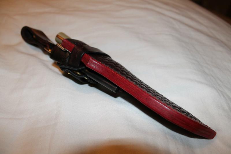

Fine. Here are some pictures. This is before any wet forming or waterproofing. I'll post final pictures later.
Front:
Back:
Side:
With the occupant:
Lookin good!
I'm curious about how that wet forming goes. Now that you mention it, the Eco-Flo water based dyes were the ones I had issue with. I've had Fiebings run too, but not nearly as bad. Localized wetting is a good idea. I had a customer ask about how they should go about a little extra forming and I suggested a little water about the ricasso area. May not get a super defined form, but it's not necessary most of the time, at least on the pouch sheaths that I do.
How many stitches per inch are you doing? Aside from a few examples I've mainly used 5spi but I'm really liking the look of a finer stitch.
The knife deserves a great sheath and it looks like it's getting it. :thumbup:
i4Marc, that sheath is really very nicely done. Excellent design for the knife. My only criticism (if any) would be your choice of snap off belt loop. It's kind of hard for me to trust snap off in hard carry circumstances, and that's a fairly large knife.
If I were grading, you'd get and A for that one.

I'm not sure exactly how many s.p.i. but going by the photo it looks like 6 per inch. I like the finer spacing but it is more work. In the case of this particular sheath I chose this spacing because the spacing fell perfectly for the various lengths of stitch groove around the sheath.
Paul,
Thank you very much. I respect your work and your kind remarks are really encouraging. I've gotten many great tips from your advanced sheath video. The reason I went with the snaps is because the gentleman I made this knife for wanted a sheath with a way to get it on and off when getting in and out of his car without undoing his belt. I did consider putting in a Sam Brown stud but I don't have a way to make one yet. I don't like the commercially available ones. I went with the three snaps for design but also to make sure there will be enough snap to do the job. The person getting this rig will definitely be using it in the woods and I don't want it to come off unless he wants it to. This is only the sixth knife I've made and the fifth sheath I've made so far so I still have a lot to learn. Each sheath before has been a different design so it seems that each sheath I make is a unique learning experience. But I will take the lessons I learn from this one and apply them to the ones that follow.
There was some discussion recently about snaps and effort for using them. Apparently Tandy snaps take less effort to operate than the other brand (the other brand name escapes me). That may be something to look into if you'll be doing this again. I've only used the Tandy line 20 and 24 snaps and haven't had any problems, but I haven't used them for an application like yours.
When I first started making dangler straps I thought about using a couple of L24's but got talked out of it and now only use Chicago screws. I can't imagine your design failing. I can only imagine that the force required to unsnap three L24's (especially if those were shearing forces) would alert the owner that something significant is happening.
