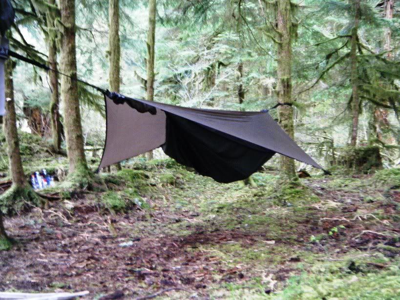

Here's a shot of my Expedition Asym. Just picked it up last April and went on a 2 days outing with it in the Cascades (WA). Slept like a baby...of course, the 20 miles hike helped a bit :D
Already replaced the polypro suspension on mine with Amsteel Blue whoopie slings...gonna test that today, actually :thumbup: My current setup (hammock, oversize silnylon tarp, tree straps, 23gr carabiners, whoopie slongs, snakeskins) weigh 43 oz. Not "ultra-light" by any means, but a huge load improvement for me, who used to hike with a bulky tent :cool:

Hey defaultuser, could you get a better picture of your whoopie slings? I'm actually using the larger Figure-9 tension device for my son's Scout hammock...makes set up very easy for him and these hold is weight easily. I've also upgraded my Speer and Blackbird to use use cinch buckles and webbing to make set up easier.

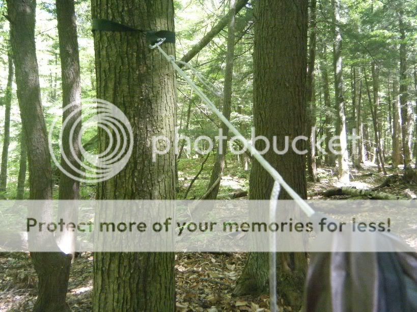

Just back from the woods; still covered with DEET :D Sorry for the delay, I actually felt asleep in my hammock :eek:
I'm happy to report that the whoopie slings are working like a charm! Easy to setup, VERY quick too. This is a very "elegant" no-knot lightweight solution to hammock suspension. Totally worth the switch in my book.
The "nacrabiner" worked well too; weigh next to nothing, easy and fast to use.
Another experiment was the Hedden sliding friction knot on the whoopie to tie the tarp. Worked perfectly.
Sorry for the bad pics, but here they are. Feel free to email me/post any question.
Whole setup packed; as I said, everything is exactly 43oz:
Tree huggers, 23gr carabiners, and my prototype "nacrabiner" (essentially a cord loop tied by a diamond knot, sliced into itself neat the mid point).
Tree hugger setup (with a carabiner):
Whoopie sling "permanently" attached to the hammock (spliced locked loop):
The buried part of the whoopie sling:
The whole suspension, head side. The small cord on the whoopie is a Hedden knot for the tarp suspension:

Later I tested the nacrabiner to join the whoopie sling to the tree strap. I didn't fell on the ground so...success!

Excellent pictures defaultuser!!! Thanks for taking the time to snap some good pictures of your set up. Wow, there are more ways to set up a hammock than a I thought!!! I'll have to look into woopie-slings. I'm using the same type of carabiner with my multi-looped tree straps. Great looking set up:thumbup:
