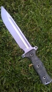

Here goes!
Looks great. Couple questions. Wouldn't the blast cabinet treatment take the painted finish off without using any other method?
Also, did you blast the Micarta at all. I have seen that treatment give the Micarta a cool look.
Thanks

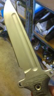

Thanks. You can't tell it by the above photo but the etched lettering survived the bead blasting and the edges actually look sharpeand cleaner than before. Now I need to think up a good way to blacken the letters.
nail polish around the logo, then blue it or etch with vinegar.
Thanks
Yeah, the bead blaster could have taken it down all by itself but since this was the first time I've done it I wasn't sure how harsh it would be to the logo or the scales. I wanted to get the steel clean first so I could see how deep the logo etched and then give it a quick frosted finish without worrying so much about messing anything up.
Yep, blasted the whole knife, micarta and all. I did have one spot where a stubborn piece of epoxy took a little extra effort with the blaster and it discolored a small part of the micarta. It actually looked like it was slightly burnt. Kind of a reddish brown color. I put it back in the cabinet and hit the area lightly until it was gone. Looked like New again.

Thanks for the info. Makes sense. When you don't know the outcome, control the process, each process individually. Would you mind a straight on side photo of the grip panel, so I could see what the beads did to the Micarta? What did it change about the grip? Just the texture?
A glass beaded version of the Micarta TGLB seems like exactly what I am looking for! Also, how badly did the blast process dull the blade?

Inspector, the small amount of blasting that I did to the grips didn't make any visible change to them. I wasn't sure how it was going to react, and I didn't want to fray the canvas so I just hit them quickly. I can feel a difference but to me, they look exactly the same.
The glass beading dulled the crap out of the blade, and I was even being carefull to blast in the same direction as the edge and not towards it. It doesn't matter how hard the steel in your knife is......glass is harder. Lol! If you ever do one, don't bother being careful around the edge because you're going to be spending some time on the stones anyway.

Very cool!!! Got any bigger pics?
I'm doing all the pics with my phone and just learned how to post them. I don't know how to make them bigger but I could try getting a better shot with the whole knife in frame.

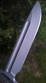

Yes, there are still tool marks and dimples but I think the bead blasted finish does a good job of subduing them. It looks clean while still having some character. For some reason when I take a picture it has excellent resolution until I upload them to photobucket, them I loose all definition of the fine tool marks. You may be able to see them here on the hollow grind area.

I believe they are just regular ol' gerneral purpose beads. Not new though. I'd been using the beads on a few other projects last week so they are pretty fine by now.
