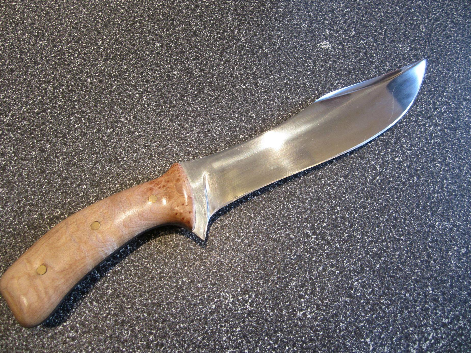

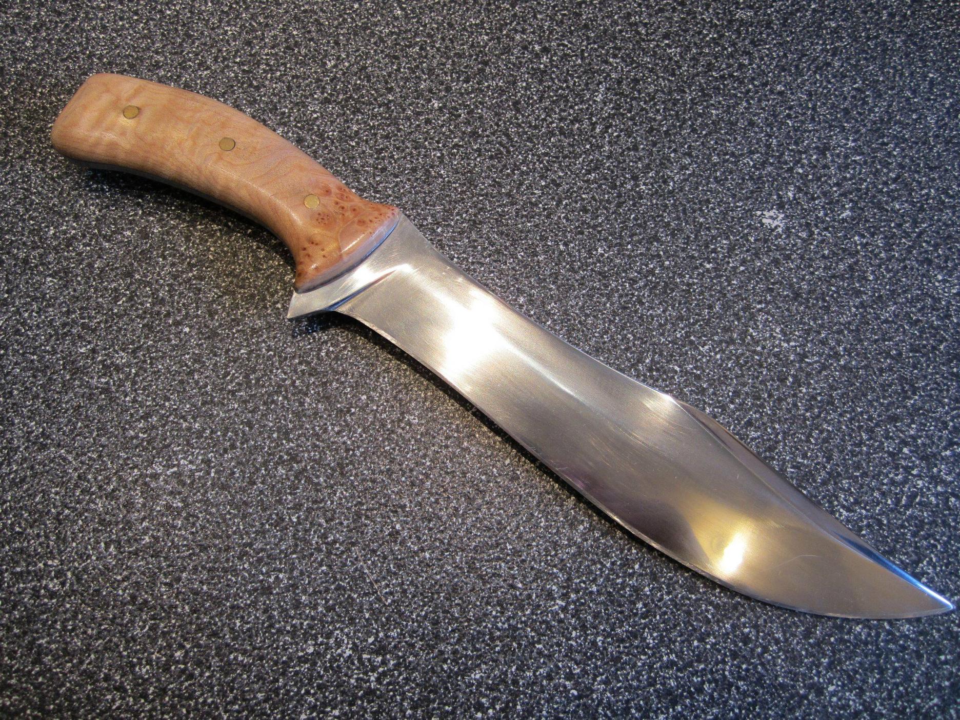

yeah, if you check the thread i've already heat treated, hopefully it did the trick! but im thinking the knife will likely end up more decorative than anything, unfortunately. nicest looking knife i have made, but might just be the worst user if the steel is not that great. ill be testing it out on some logs though. the whole blade was heated past magnetic, and then fully qenched, them tempered at around 450-460 F, for two cycles of one hour. so hopefully its decent, i guess that depends on my mystery steel.
here is the current product. still got a bit of handle sanding to go, then varnishing. then i will be putting a 20deg edge on it. the pictures dont really do the finish any justice, just done with a cellphone and a reading lamp

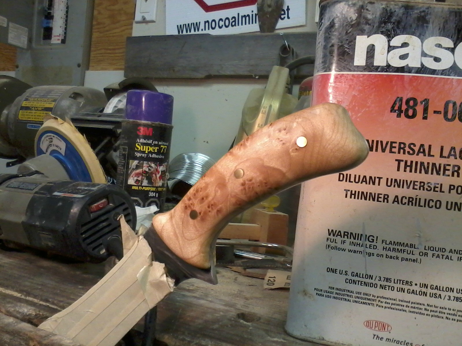

i havent done that much work with wood finishing, what would be the advantages of a tung oil finish, over varnishing?

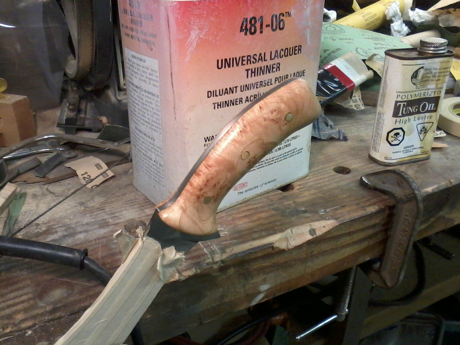

well, i went with tung oil.
sanded up to 400 grit, cleaned off, and applied first coat, thinned a bit with lacquer thinner, rubbed off excess.
Good job, main advantage of tung oil, is that it soaks into the wood, takes multiple coats to build up a finish, but the first couple coats gets into the grain of the wood where most varnishes just sit on the surface. Also it's easy to add more as use and time dictate.

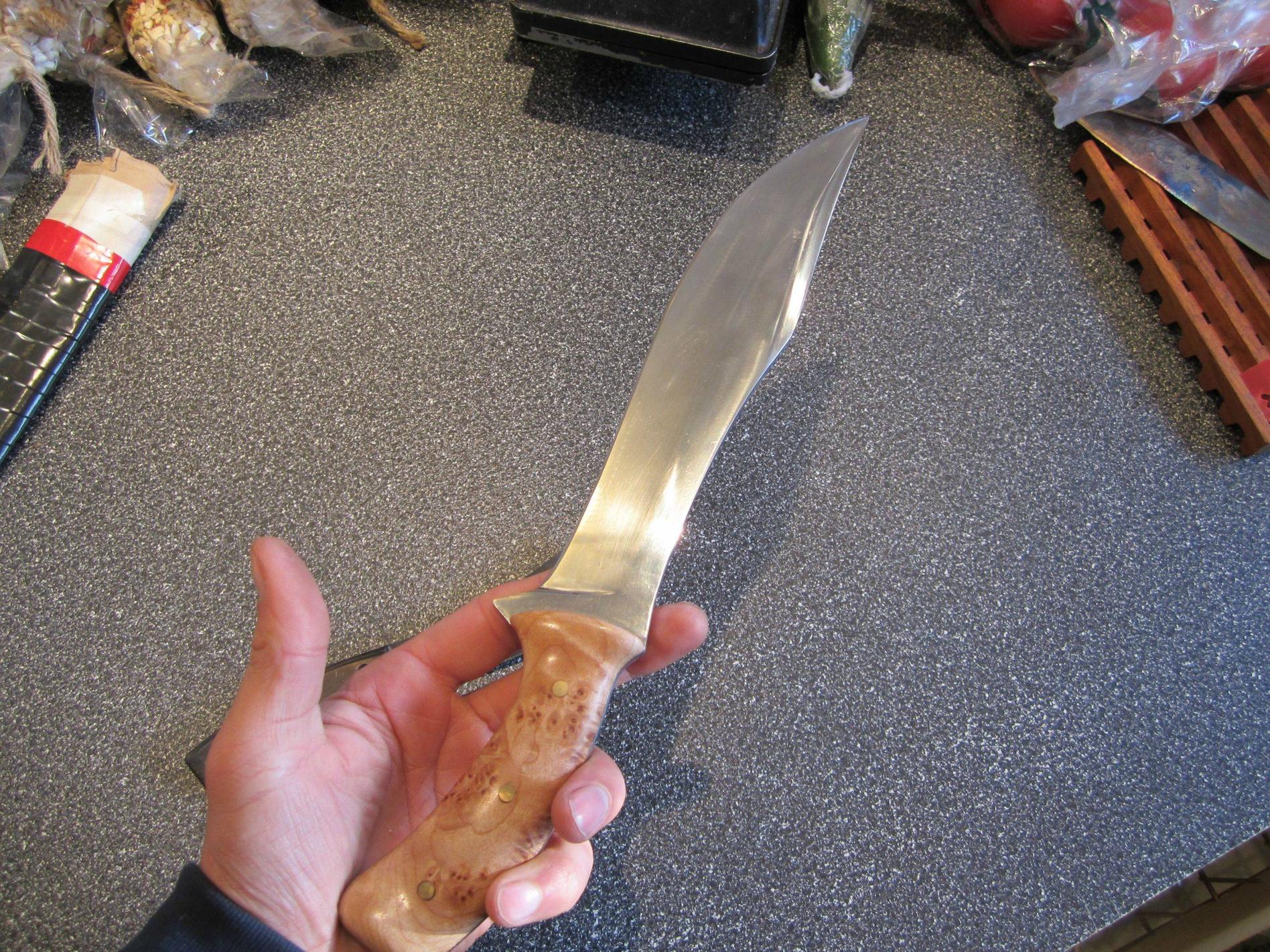

"New to knifemaking"...ME TOO! I like the curves and overall design of your knives. The last one in this series is particularly graceful. Well done. Keep up the good work
thanks very much! ill be uploading some more photos of the finishing stages, etc and the final product/eventual outdoors testing over the next week.
once its had its beauty shots, and shown to friends and family, its new edge is gonna be tried out :D
How do you like the tung oil so far? I find it brings out the wood some and still had a very natural feel. Plus after a few coats you can buff and shine it up. I use a little carnuba wax after 2-3 coats of tung myself
so far it looks beautiful! really easy to apply as well. makes it look nice and wet. im thinking of doing 4 coats or so, how many do you generally do? and how does the carnuba wax turn out?
I agree with Steve that it is most likely not O-1 or 1075. 9260 would be a good guess, but any guess is not a fact....just a guess. 92XX steels will HT like you did, but the whole process lacks any control.
There is a lot of info in the stickys on HT of steels - Kevin's "Working with three steel types" is a good one.
That said, the knife is an excellent job.

I use a 50:50 mix of Beeswax and Carnauba wax, because the Carnauba is really hard on its own and you need to get a lot of heat (friction) into it before it'll spread evenly. The beeswax blend helps it spread a bit easier and smoother. One thing i do notice with the mixture is the wax gives a good gloss without losing grip. Many of the other gloss treatments end up too slippery to be a user.
EDIT: I'm talking pure wax here not those creams or blends.
After 3-4 coats and wax I give it a light buff and its glossy. You can do less or more coats and wax or no wax. Just depends on the look you want.

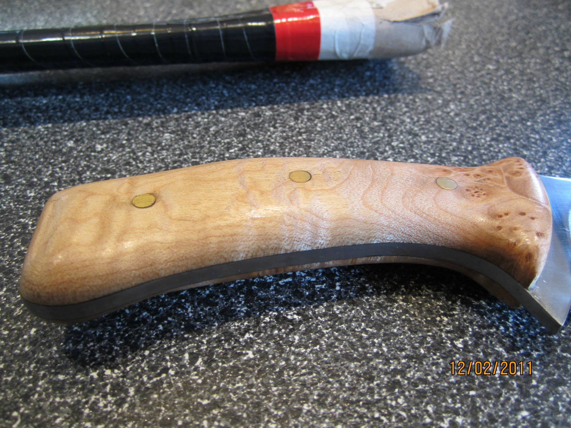

wow, i guess i forgot to post updated pictures!
it has a buff mark that i wanna fix up, but here it is with the finished handle :D
and you can see my crappy make do sheathe behind it. need to get learning how to do leather work!
