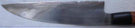

I have an un-reasonable expectation, perhaps you guy can help judge & tell & maybe medicate me ;)
Recently I made a 21cm W2 kitchen knife @ 65+rc (tested at 67rc - guy, yes it's true, since fatalistically I only tempered this knife at 300F). almost zero grind w/ behind edge thick around 0.005". 7-10 dps white compound stropped edge.
What do you think, if I put it through this test (will video it):

OK, after a quick fluff off any dangle bits on the edge using a carbide scrapper or spine of another knife. I want/expect it smooth slices newsprint at 45 degrees and perform tomato slicing. Am I wishful thinking.
Well - your thoughts & predictions?
I'm not a steel maven, but does W2 chip easily? I love the very thin blade profile, but I'm concerned that at such high hardness it will chip.
Almost all steels are brittle at 64+rc couple with thin geometry, usually big nasty chips. Says, if S7 can harden to 66rc and 0.01" behind edge and 10dps, it would chip since its renown toughness won't extend at upper hardness limit. W2/W1/1075/1095/52100/3v/elmax/etc.. won't support this test. unless - hahha if I pull off this stun. I would obligate to pass this knife around - with hardness testing allow to verify. My 52100 probably will pass this test at 65rc but not harder. Test steps 4 & 5 put a lot micro incidental lateral force on the edge.
I am just a bit of stir-crazy from too busy working on cloud ERP app. Here is the test candidate, balanced on a pencil. Pic at an angle to show hamon.

That's 1/8 of a mm of edge thickness before sharpening - your BS will give a bit of a convex to it - hmm, that's gonna be interesting. I would expect chipping during step 5 since highest risk of lateral movements.

This afternoon while on break, at my desk - I tried to make a thin slice through a 5/8" poplar rod/dowel like a stiff carrot. *bad news* with strong arm and put lean body into it. half way through, the edge exited the rod, the downward pointing tip slammed into oak desk, twisted the blade, then the back end slanted edge laterally hit a 90* angle edge of a hardwood backing with a whole lot of pressure. Edge (2" from heel) suffered a 1/3" vertical crack. *good news* blade didn't split in half; didn't scare nor hurt me; now I can do hard tests w/o worry and good excuse for me to finish up its backup twin (except it's 24.5cm instead of 21cm) W2 gyuto and lastly I can try different woods for handle.
I can't find 1/2" pine rod, so I bought 7/16" poplar rod instead. reasonable substitute since poplar is a little bit harder than pine. I plan to press edge down into rod & roll-the-rod to make 10 cut cross grain. Let me know if you guy know a better way.
Pork rib bone is quite hard, so cutting paracord on it almost like cutting on granite. Exactly, I use BS (Balanced Strop) to refine and add a micro convex bevel to the edge. I guess I wanted to know what a thin & sharp & max rc edge can withstand and damage sustaining. I expect this knife still be serviceable in the kitchen after this test set. but if If I chop this edge through the bone, probably will get 2-3mm chips... bye bye knife.

I am pleased with the result. Thanks for watching & comments.
Thanks for sharing bluntcut.
So the conclusion is then either drop down the rc to 60-61 and/or change the apex angle with a bit more substance behind the edge. The advantage of a thin kitchen knife is obvious so maybe the first?
