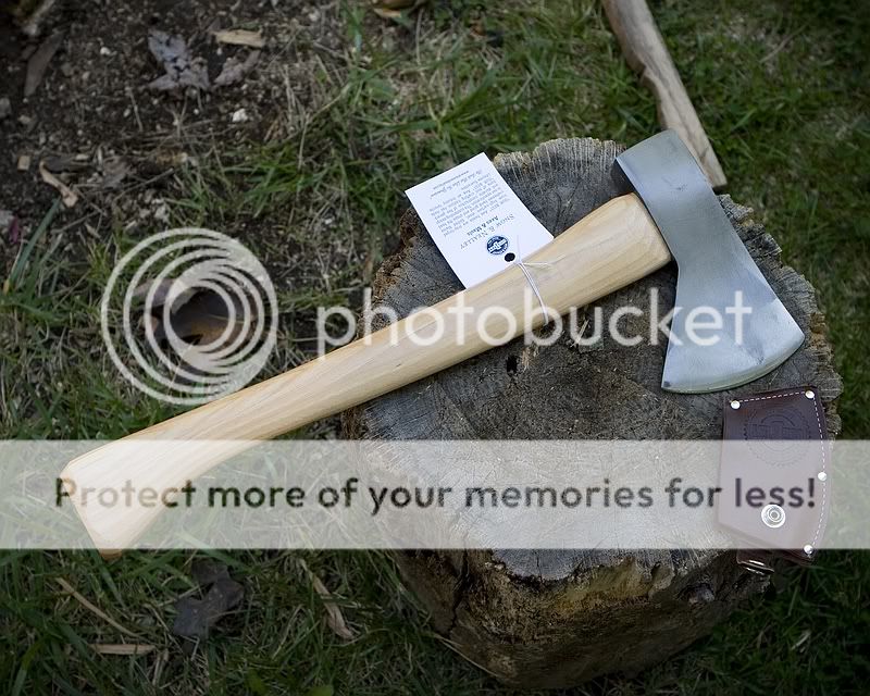

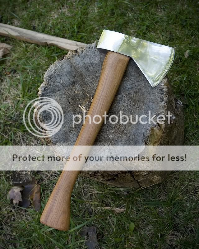

Here is what I have come up with. A modified Snow and Nealley 19" axe.

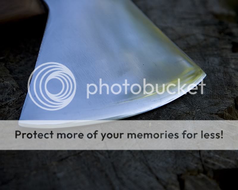

Step number 1: For bucking wood (cross grain) cutting like a knife an a lot of cutting ability, a nice sharp convex edge is a must.
Most people with a belt sander, or patience to do this by hand can set that up easy enough.
Another not so difficult one is taking care of the handle.
My axe started off like this:

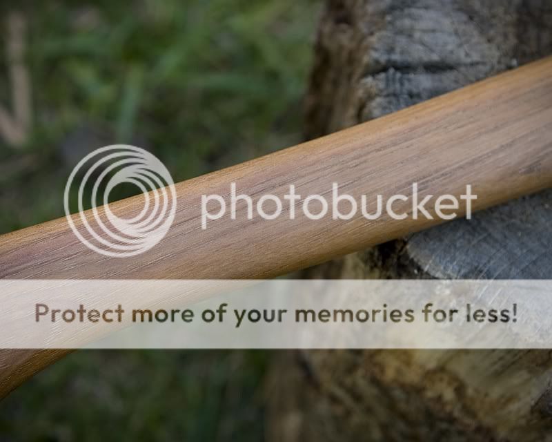

I sanded the handle down extremely SMOOTH. I then did multiple coats of linseed oil, followed by a beeswax treatment. It is nice to hold.

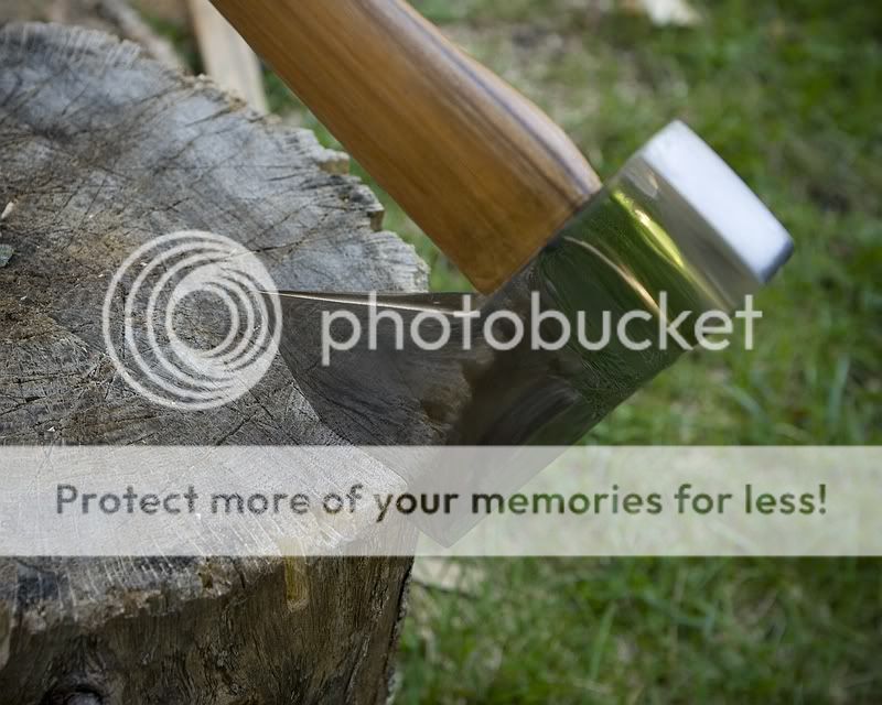

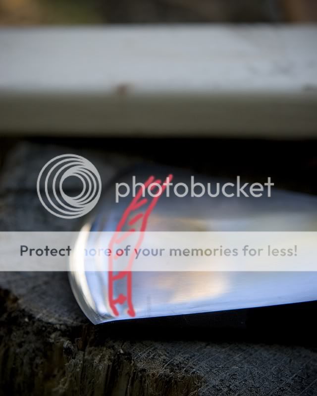

Now, on to the performance after you get beyond the first inch or so of the edge. Now we will look at making the axe penetrate wood.

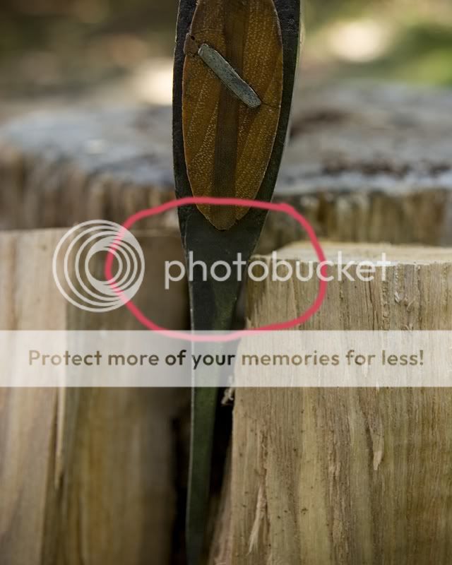

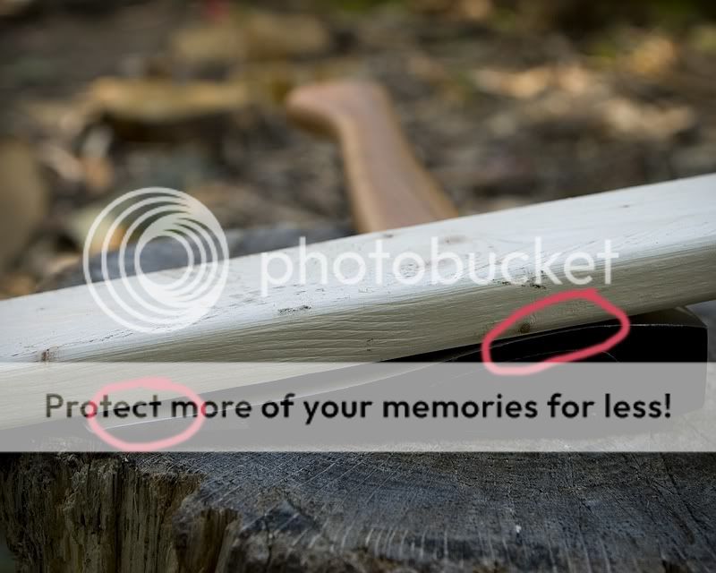

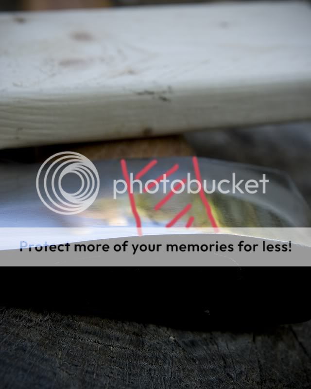

When you lay a flat piece of wood against the head, you can see the two contact areas of concern.
To be continued......
