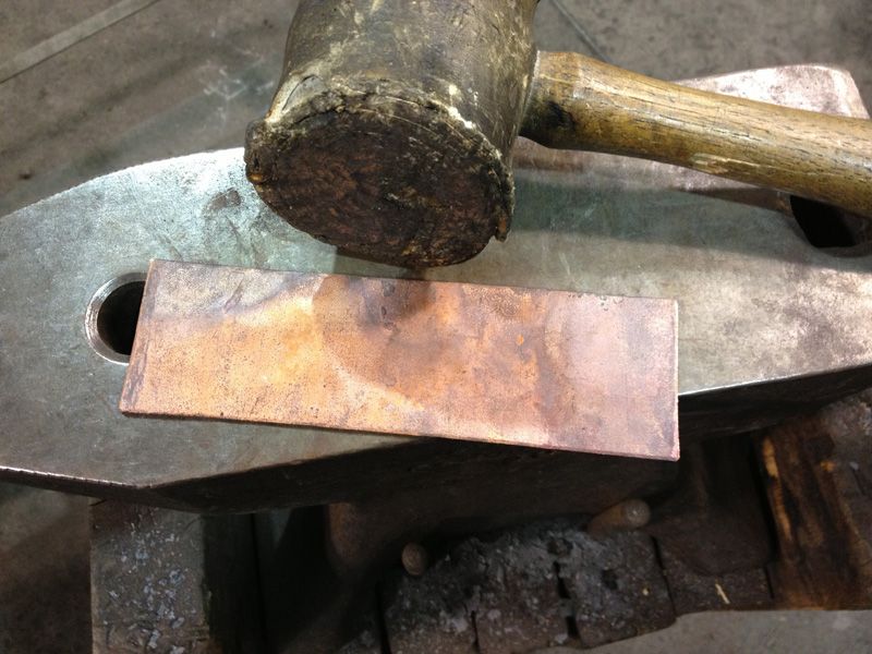

Open and flatten (I use a rawhide mallet, and the copper doesn't need to be super flat when you're done).
Flattened and wire brushed. This is the texture hammer I'm going to use on this particular handle.
Textured.
Cut to a little over length.

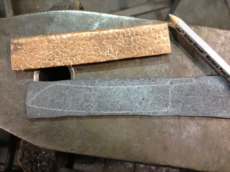

I'm using some twist damascus I had forged out.
I forged it out to just under an 1/8" (so that it fits in the channel of the handle)
and textured it lightly with a different texturing hammer.

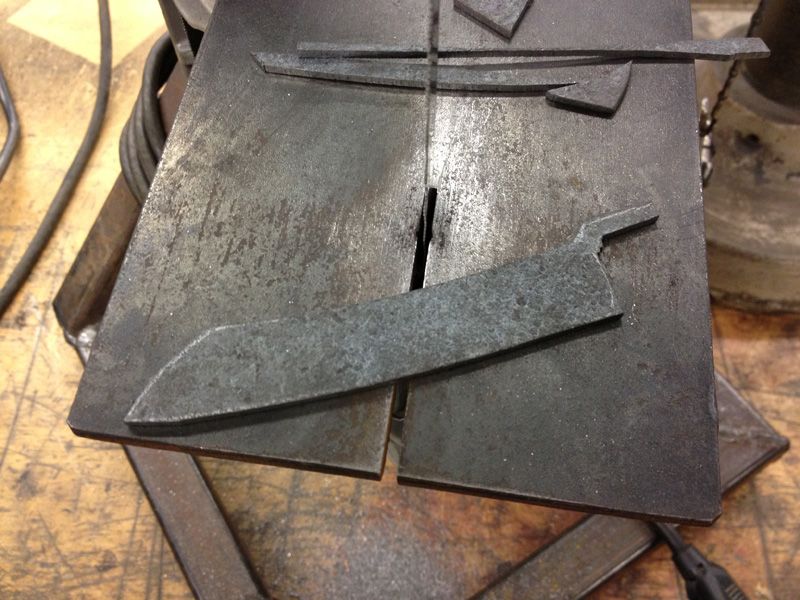

Draw the blade you want. This can take some trial and error, but I'm using a pattern that I've worked before.
Cut out the blade.
Blade is profiled and the handle is drawn on my copper.
I cut off the channel in the back where the pivot area goes and the flicker (or whatever it's called) butts up against when open.

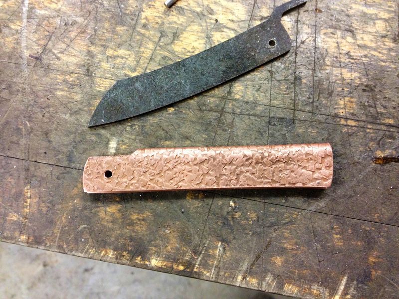

Center punch for the pivot hole. I put a sacrificial piece of 1/8" plate in the channel to keep it from collapsing.
I use the same sacrificial plate when drilling. I just drill through one side of the copper at this point.

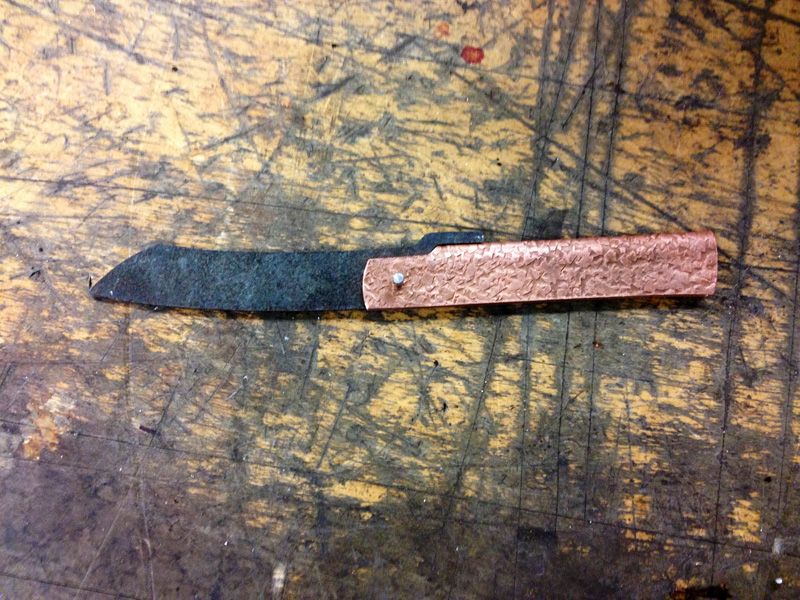

I'm using 1/8" stainless pins for the pivot.
Once I drill through one side of the copper I put the blade in where I want it in the open position and clamp it together.
I drill through the hole in the copper and just touch off on the blade so I have a reference point.
I take the blade out of the handle and drill it separately on a flat surface.
Then I drill through the first hole in the handle all the way through.

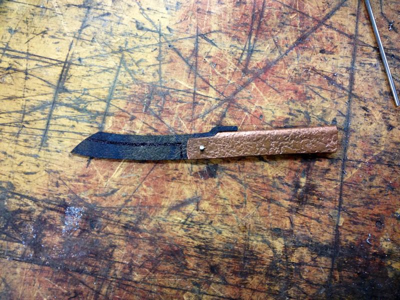

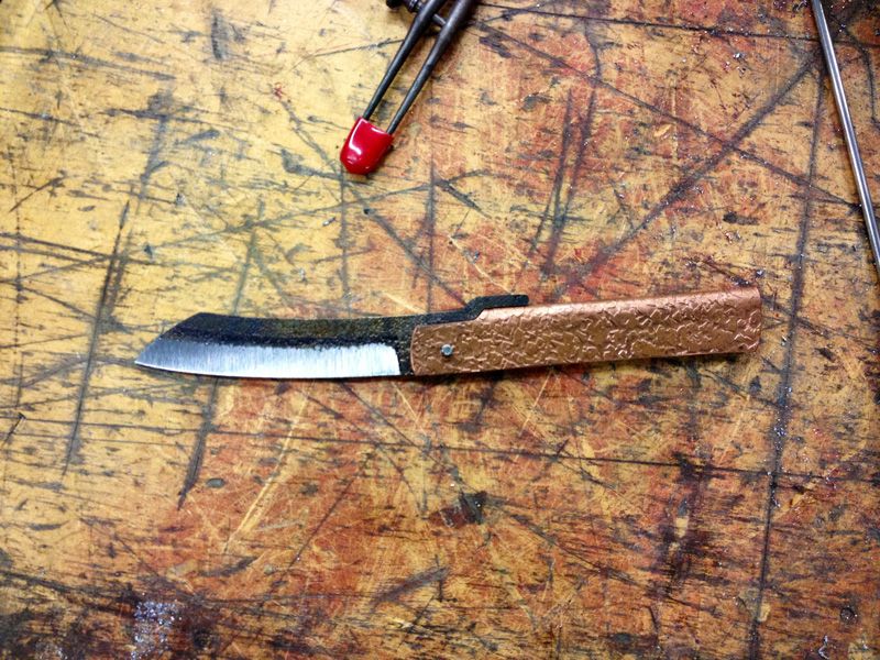

Put your pin stock in and check your pivot.
This is as far as I've gotten with this one. Hopefully in the next little bit I can get the knife done, and then I'll finish this thread.
